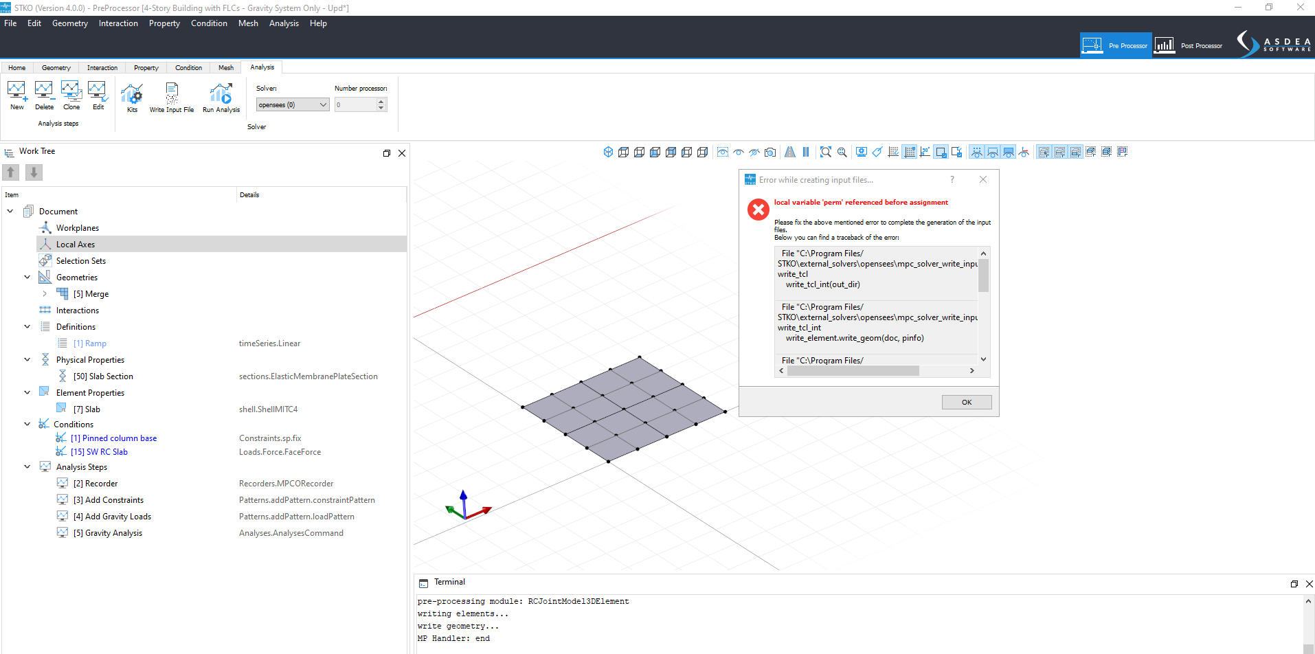

I'm getting the same error, and I'm sure I'm using 4-node faces. Could you help me to solve it, please?
Thanks!
Franco

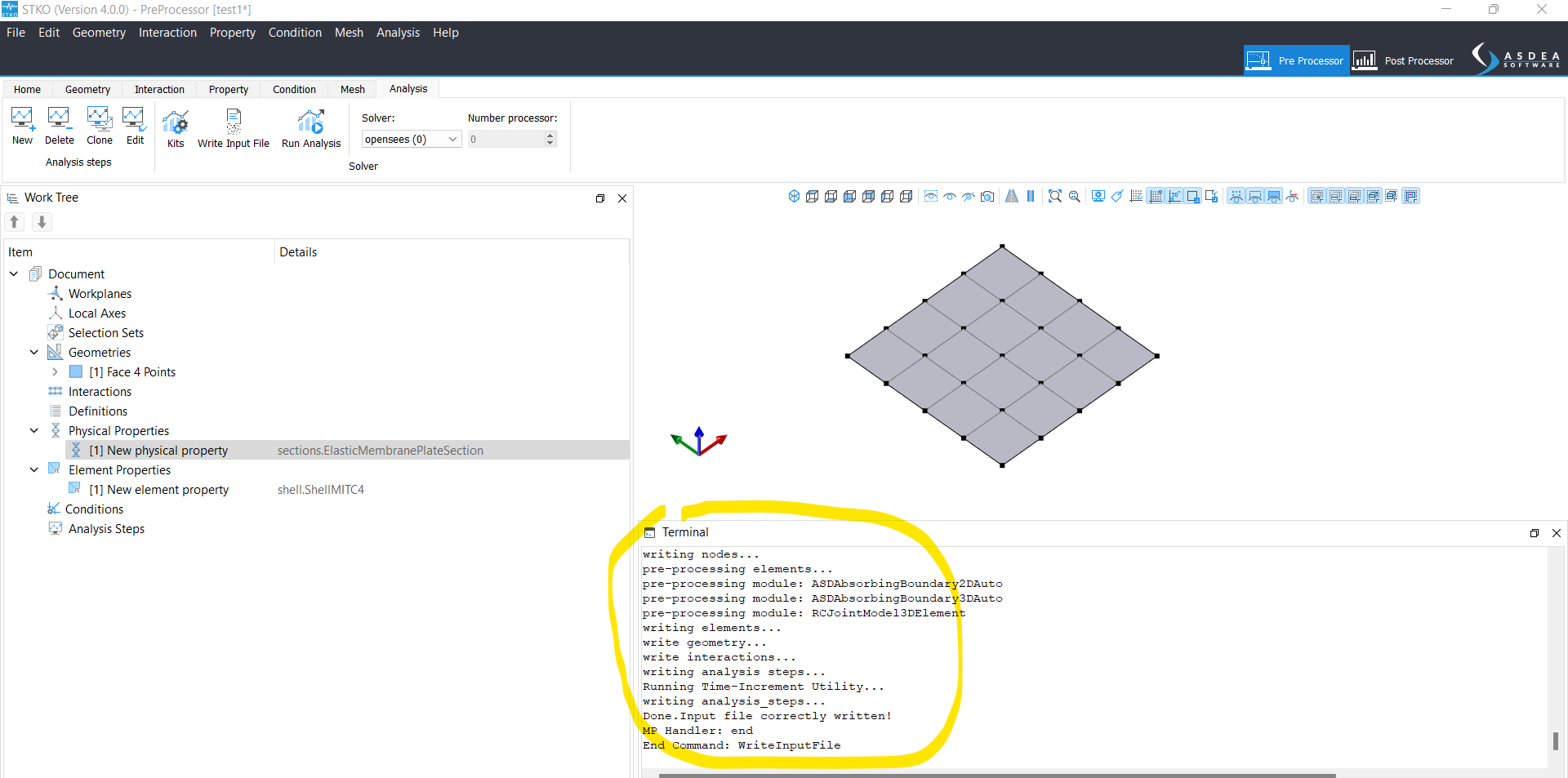

Hi, I used the same element and section as you did, but I didn't receieve such error. Input files were correctly written as you can see in the attached picture. It may be due to other reasons, please check the last sentence of the error message and the python files associated with the error.
