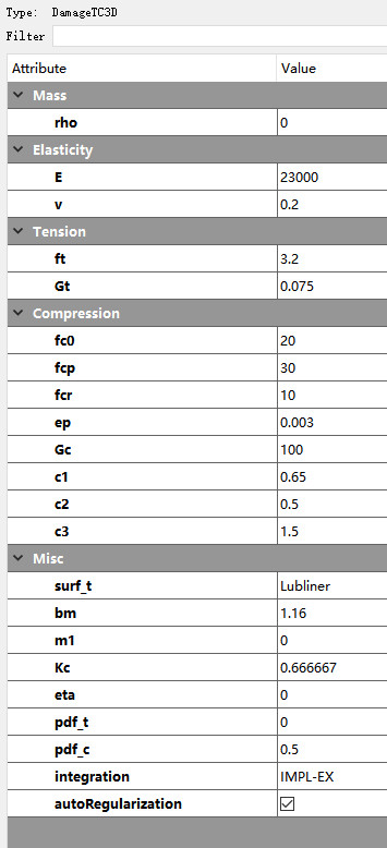

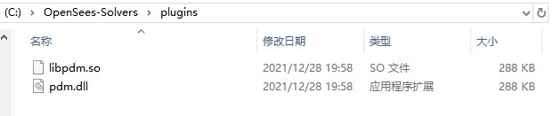

Thank you for your reply. But there are errors for the property.
If shoul I change the Plugin Library "pdm" in Opensees install file?

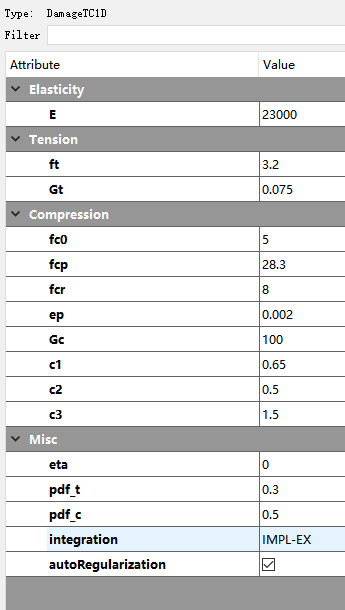

The concrete 1D property and 3D property were designed as
and
, but the error is as

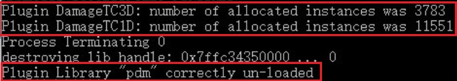

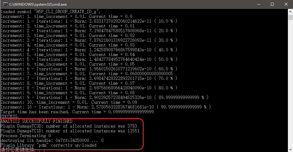

At the same time, there are other running errors
, I don't know how to solve it.
Look forward to your reply.
and
.At the same time, there are other running errors
, I don't know how to solve it.Look forward to your reply.

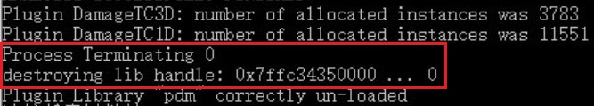

Re: DamageTC3D in RC shear wall
Don't worry, those are not errors!
They are just messages to make sure that the plugin library (pdm) is correctly un-loaded (destroying library handle) and to count the number of materials used in the model.

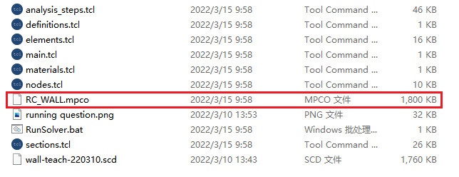

Okay. However, the program stopped running. What should I do to finish the grogram and get the results?
The program did not stop running with an error. It's just finished correctly (ANALYSIS SUCCESFULLY FINISHED is a message that says that the analysis is done.)
Now, in that folder you should find a file with the *.MPCO extension. (if you used the MPCO Recorder command).
In the STKO post processor you simply need to load that file (Load DataBase command)

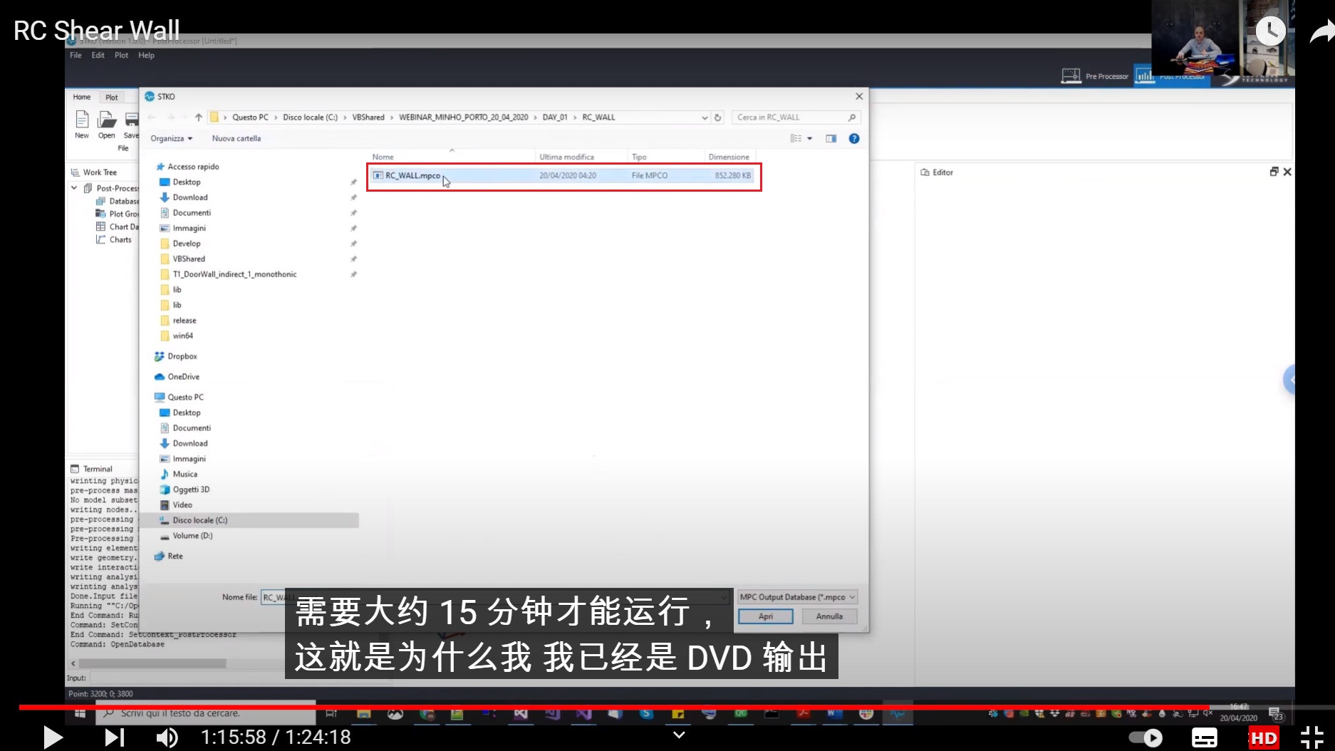

Sorry, maybe I'm not being clear. I do not get the results. Because, after I submit the model file, the progress ran a few senconds and then teminited. And the .mpco file is only 1.75 MB
, which is far samller than the size of .mpco file on the teaching vedio
I thinck that there is some wrong. Could you try to run the .scd file named by "wall-teach-220316" in the attachment? And you can find where the wrong is. Thank you.

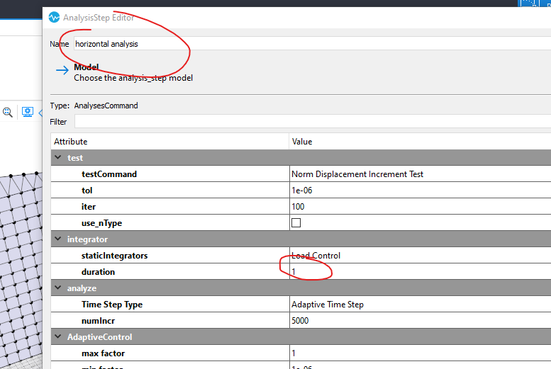

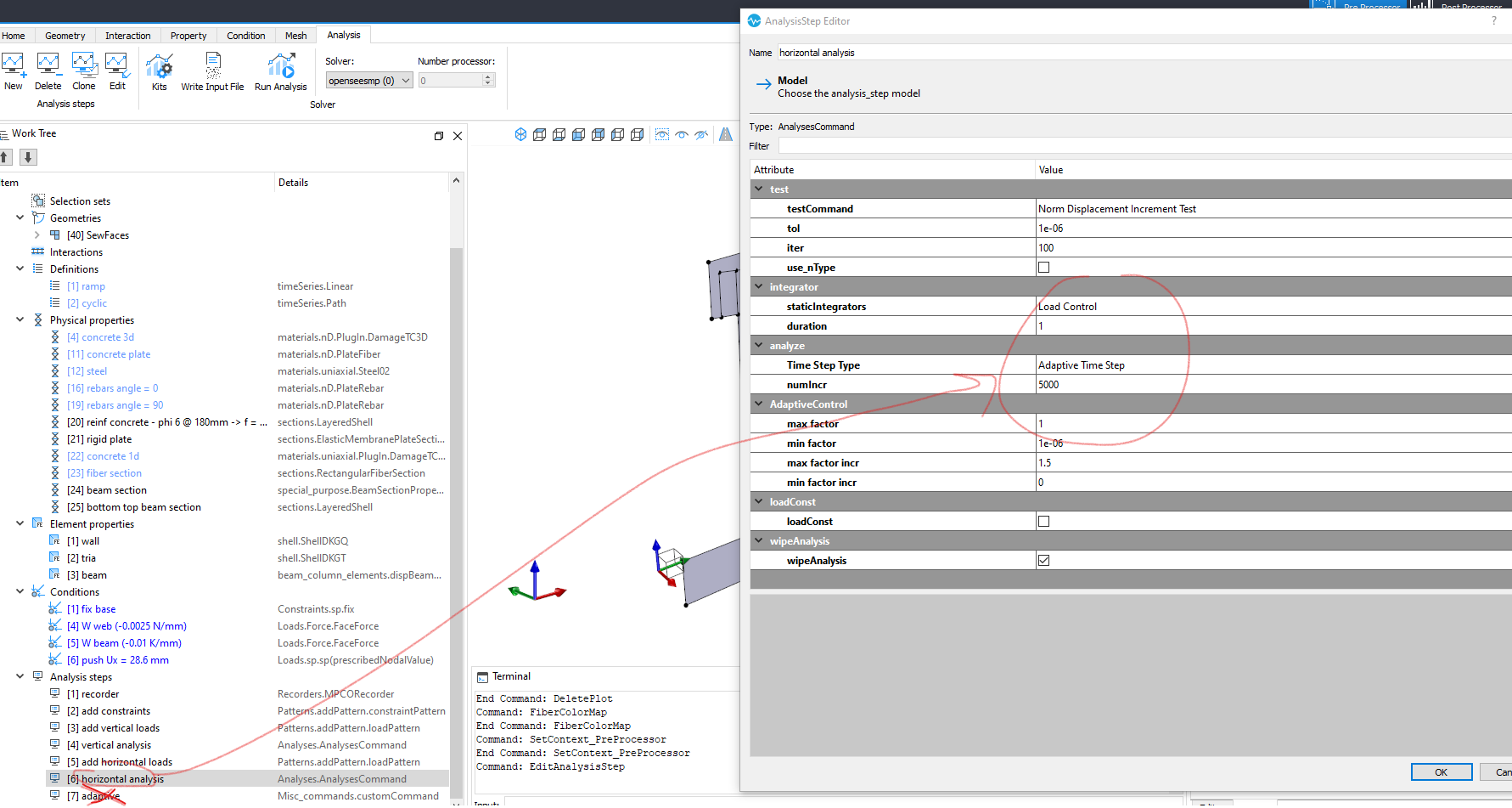

It's because in the horizontal analysis you set a duration = 0.
In this way, it was skipped.
Put 1 instead.
Put 1 instead.
Thank you. The model is successful.
