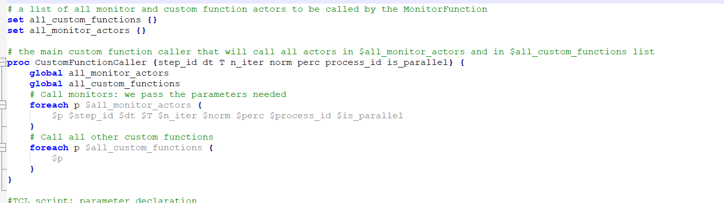

It's because you were running the analysis using a custom Tcl script that was compliant with the old STKO version.
However, now it should be sufficient to replace this line in your last analysis step: I couldn't test it because I don't have your input GM, but let me know if it works

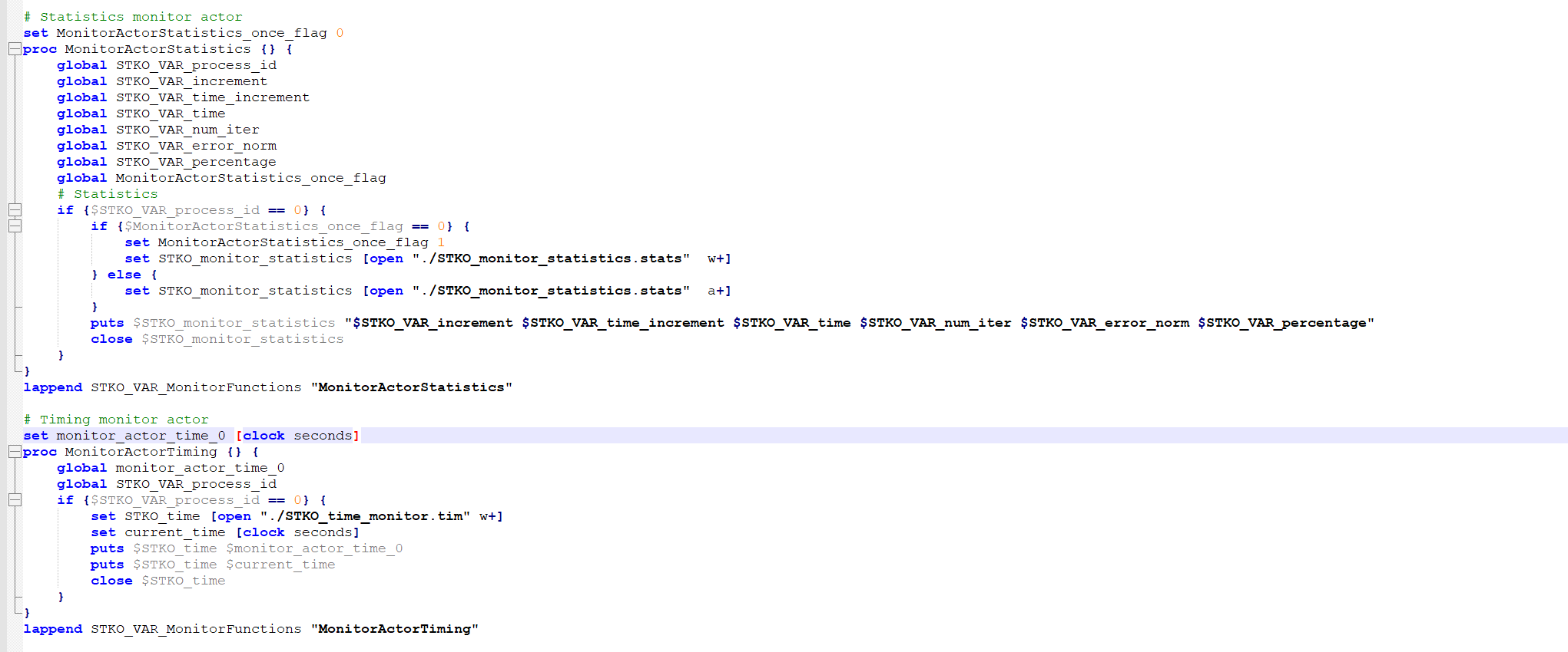

Re: ERROR IN PARALLEL ANALYIS
You have to change also every instance of process_id with STKO_VAR_process_id
here's a modified file:
