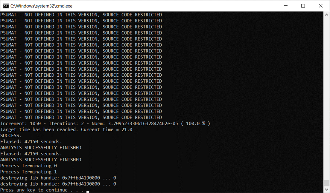

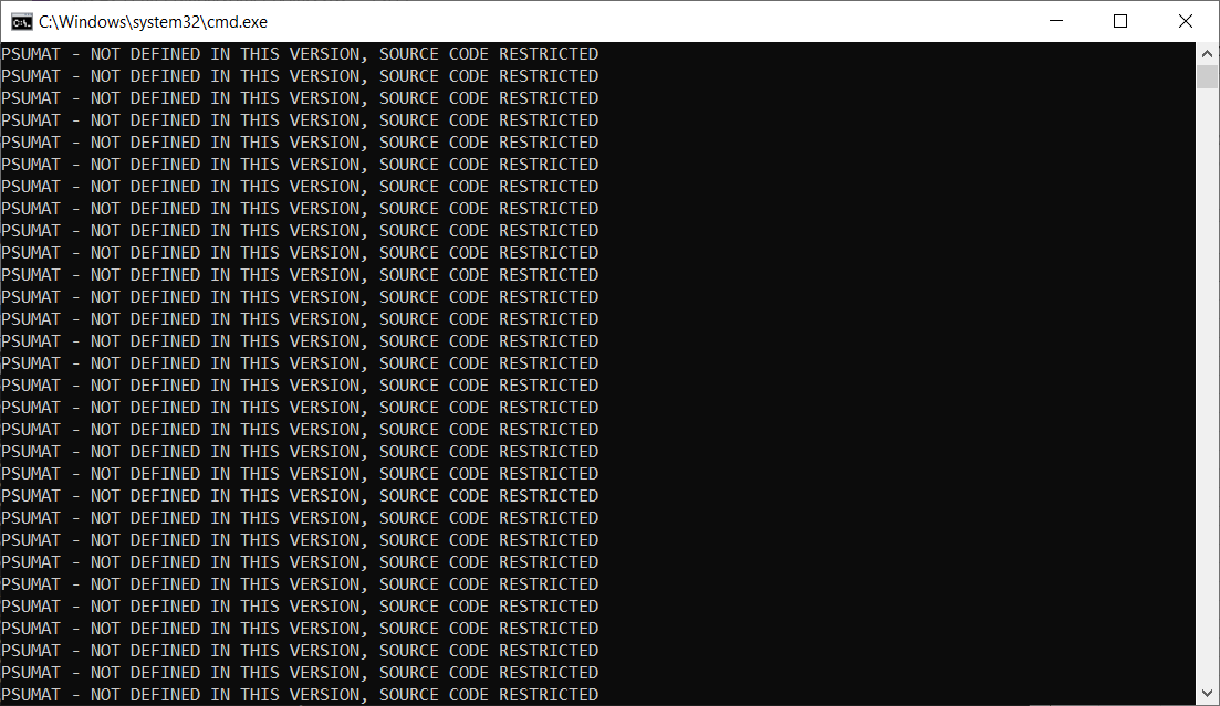

The clause “PSUMAT - NOT DEFINED IN THIS VERSION, SOURCE CODE RESTRICTED” is appeared when openseesmp solver is used to analyze LayeredShell section with PlaneStressUserMaterial and PlateFromPlaneStress. Analysis successfully finished after too long time with repeating that clause.
This issue is fixed when opensees solver is used.
Is there any subroutine or way to apply these materials for openseesmp solver?

Re: PSUMAT - NOT DEFINED IN THIS VERSION, SOURCE CODE RESTRICTED
It's simply because the source code for the psumat material is not available to the public. The owner put its code directly inside a library, but only for the sequential version on windows.

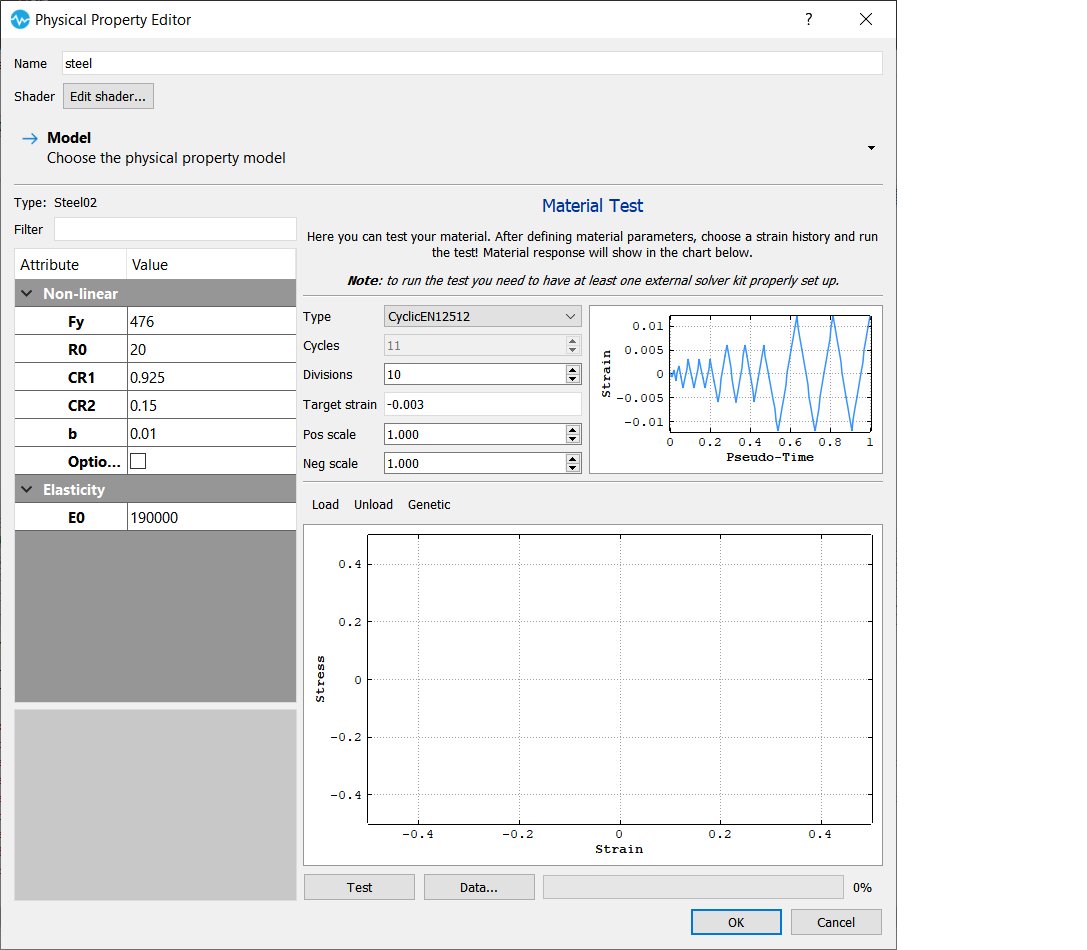

1- To use DamageTC3D instead of PSUMAT material, I tried to analyze the model displayed in the webinar of Shear Wall. The analysis is completed, but unfortunately no damage is displayed (d+ d- equal 0 for all steps). Could I ask you about this matter, please?
2- Material tests for uniaxial and nD materials don’t work in last version 2.0.5 of the program. How could I fix this issue?
We are aware of that (not able to see the damage in fibers of shell).
Someone made a change in the latest OpenSees version that is in conflict with results on shell fibers other than strain and stress. We are trying to identify the issue and we will fix it soon in the next version.
Regarding the material tester, it was a bug in the very first release of the 2.0.5, if you download it again (2.0.5) the problem should be solved
