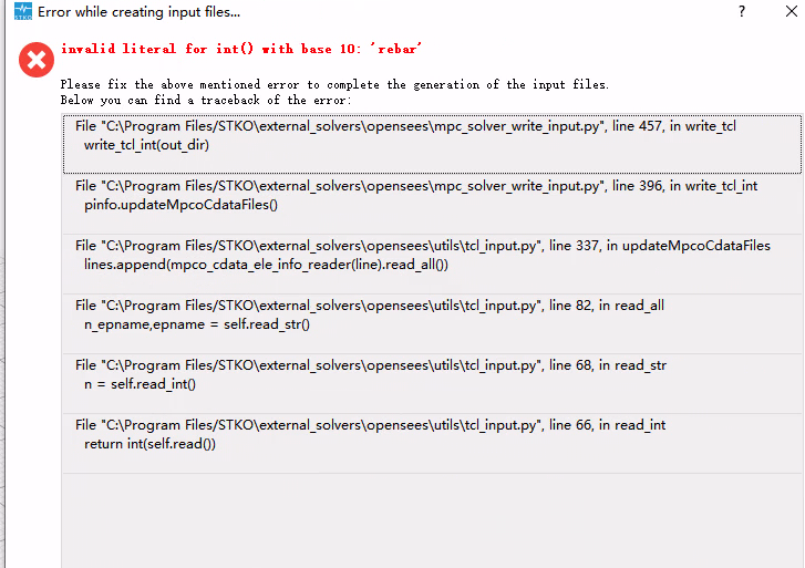

I need help resolving an error when switching from ASD3D to RandomizedMaterialWrapper in an eccentric column model.
Issue:
Model works with ASD3D.
Fails with RandomizedMaterialWrapper, throwing:
invalid literal for int() with base 10: 'rebar' (new error).
Actions:
Checked material definitions, input files (attached), and documentation—no solution found.
Questions:
Are additional inputs required for RandomizedMaterialWrapper?
Could parameter parsing (e.g., string vs. integer) cause this?
Input files (working/error versions).
Error screenshot.
Thank you for your support.
Best regards,
Error: RandomizedMaterialWrapper "invalid literal for int(): 'rebar'"

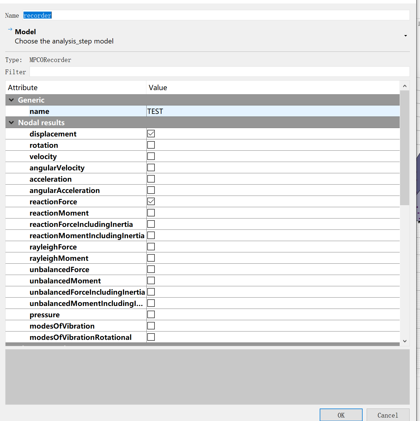

I am writing to seek your technical support regarding an issue encountered during my recent testing. After troubleshooting, I identified that the problem likely stems from the Recorder function: the software operates normally when the Recorder is removed, but fails to generate output when the Recorder is enabled. This suggests a potential conflict or bug within the Recorder module. Could you kindly investigate this behavior?
Thank you for your prompt attention to this matter.
