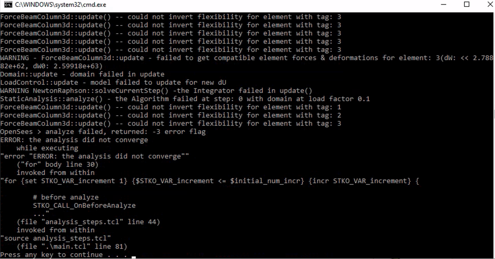

I was preparing a fiber section model and for that I was using as a reference the video https://www.youtube.com/watch?v=0lLeIZpLwlQ&t=34s
However, when I run my model, the .exe window says it does not converge.
Can someone help me find error?
bridge deck.scd.zip
(106.27 KiB) Downloaded 181 times
exe. window.png (455.36 KiB) Viewed 2114 times

It was singular from the beginning because you forgot to input -GJ (if in 3D you leave it as 0, your beam will be singular in torsion)

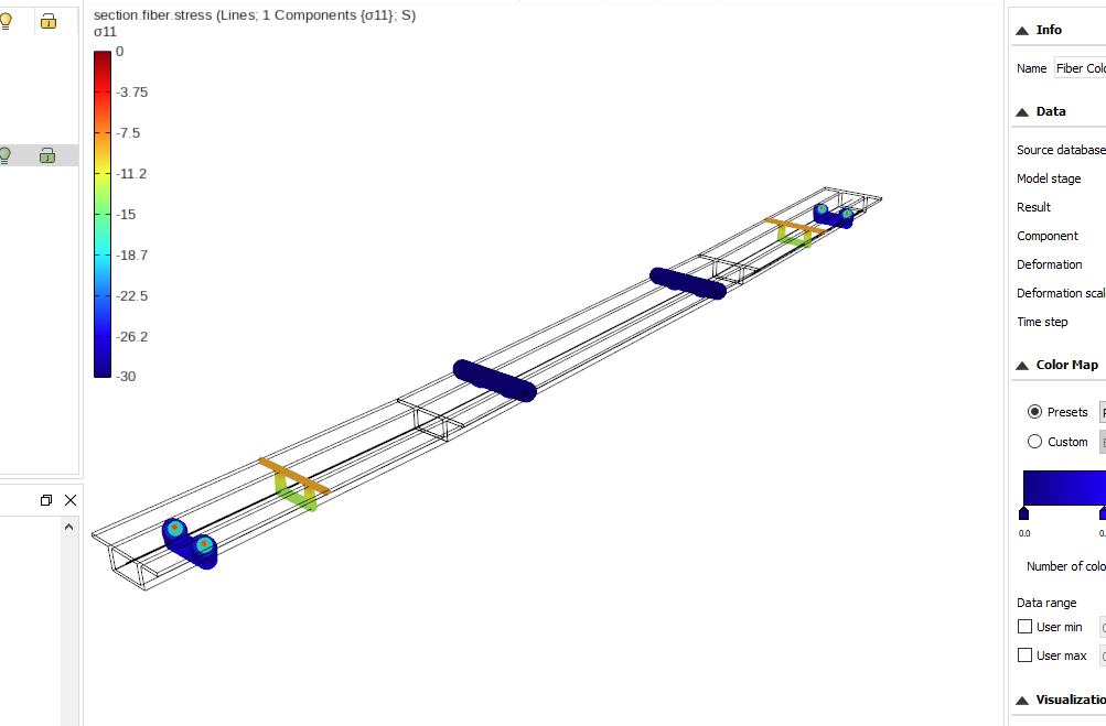

Now it will run for some steps and then it will stop converging because parts of your beam are crushing (and you did not put any steel in there):

Yes I didn't put any steel because the idea is to create an homogenised section (steel into concrete) for an easier analyses.
Do you think that will bring problems to the model and its results?
Re: Analysis did not converge
Post by STKO Team » Wed Apr 05, 2023 7:37 am
You can do it. But you will have to define a uniaxial material that contains both concrete and steel accounting for their volume fractions. You can use the parallel uniaxial material for this
