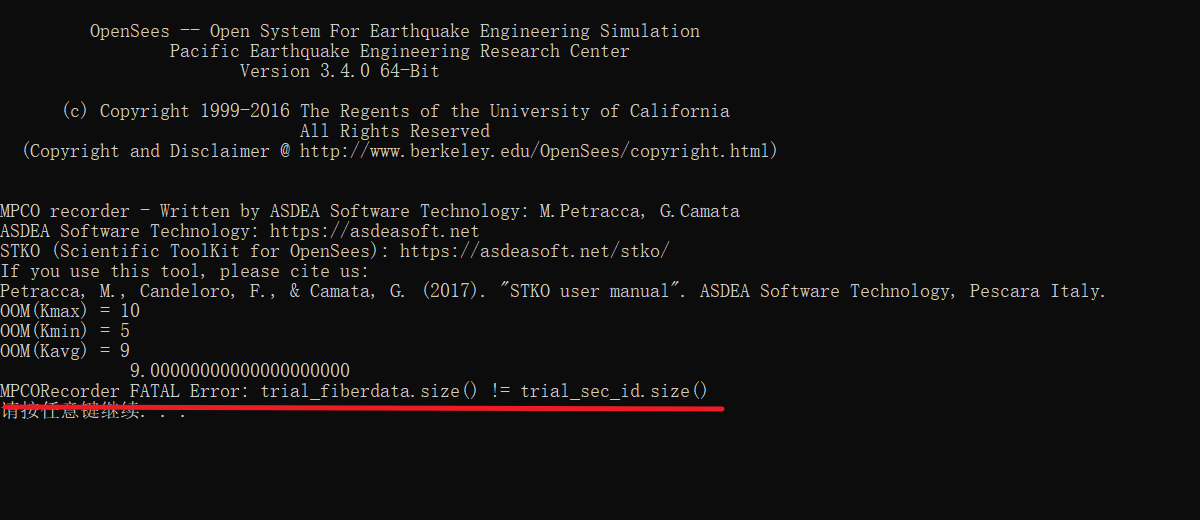

Dear STKOteam,
The problem I mentioned is still not solved.
Lei Lei wrote:
Mon Mar 18, 2024 1:39 am
Therefore, I used an 'aggregator' to give shear resistance to the joint, but It reported errors.
It can compute successfully when I forgive using the 'MPCORecorder' command.
What's the reason for it? The version of STKO is 3.3.0 and of Opensees solver is 3.4.0.
The error message is just like picture below:

Lei Lei wrote:
Mon Apr 08, 2024 5:40 am
The error message is just like the picture below:

Can you share your STKO file?
The error is in the MPCORecorder during the opensees analysis. Probably due to an element that does not format the results correctly

Are you sure you attached the same file?
I don't have that error with OpenSees 3.4.0 (try to download again the OpenSees-Solvers from prof. tarque's website).
Second, I see problems in this model: 1) the MPCORecorder is at the end, and 2) the selection set for the control node is empty

Dear,
I reinstalled the OpenSees 3.4.0 from https://www.researchgate.net/publicatio ... r_OpenSees.
However, the mistake still exists. Figure1.
