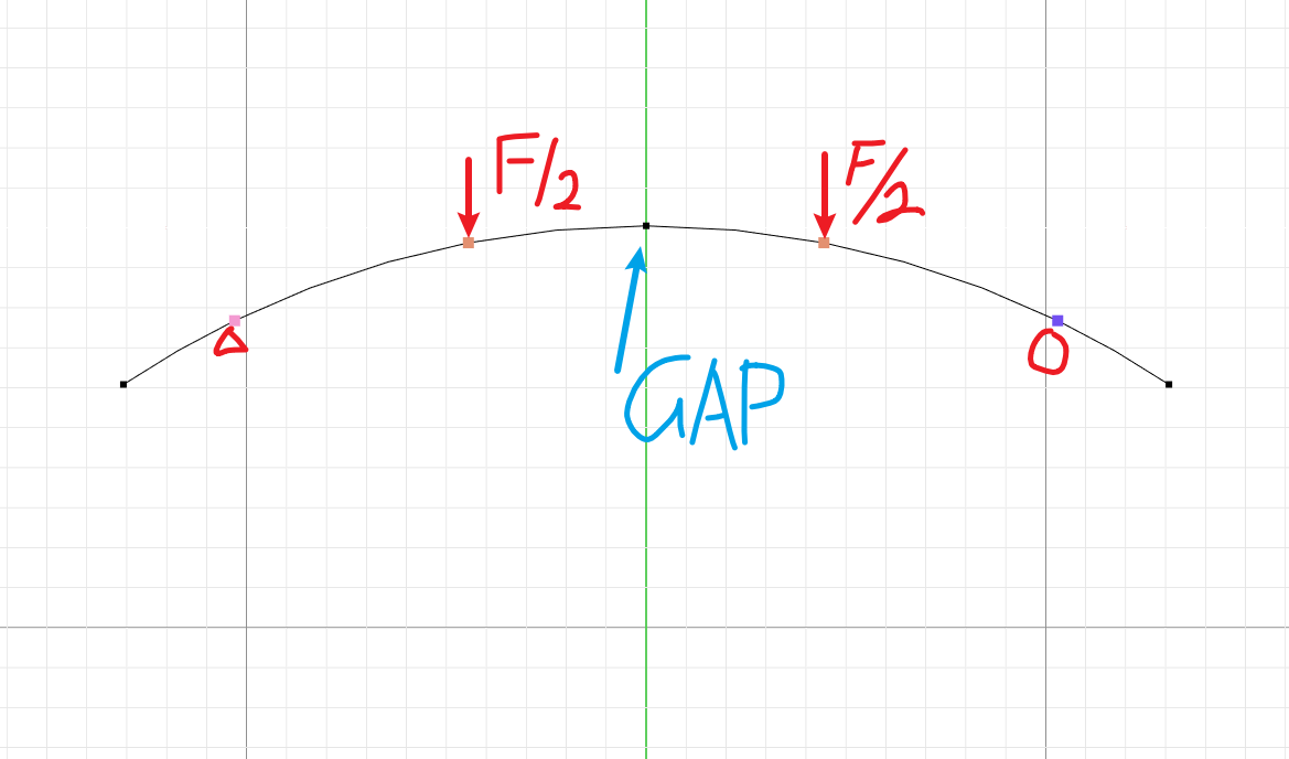

I'm simulating a four-point bending experiment just like Figure 1 shows. However, there are three gaps in the middle joint of the separated curved beam. Is there any way to simulate the behavior of gaps? With the gaps, the two parts of the curved beam will rotate and then touch each other.

Yes, it is possible to achieve that task using zeroLengthContactASDImplex. Please refer to the webinar in the link below.

To use a 2D beam with a fiber section to replace the solid curve beam, what should I do to simulate the gaps' behavior?
Does the method you recommend still work?

Yes, you can still use the element by creating two auxiliary nodes at the vertex, where gap is simulated. It's because the beam element has 3 DOF at a node in 2D, but the zeroLengthContact element works with 2DOF in case of 2D problem. Hence, we need those auxiliary nodes. You can do it like:
1) create two auxiliary nodes (say, A and B) at the same location where the gap is present
2) connect left beam with A using equal dof interaction (only displacements)
3) similarly, connect right beam with B
4) use zeroLengthContact element between A and B

I guess I also need to define a fiber section for the zeroLengthContact element to simulate the construction of the gap.
Can I select two nodes on the ends of the beams instead of creating two auxiliary nodes?kesavapraba wrote: ↑Sat Mar 09, 2024 5:29 pm1) create two auxiliary nodes (say, A and B) at the same location where the gap is present
Since the gap will rotate, Why don't you couple all DOFs of the auxiliary node and beam?kesavapraba wrote: ↑Sat Mar 09, 2024 5:29 pm2) connect left beam with A using equal dof interaction (only displacements)
What's the difference between zeroLengthContact element and zeroLengthSection element?
Re: Gap simualtion
No, it is due to the limitation of the number of degree of freedom imposed by the zeroLengthContact element. As already mentioned, beam element has 3 DOFs, whereas the zeroLengthContact can handle only 2DOF in 2D problems.Can I select two nodes on the ends of the beams instead of creating two auxiliary nodes?
Gap cannot rotate, it is the structural elements that can deform and close the gap and make contact with each other. Coupling of the DOFS between the auxiliary nodes and the beam ends has nothing to do with gap rotation, it is because zeroLengthContact element can deal only with 2 DOFs at a node. For this reason, the auxiliary nodes need to be created. Had it been some quad/triangle element in 2D, you don't need the auxiliary nodes.Since the gap will rotate, Why don't you couple all DOFs of the auxiliary node and beam?
while both elements involve zero-length characteristics, the ZeroLengthContact Element is focused on modeling contact behavior, whereas the ZeroLengthSection Element is used for connecting points with a specific force-deformation relationship representationWhat's the difference between zeroLengthContact element and zeroLengthSection element?
Contact element doesn't require such definition. Please watch the webinar by Dr. Massimo which I shared in the previous answer.I guess I also need to define a fiber section for the zeroLengthContact element to simulate the construction of the gap.
