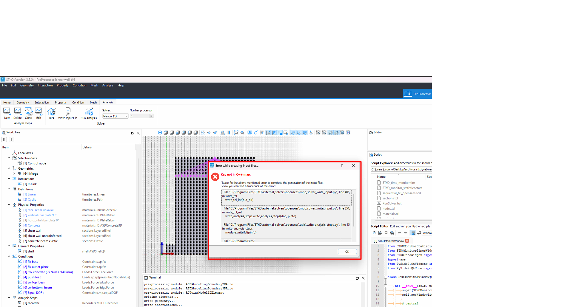

I write to ask for help with a message that tells me the program when trying to run the model. I have followed the instructions shown in the webinars but now I see the following image that is attached in the email. Please request help promptly.

Hi, You have incorrecctly assigned beam element(line element) to surfaces. You can use ASDShellQ4 shell element with ElasticMembranePlateSection section properties instead of beam element for the surfaces.

Hello thank you very much, I corrected the mentioned error but now it shows me another problem.
Error message.png (833.6 KiB) Viewed 1817 times

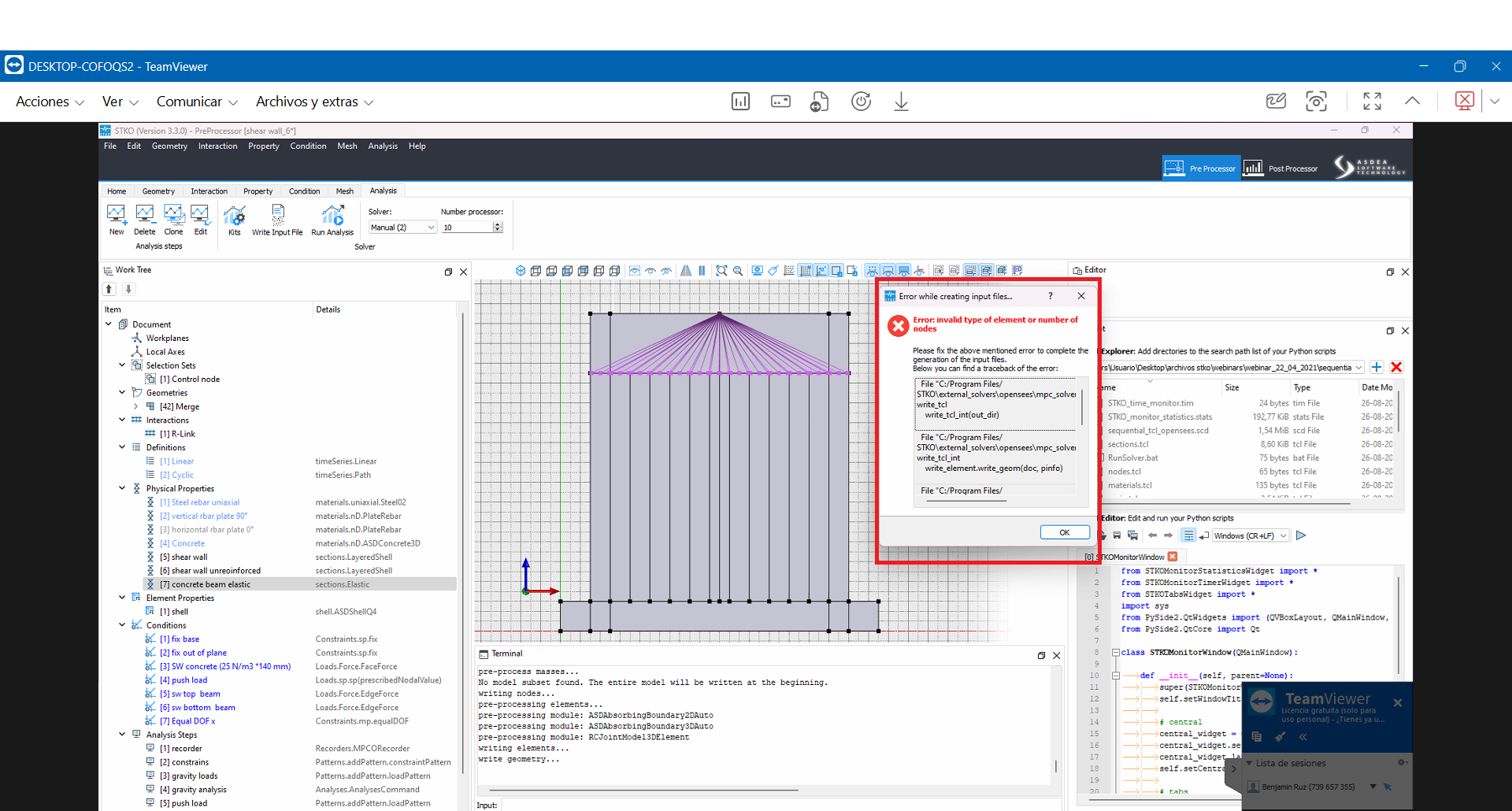

I corrected the above by adding more lines to the geometry and now I see the following error. I don’t understand what it refers to.

i forgot the picture, here is.
Error message_2.png (686.2 KiB) Viewed 1816 times
Re: erro while creating input files
Post by kesavapraba » Wed Sep 25, 2024 5:34 am
Can you please share the model? Error in the picture is not clear to me

Post by bruznunez » Wed Sep 25, 2024 9:23 am
Sure, here is the current model.

Post by STKO Team » Thu Sep 26, 2024 8:09 am
You are using an elastic beam section for a shell.
You should use section->ElasticMembranePlateSection
