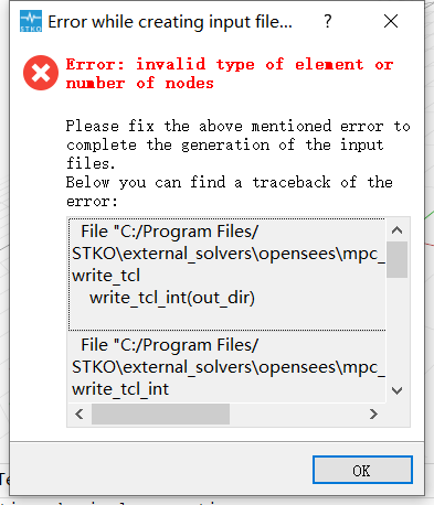

1.Follow your advices,I modeling the model but it did not work,the error is “invalid type of element or number of nodes?”where is the mistakes? I attachede the model.
2.I also want to know platefiber how to fiber section,what can I do if wants to mesh type by quadrilateral?

There was a problem that you did not use a structured mesh for your shell.ASDShellQ4 element. Now it is working.
Give a look at the description of the element you are using.

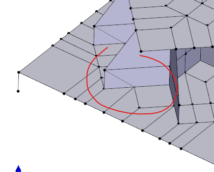

I was use structured mesh for my shell.ASDShellQ4 element.but it also have some errors .maybe I make mesh control is wrong. where is the mistakes please tell? thank you !
- 1111.png (92.38 KiB) Viewed 3775 times

The problem was that your geometry is not with 4 nodes, so even if you used mesh controls it could not generate the structured mesh. Look how I corrected your geometry, it would be more clear what I mean.
Notice that I have changed solver to UmfPack SOE.

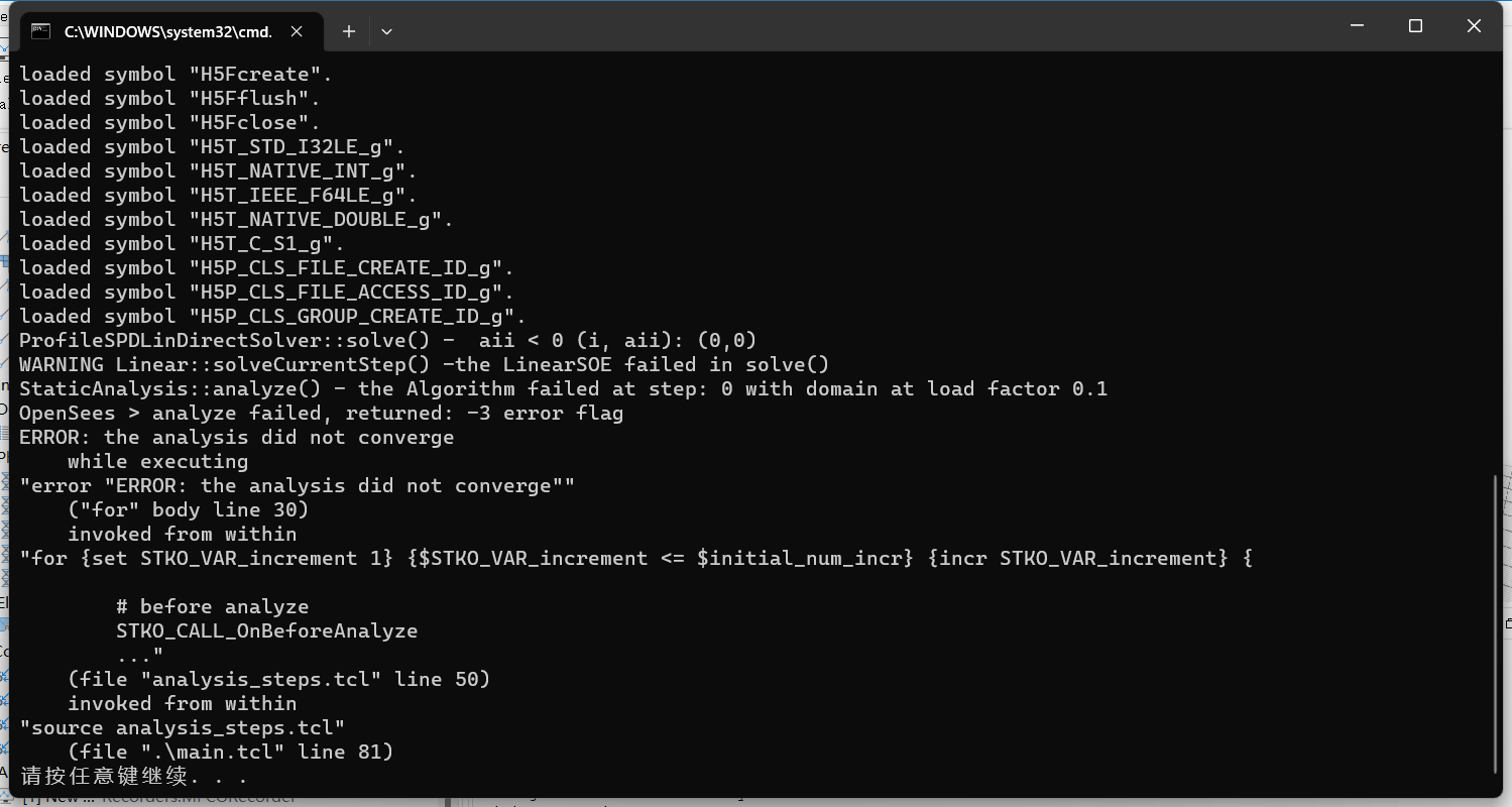

I modified the model as you said, but this error is displayed when calculating, please help see where is the problem?

You have geometries that cannot be meshed with 4 node quads:
So I changed everything to a triangular mesh with a triangular shell element.
But please, double check your model because the boundary conditions are really strange.
