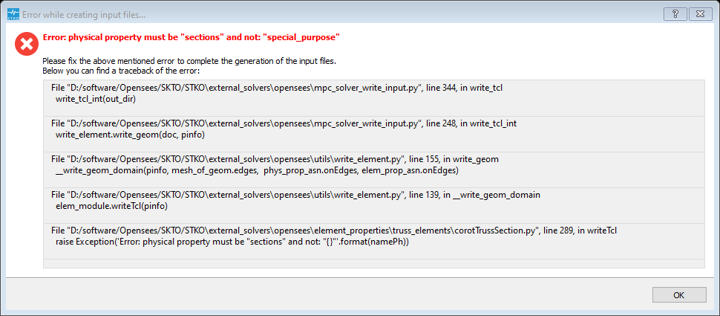

I am trying to model a post-tension bar, I used steel01 material and initialstrain material to add PT force, then assigned truss element. When I run the model the error said physical property must be section, I added a section in special purpose, Do you have any ideas to fix the issue?

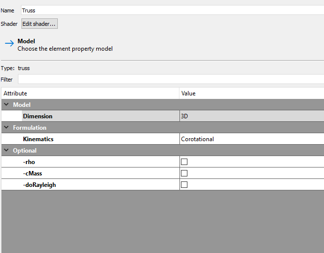

It's because you are using a corotTrussSection, which expects a section (like a fiber section for composite trusses).
In your case you just need a corotTruss:
DaHuang
Posts: 7
Joined: Mon Jun 06, 2022 10:12 pm
Re: physical property must be section not special purpose
Post by DaHuang » Tue Jul 05, 2022 3:16 pm
Thanks! working now
