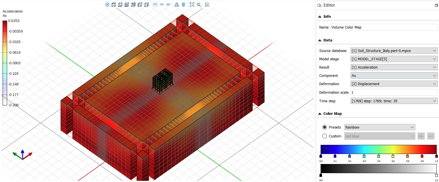

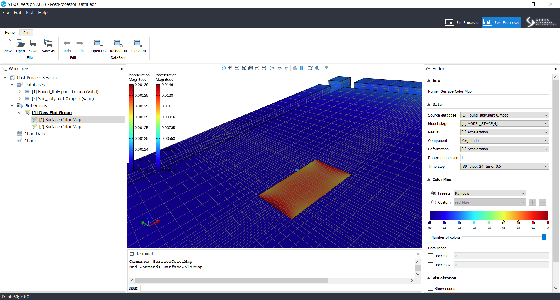

It makes perfect sense. Penetration is related to displacement (not velocity nor acceleration). A simple example is a contact between 2 nodes: Node_1 (at position X = 0) is fixed, so its displacement Ux(t) = Ux(t+dt) = 0, and therefore its first and second derivatives with respect to time are both 0 (velocity and acceleration). Node_2 (at position X = 1) has Ux(t) = 0 and Ux(t+dt) = -1 (displacement at which contact happens), so its velocity is not zero, but -1/dt.Please, could I ask you about the penetration between lateral sides of foundation and surrounding soil? When the magnitude of acceleration is displayed together with displacement for deformation, there is no penetration. However, the left side of foundation penetrate the soil when acceleration is used for deformation.

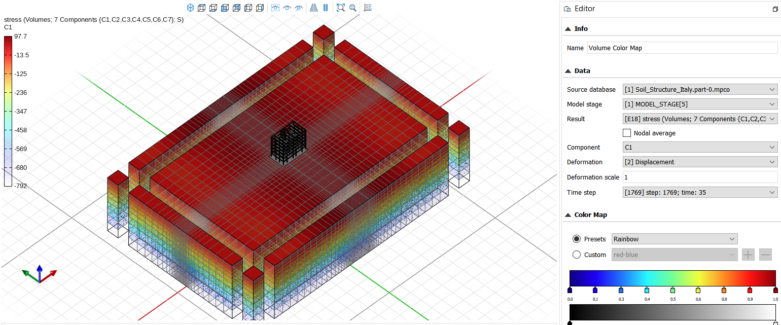

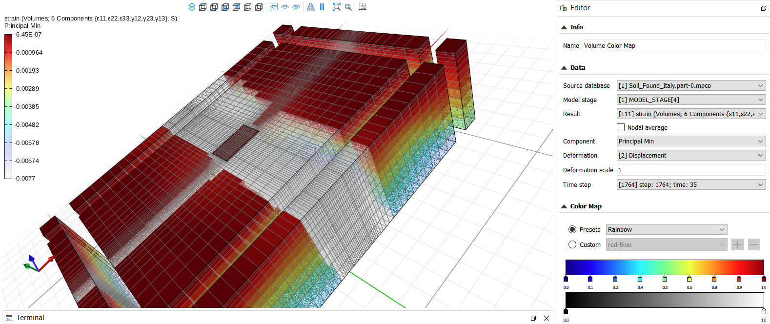

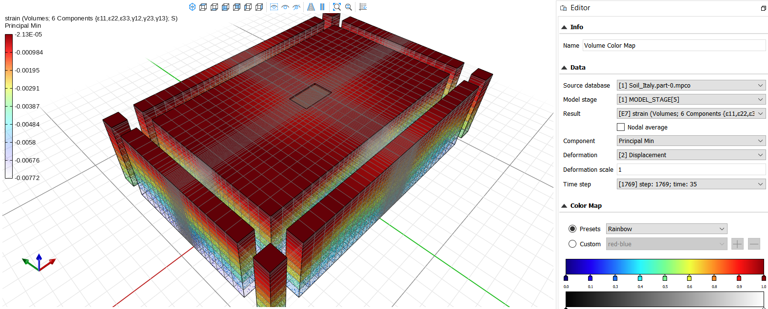

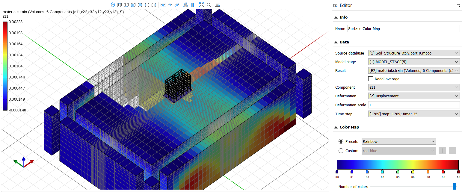

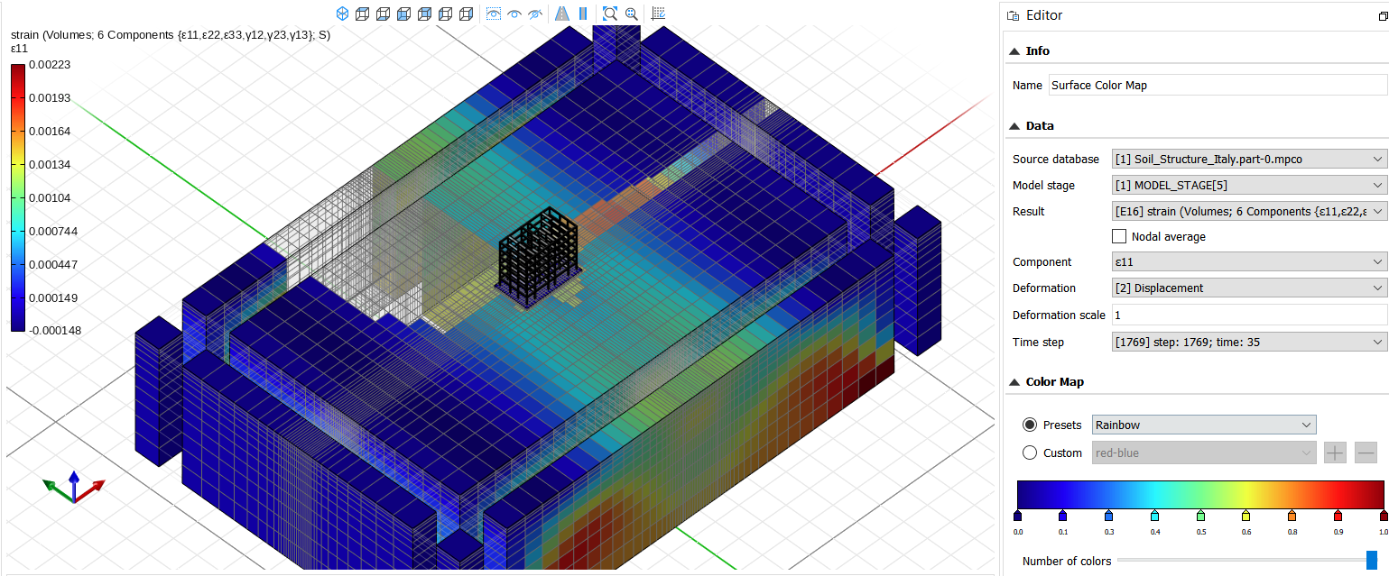

I noticed that no strain displayed in soil surrounding the foundation. Could I ask you what’s the problem, please?

This is strange... can you share your model here?
Re: mesh type related error

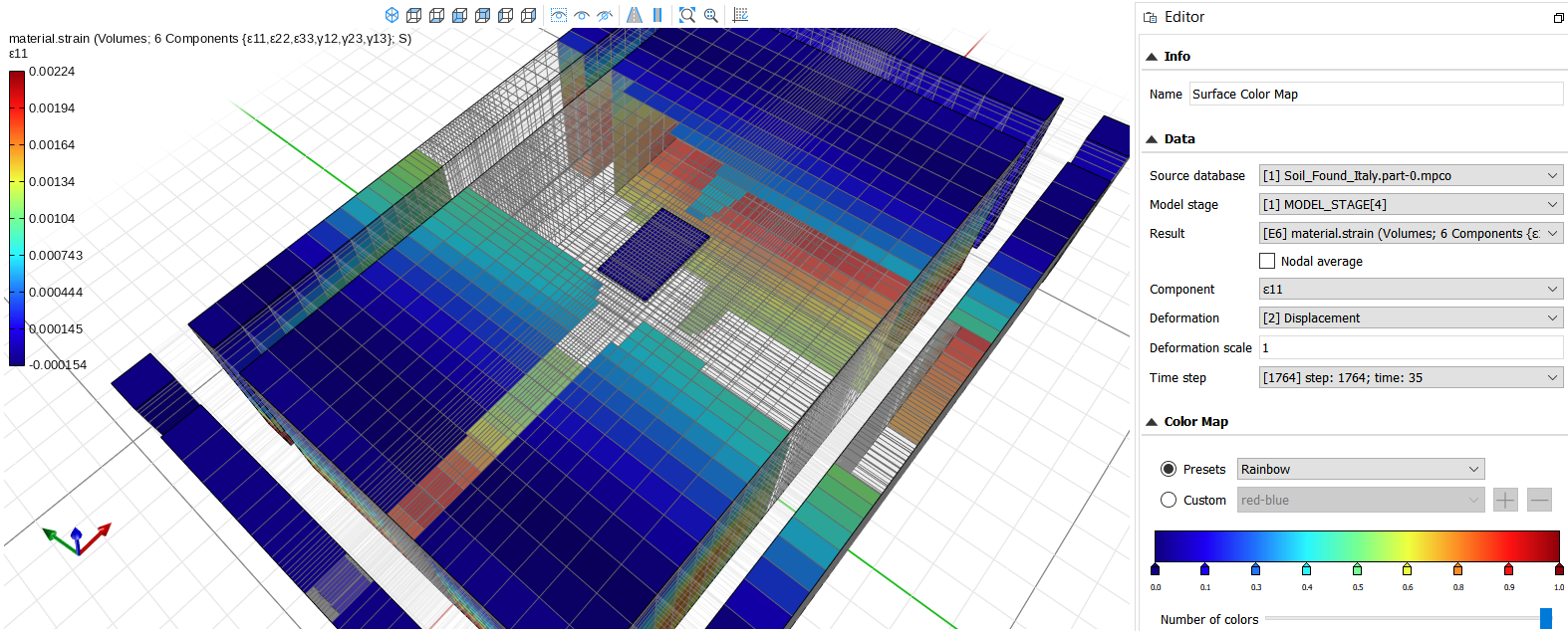

This problem exists in the both cases of the presence and absence of the building. However, it becomes more clear when the foundation is present only without the building, so I send the relevant file.
I will be grateful for any help or information you can provide.

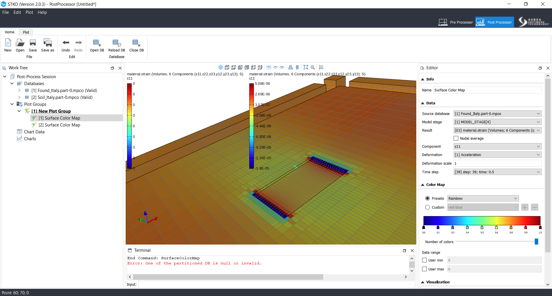

Thank you very much for your reply.
I have checked the proposed solution, and used 2 recorders for 2 regions: (soil) and (structure/foundation). This method works just for nodal results. Unfortunately, it doesn’t work in my model for element results such as stress, strain, section force, etc., where the (structure/foundation) model is omitted from the render window with error message in the terminal bar (Error: One of the partitioned DB is null or invalid).
I was wondering what the difference in my model is. Could you help me to resolve this issue, please?
You are right,
we have identified the problem and it will be solved in the next (2.0.4) version.
The problem is that the foundation is so small, that it appears only in some of the 8 partitions (1,2,5, and 6), while it is not in partitions 0,3,4 and 7.
You can see it when loading the database for the foundation. You will see 4 error messages saying that some of the database cannot be opened (error in red).
Now you can solve it manually.
You can delete the MPCO files (before importing them into STKO) that generated that error. In your case 0, 3, 4 and 7. The you can load the MPCO files and it will work
