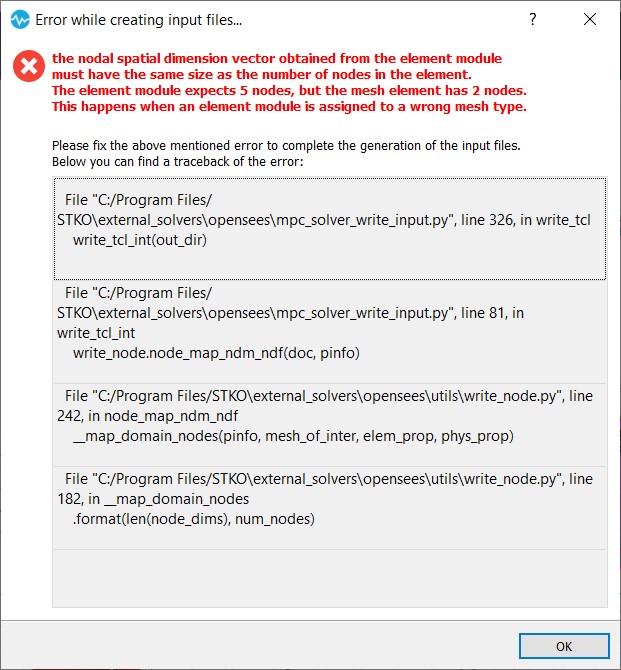

An error happens while creating input files, this error is related to mesh type.
The model consists of line elements for building and solid elements for soil domain and foundation.
I would be most grateful if you could illustrate how to fix this error.

It means that you assigned a wrong Element Property (with 5 nodes, what element is that?) to an Edge (mesh with 2 nodes).
This happens when you use the sub-selection and erroneously select the boundary edges of a face or of a solid.

The error means that you assigned an element property that expects 5 nodes to a mesh that has 2 nodes.
The SimpleContact3D required 5 nodes, 4 from the face of an hexaedron, and 1 that should be in contact with it. So your interaction should have been a node-to-element, not a node-to-node. The node-to-node is always a 2-node link.
In order to keep the interaction as is, I changed the element type to ZeroLengthImplexContact. It is a new contact element that we recently added (and it is available in your OpenSees if you downloaded the OpenSees-Solvers from prof.Tarques website, otherwise you can use the standard ZeroLength Contact)
The advantage of the implex one is that, if you choose the -implex option, the contact element will be always convergent, but requires small time-step.

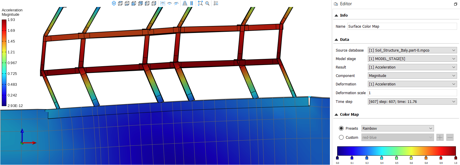

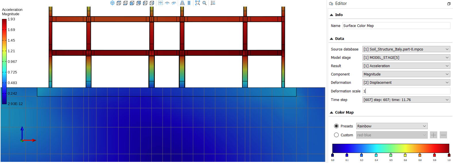

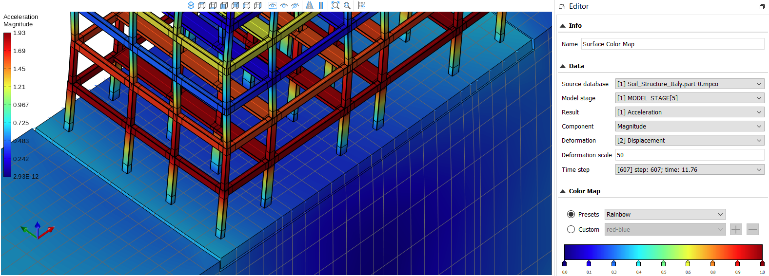

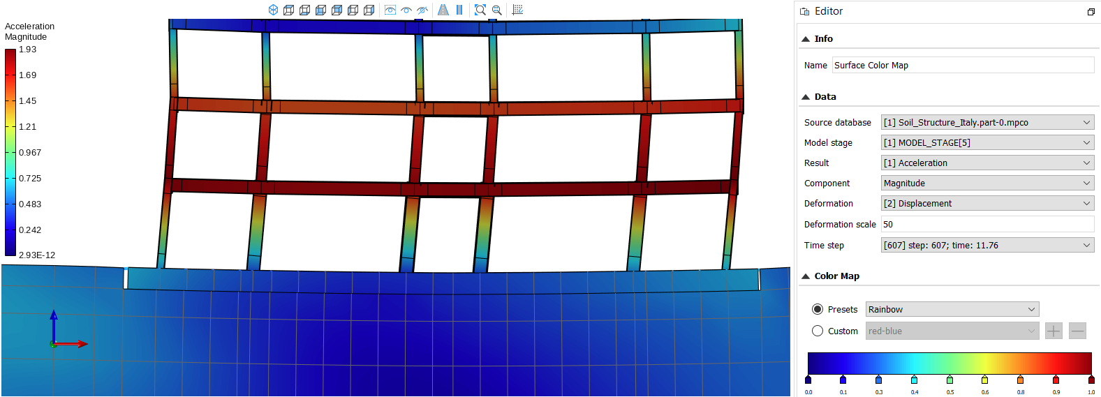

I would like to thank you for your assistance and guidance, and to tell you that analysis run and complete successfully after doing the modifications.
Please, could I ask you about the penetration between lateral sides of foundation and surrounding soil? When the magnitude of acceleration is displayed together with displacement for deformation, there is no penetration. However, the left side of foundation penetrate the soil when acceleration is used for deformation. Illustrated figures are attached. Therefore, is there any penetration or not?

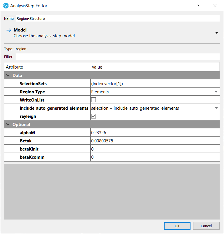

I have used the frequencies 0.2 and 20 Hz to calculate Rayleigh damping for soil.
Please, could you tell me if you have any notice or correction for these chosen frequencies? Could you suggest a reference to get a benefit?

I have used the frequencies (f1, f4) of the first two modes in the X direction of the fixed structure (using ETABS) to calculate Rayleigh damping for structure and foundation.It depends... since you never model all the physical nonlinearities, you may need artificial damping. And you should do it with regions if the damping coefficients are different for soil and structure.

It makes perfect sense. Penetration is related to displacement (not velocity nor acceleration). A simple example is a contact between 2 nodes: Node_1 (at position X = 0) is fixed, so its displacement Ux(t) = Ux(t+dt) = 0, and therefore its first and second derivatives with respect to time are both 0 (velocity and acceleration). Node_2 (at position X = 1) has Ux(t) = 0 and Ux(t+dt) = -1 (displacement at which contact happens), so its velocity is not zero, but -1/dt.Please, could I ask you about the penetration between lateral sides of foundation and surrounding soil? When the magnitude of acceleration is displayed together with displacement for deformation, there is no penetration. However, the left side of foundation penetrate the soil when acceleration is used for deformation.
Here is a reference about damping (rayleigh and numerical damping) for soils:have used the frequencies (f1, f4) of the first two modes in the X direction of the fixed structure (using ETABS) to calculate Rayleigh damping for structure and foundation.
