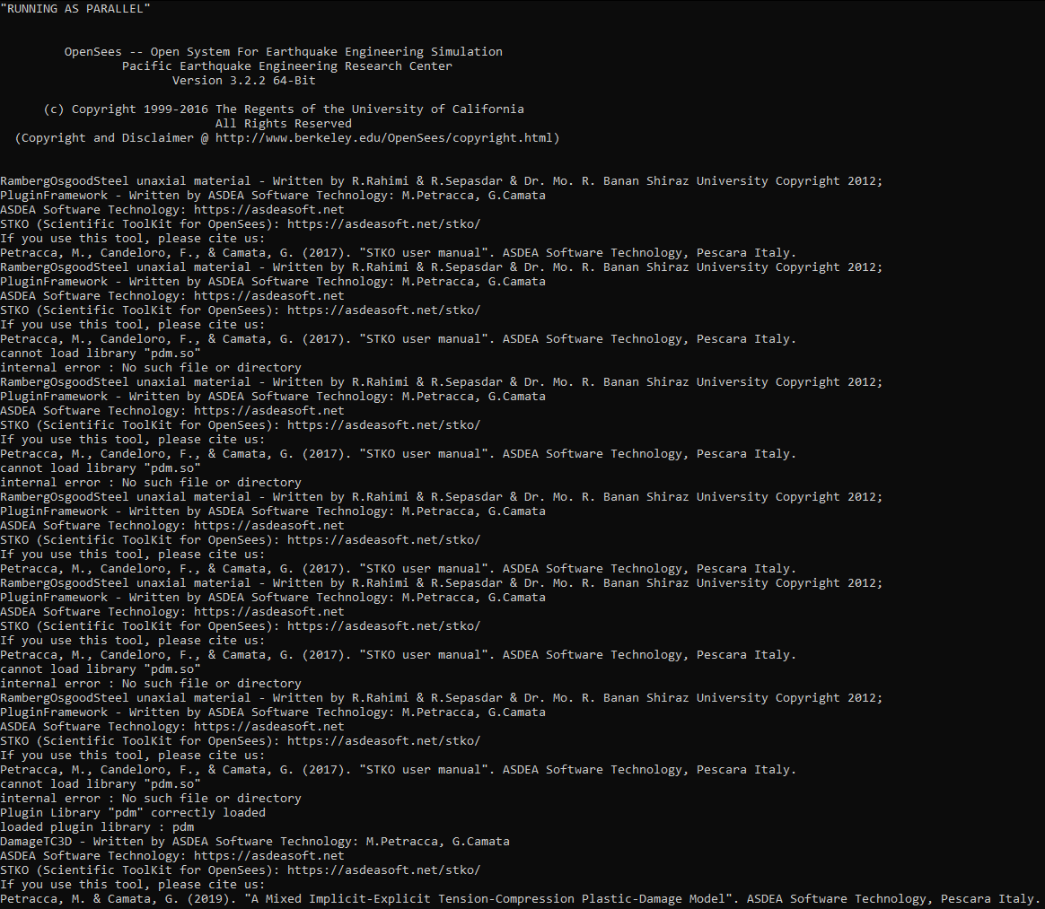

i am trying to do an analysis with openseesMP. I followed the directions in this post viewtopic.php?f=38&t=1642
to transform the analysis from sequential to MP. I get this error though:

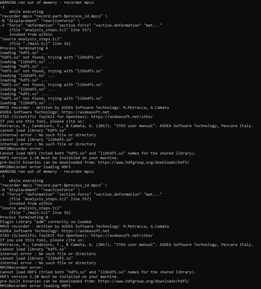

Error in analysis

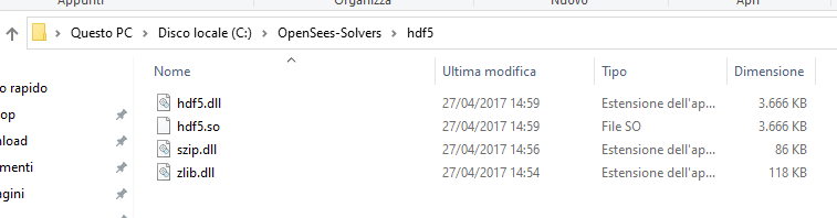

You are having that error because it says that it cannot find HDF5 libraries.
However they are there.

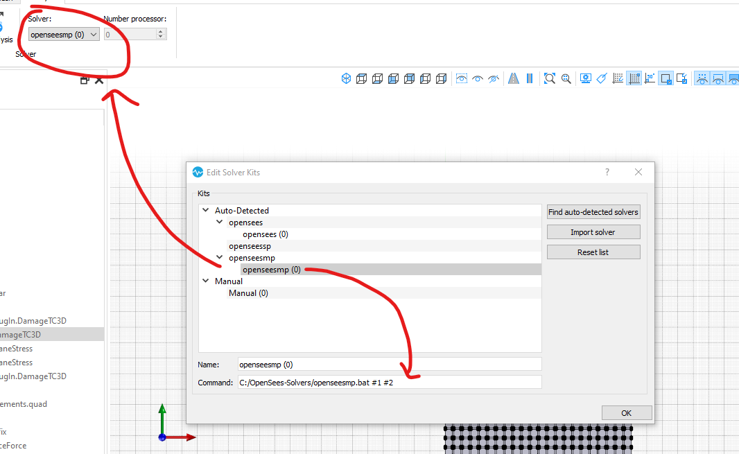

- First make sure you are selecting the proper openseesmp:
- Make sure you have the following libraries in C:\OpenSees-Solvers\hdf5:

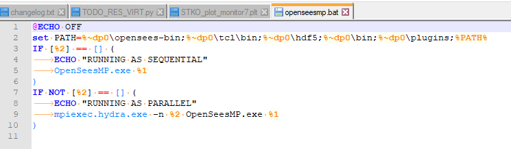

- Finally, make sure you don't have accidentally changed the contents of the openseesmp.bat file in C:\OpenSees-Solvers:
Re: Error in analysis
ok now it works.
hdf5.so was missing.
I reinstalled again the package.
THX
