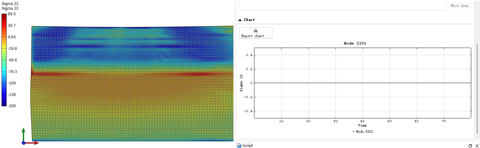

However, I’ve encountered an issue and am unable to determine the exact cause. When using STKO version 3.2.0, this code successfully retrieved the node stress results. However, when using a newer version of STKO, while the stress contour plot displays correctly, as shown in Figure 1, the “chart data” section remains empty, and the following error message appears:
Error: (MpcOdbReaderMakeScalarFieldHistory) Could not find the following nodes in the field data:
5331,
Abort Command: ExtractChartData
Could you please offer some advice? Is this code capable of effectively extracting node stress results, or how should I modify it to make it compatible with newer versions of STKO?

Re: Extraction of Node Stresses During Post-Processing
Post by STKO Team » Mon Jul 27, 2026 8:19 am
Dear user,
Thank you for letting us know. We're resolving the bug soon, and the fix will be available with the next stko version.
In the meantime, you can extract a value at a node, ora emulate the extract chart data via python code (look at our first webinar on python api)
As far as I can tell, the current STKO calculation results only display stress values at Gauss points. I would like to further extract the stress calculation results at nodes.
Actually any gauss result, when visualized in a surface plot, is extrapolated to the nodes, and optionally (with a checkbox) can be smoothed
