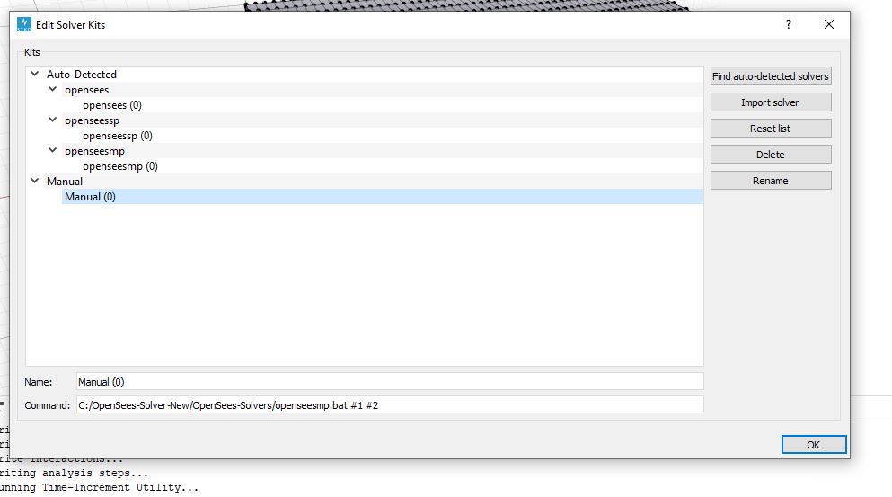

I have downloaded the new OpenSeesSolver (Version 3.7.2) from the website :
https://www.researchgate.net/publicatio ... r_OpenSees

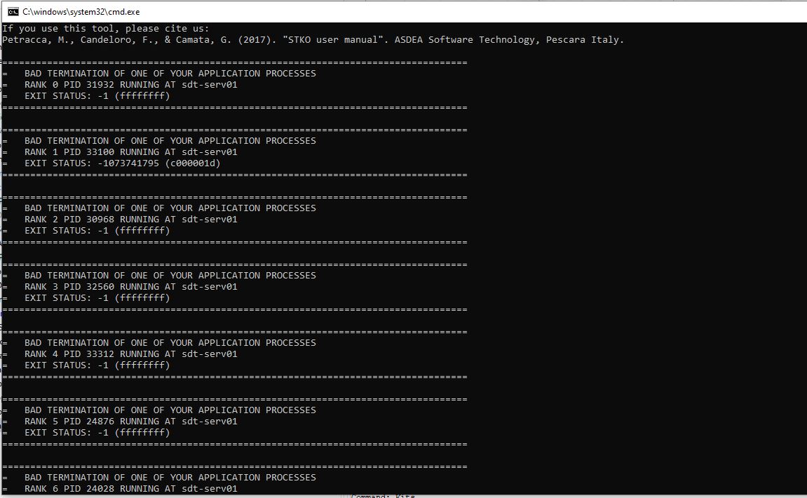

I have created a simple model for 3D analysis soil, when i run it with the opnseesmp 3.4.0 (old file) it work fine , but i use the opensees solver for parallel analysis from 3.7.2 , i end to the following error:
I tried several other models which were running correctly in the old solver but with new solver i am having the above issue.

If the issue is with the new installation and for all opensees models, it means there is something wrong with your opensees installation.
How did you install the new version?
Are you sure your firewall and/or antivirus is blocking the mpiexec executable in your OpenSees installation directory (C:\OpenSees-Solvers\oneapi)?
