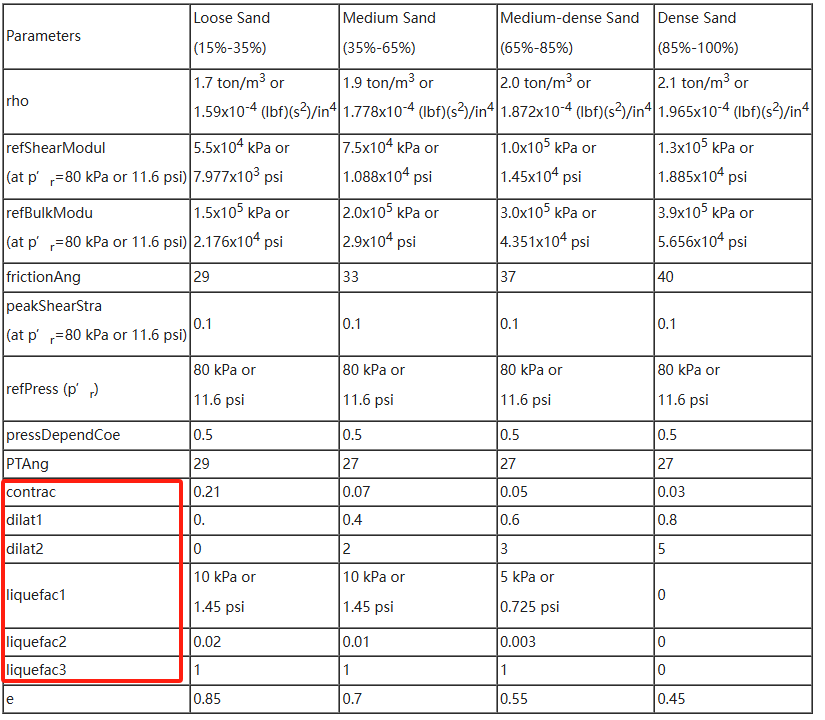

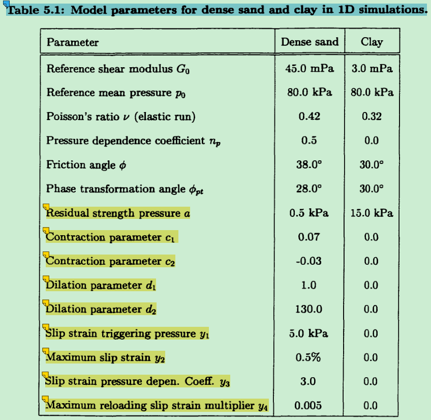

I have some questions regarding the PDMY material constitutive model and would appreciate your assistance:
1. Differences in Shear Contraction, Dilation, and Liquefaction Parameters
The parameters listed on your website differ from those in the main references, particularly for shear contraction, dilation, and liquefaction.
Parameters from Zhaohui Yang's PhD Thesis
Parameters from Opensees Webstie
2. Missing Critical State Parameters
The main references do not include critical state parameters.
Could you suggest any literature or resources that provide detailed information on these parameters shown on the website?
That is not our website, but the OpenSees' one.
I think the best way for you would be to contact the author who implemented it in OpenSees
