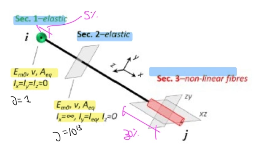

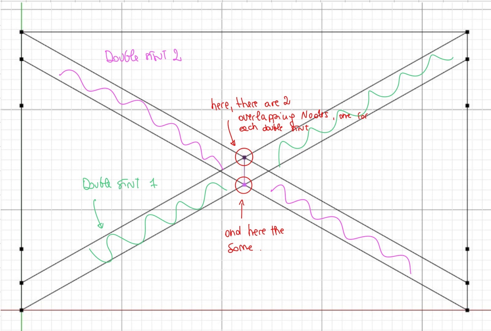

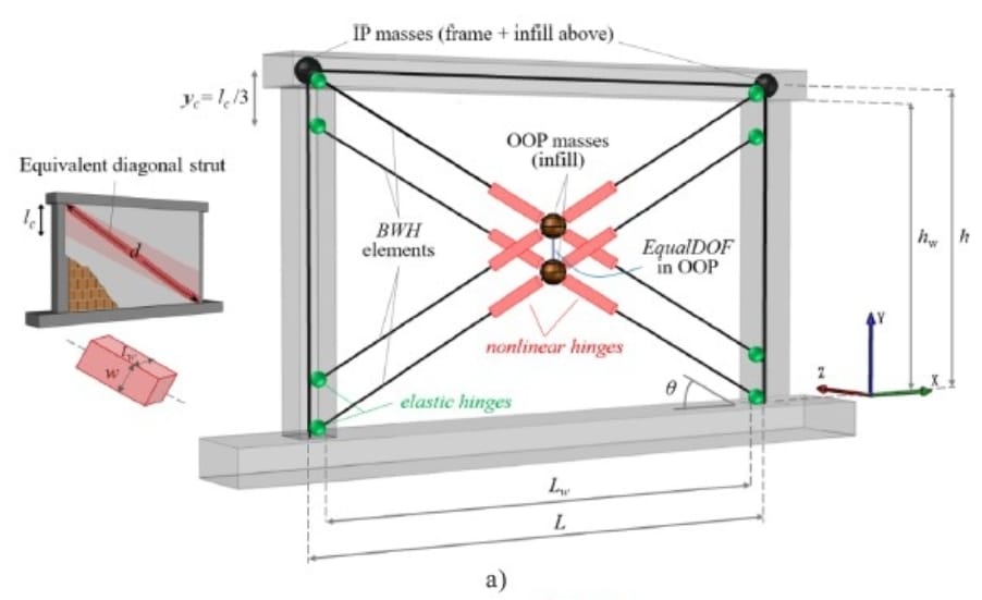

ok. But if I need to have that node in the center, as the section properties of the element are assigned, how can I do to not have a single node but two independent overlapping ones?
I attach an example image of the strut model.
I need the node in the center because half of the strut is composed of 3 sections: 2 elastic ones with different properties, and a non-linear section with fibers towards the center of the strut.

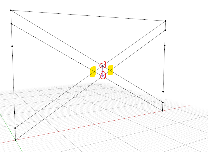

Re: Infilled frame
Sorry but I don't understand what you are trying to do.
Your initial model is exactly as described in your image: The 2 struts do not have common vertices (see in the yellow highlight zone, that intersection does not have a vertex, thus they are independent)
The only central vertices are the red ones (one for each strut): Or am I missing something?

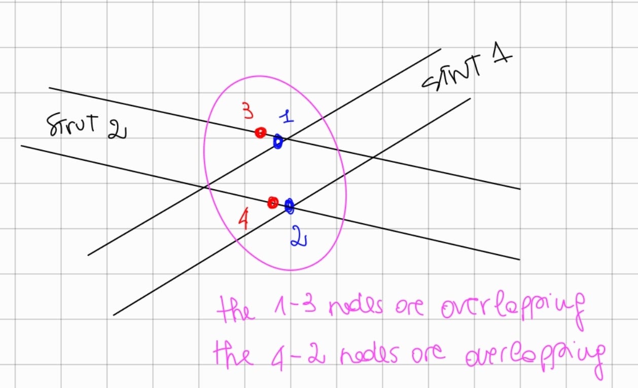

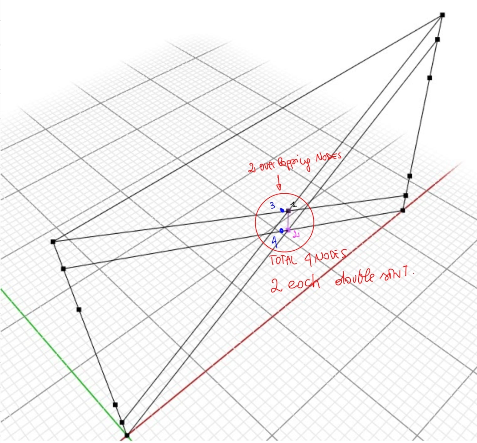

Sorry, I explained myself badly.
I attach the new images where you can understand better:
in the center of the panel there must be 2 pairs of overlapping nodes (as in the figure), for a total of 4 nodes. For each pair of nodes a double strut is connected: the first double strut starts from the bottom left to the top right, while the second starts from the top left to the bottom right.
Node 1 and 2 belong to double strut 1, while nodes 3 and 4 belong to double strut 2.
So by numbering the nodes from 1 to 4 as shown in the image, node 1 and 3 are overlapped, while node 2 and 4 are overlapped.
In this way the two double struts are completely independent.
I need to have overlapping nodes, otherwise the two double struts can pass through the same pair of nodes and are not independent.
- 3.jpg (151.3 KiB) Viewed 840 times
- 2.jpg (188.31 KiB) Viewed 840 times
- 1.jpg (64.68 KiB) Viewed 840 times

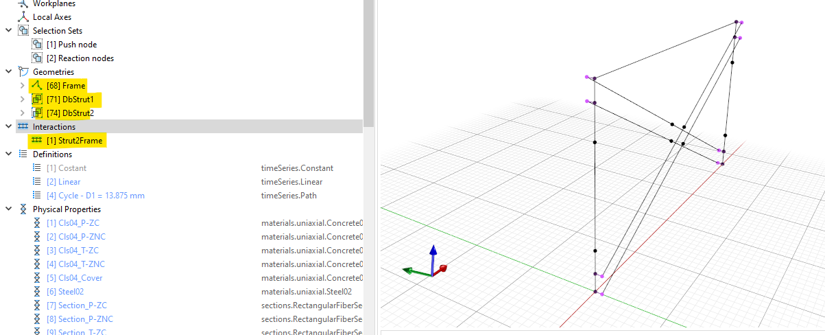

Re: Infilled frame
Check this:
The only option you have is to create 3 geometries.
- Put in a Wire (MakeWire command) all the edges for the frame
- Join all edges of double-truss-1 into a compound (You have 4 edges for each double-strut, first do a makeWire to produce 2 detached edges, then put them into a single geometry with the Make Compound command)
- Do the same for double-truss-2
- Join the frame and the 2 compounds of double-truss using a node-to-node link. In this example I used the vertices of the frame as master and the vertices of the trusses as slave. You can use this interaction with an EqualDOF, attaching the DOFs for which you want continuity
giulio.zanellato
- Posts: 13
- Joined: Thu Oct 10, 2024 12:22 pm
Re: Infilled frame
Ok perfect thanks. I put the equaldof as you told me and now the analysis proceeds.

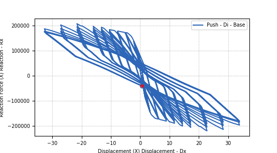

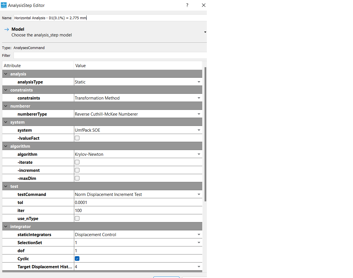

The only point is that the analysis works exclusively with these Analysis settings (see figure 1) and already having experimental and numerical data to compare the hysteretic cycle with I note that the stiffness of the cycles (initial slope of the hysteretic cycle) is quite estimated, but the resistance reaches a peak of 170000 N when in reality it should reach about 350000 N.
Isn't it that using a Krylov-Newton algorithm loses part of the solution?
I tried to put the equaldof both in dx,dy,dz and in dx,dy,dz,Rx,Ry,Rz but it doesn't change the result in terms of resistance.
The model in terms of resistance of the materials and data entered is correct, but unfortunately I don't get the expected results in terms of resistance.
What could be the problem?
