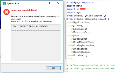

After fixing the error with starting STKO, I encountered the following error when trying to run API Python scripts. I have been running these scripts before with no problem. pip stko is installed. "os" library comes with Python, and it is imported at the beginning of the code, so I am not sure what is wrong.
Screenshot 2024-10-27 215433.png (125.57 KiB) Viewed 3407 times
Please advise.
Re: URGENT: STKO WONT START
Post by STKO Team » Sun Oct 27, 2024 8:42 pm
When following the previous procedure will clear all the search paths of the script editor. Did you put them back? Is the file you are running saved in one of those folders?

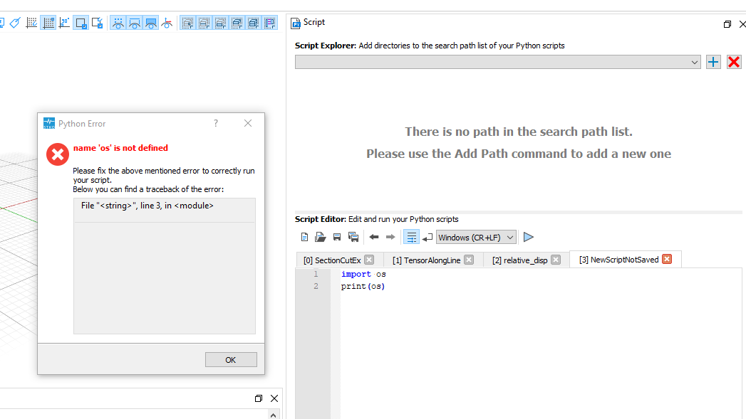

Post by STKO Team » Mon Oct 28, 2024 9:13 am
The only case in which this can happen is when you are trying to run a file from the editor that is not saved to disk.
In this case STKO tries to save it on the active path (among the ones on the script explorer).
If there's no path it cannot save it and the code cannot be run properly.
To replicate this error, I cleaned the search path, I deleted the python file but I didn't close it from the editor. So now the script on the editor is only in memory but not saved on disk:
Did something like this happened to you? Probably you deleted or renamed the folder where the original file was?
