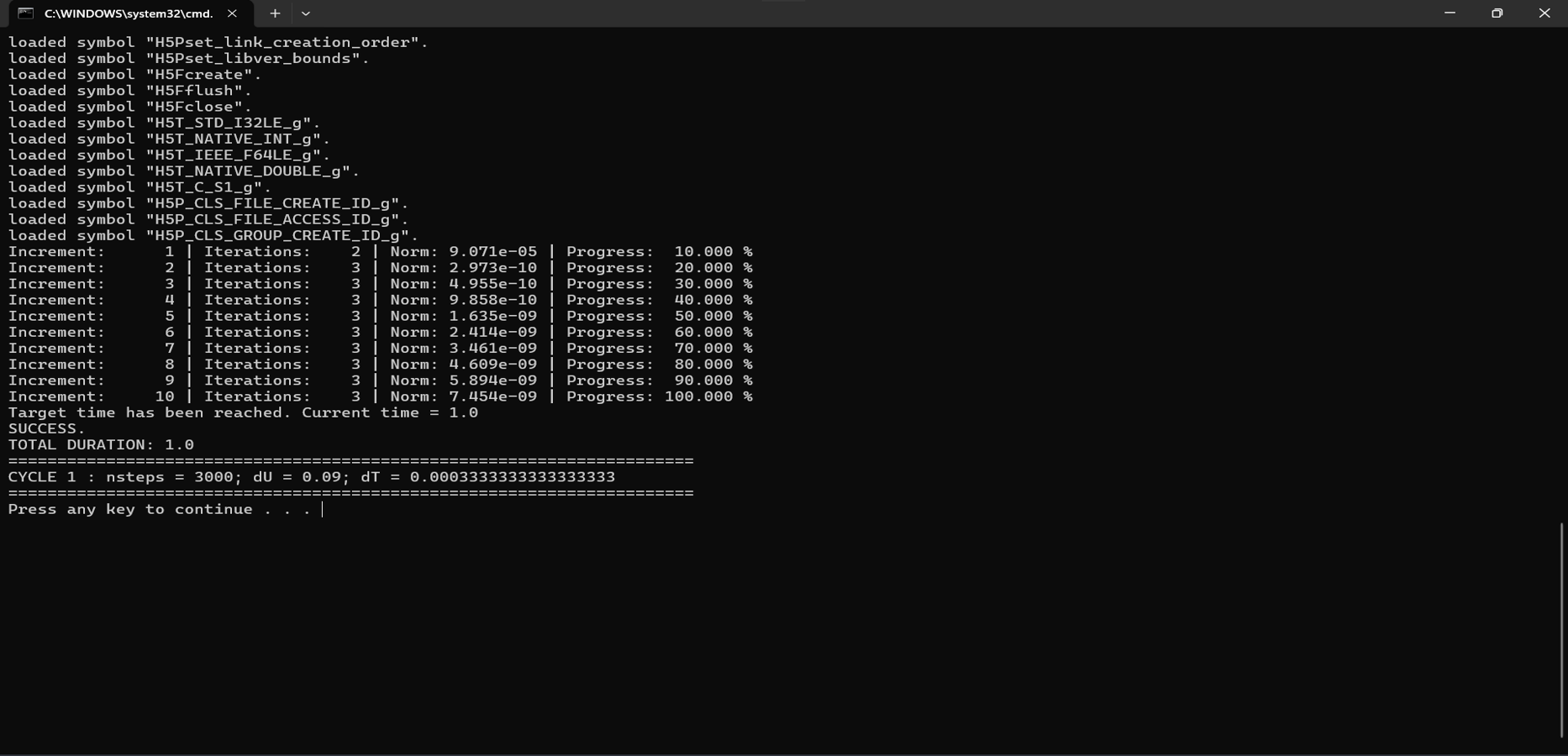

I want to make this model in stko openensees which uses cyclic analysis, I have tried various searches either by one cyclic or by dividing it but I don't get good results, and the results will always be like this, and it takes more than 1 day and takes lots of memory.

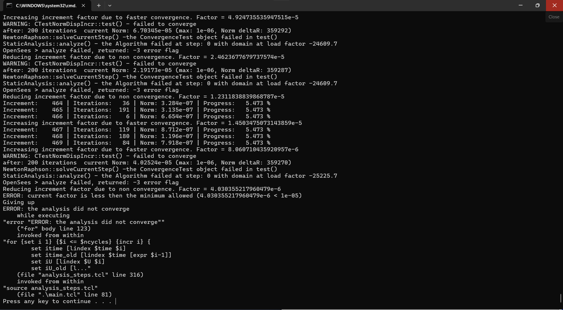

, if I select "cyclic time series" in "tsTag in Cyclic Pattern" it will produce something like this
. Please help, here is my model and the model that I followed to compare the results with the model that I made (comparison modeling in sap2000)

Post by kesavapraba » Thu Apr 18, 2024 9:27 am
Hi, Fiber sections of the beam elements have very fine meshes - this can consume a lot of time to do the analysis. I would suggest you to reduce the number of fibers (limit it to 200-300 fibers maximum in your case). Additionally, you should also look at the assignment of TwoNodeLink element, there is a warning about the orientation of the local. Please ensure the local X axis is oriented as per the intended direction. Further, you can consider using Penalty constraint handler since there are many single and multi-point constraints.
