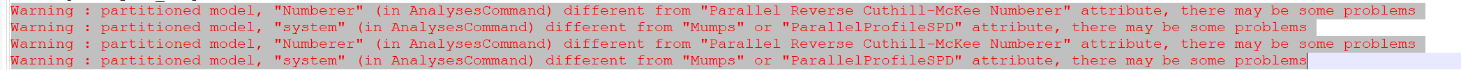

Dear STKO team, STKO terminal display a mistake as the following picture when I try to perform parallel analysis on structures. Can you tell me how to deal with the mistake?

It's telling you that if you are doing a parallel analysis of a large model with openseesMP, you need to use the Parallel Numberer, and the MUMPS system

Oh, thank you very much, I have fixed the problem according to your suggestion.
