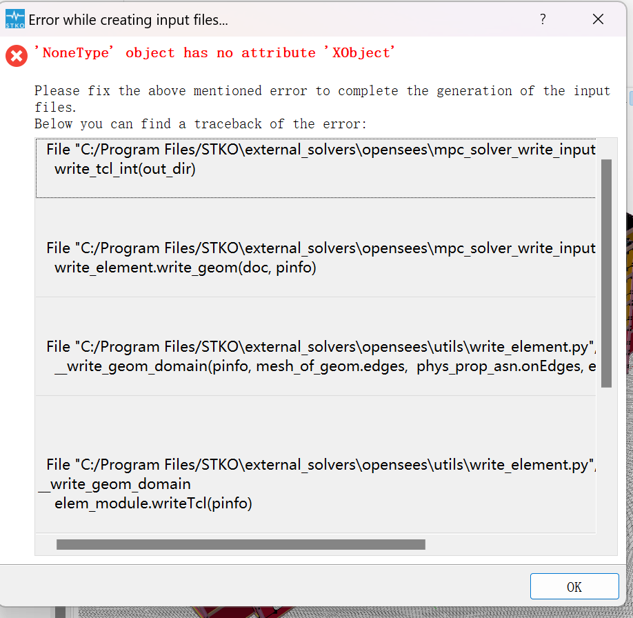

Dear STKO team, can you give me some advice to deal with the problem as the following picture
Re: 'NoneType' object has no attribute 'XObject'
Post by STKO Team » Mon Oct 09, 2023 9:42 am
I need the full error (in your image I cannot see the last lines).
But I'm pretty sure you did not assign a physical property to some geometries

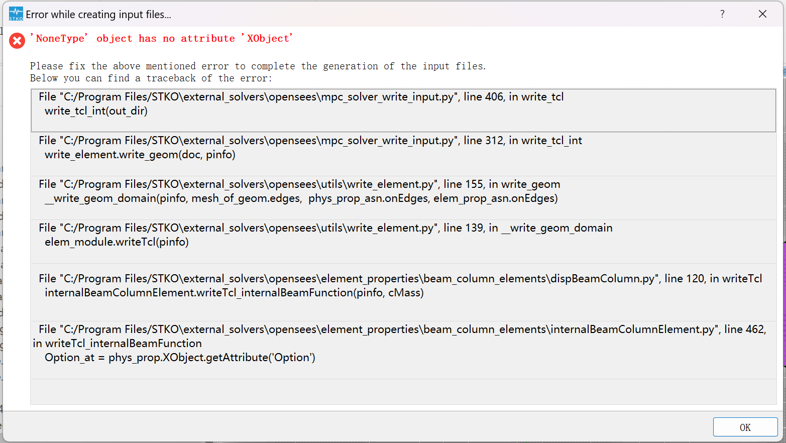

Thank you for your reply, and the information you need is in following picture
Post by STKO Team » Tue Oct 10, 2023 8:09 am
Exactly, as you can see from the last line, one of your beam elements (either disp or foce based) are missing a physical property
