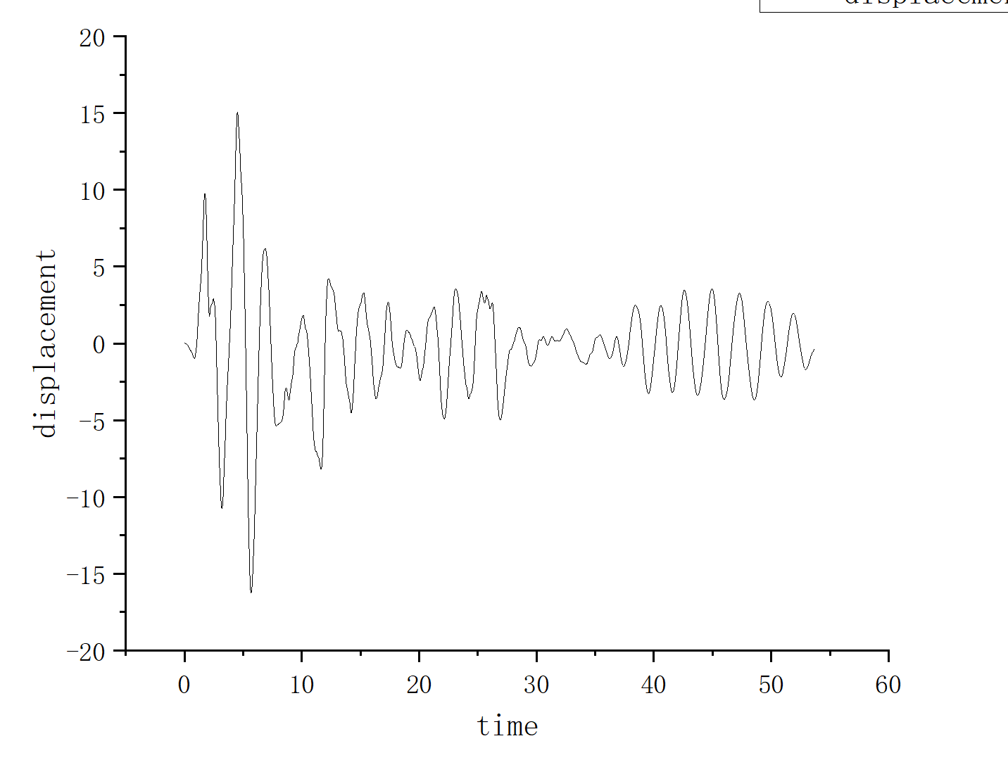

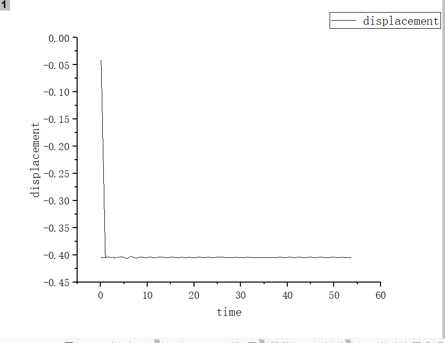

Extract the displacement time history curve of bridge pier top
Post by Gao hw » Sat Jun 10, 2023 9:54 am
Dear STKO
I made an error while extracting the pier top displacement time history curve. The displacement time-history curve of the fourth node in the STKO model is inconsistent with the calculation results in opensees (the picture is in the attachment). May I ask why and how should I modify it?The code calculation results and STKO model are attached.(Only the original model was uploaded because the result file output by STKO was too large)
Best wishes!

Re: Extract the displacement time history curve of bridge pier top
Post by STKO Team » Mon Jun 26, 2023 4:05 pm
They should give you the same results if you built the STKO model correctly (i.e. if it matches the original pure opensees files).
Did you double-check it?
