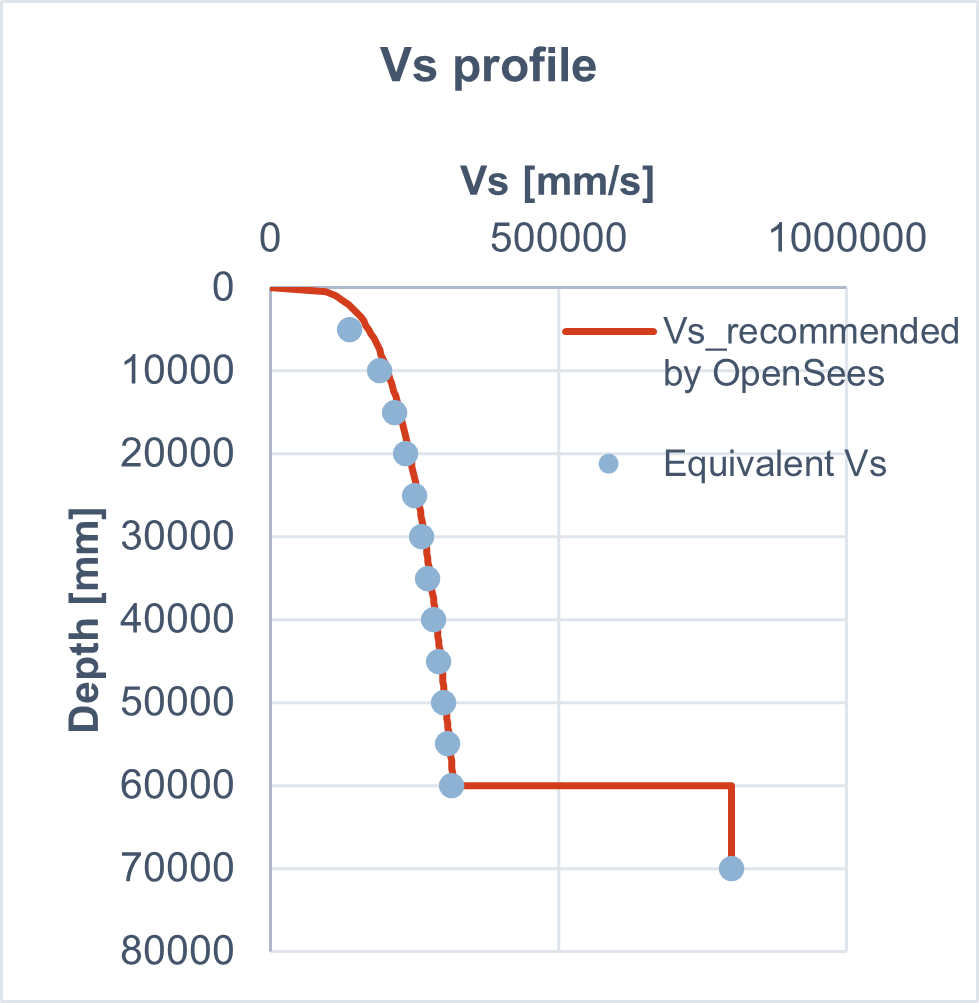

Since both vertical and horizontal stresses (sigma_v and sigma_h) are functions of soil depth, the Gmax increases exponentially with depth. This presents a challenge in accurately reflecting this increase using the ASDAbsorbingBoundary element. To address this, I have approximated the exponential increase process by incorporating multiple equivalent ASDAbsorbingBoundaries along the lateral boundary. I am unsure if this is a reasonable approach, and would appreciate any suggestions you may have. The euqivalent Vs-recommended Vs, as well as the equivalent Gmax and the recommended Gamx profiles are shown below:
Equivalent Vs.png (48.93 KiB) Viewed 2000 times

They way you did it is fine to consider the variation of G due to the initial vertical stress.
However, if you want to address the issue of G changing during the dynamic analysis due to plastic deformation of your soil material, the only way you have is to programmatically update the G moduls of the absorbing boundary using the setParameter command in a custom tcl script (parameter "G" in the absorbing boundary element)
