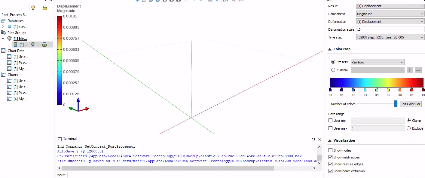

I have been doing youtube exercises from the STKO channel and always had the same problem in the post processor.
The section does not appear for me.
I have selected the beam extrusion command and still nothing.
I have STKO version 3.2.1 and was wondering if this could be an influence since a friend of mine with older version can see the extrusion.
Should I select some specific command on the analysis steps?

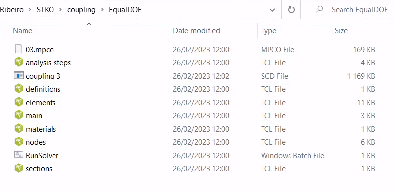

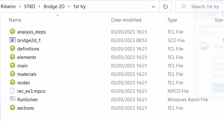

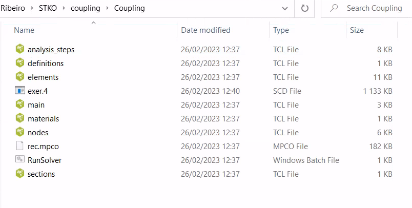

Could you show a screenshot of the folder where you generate the tcl files?
Re: Beam extrusion
Sure! I attached 3 examples of exercises I did.

May I ask you to share your SCD file?
if you use the MPCORecorder analysis step you should have that mpco.cdata file. unless you are creating the mpco recorder manually with a tcl custom command

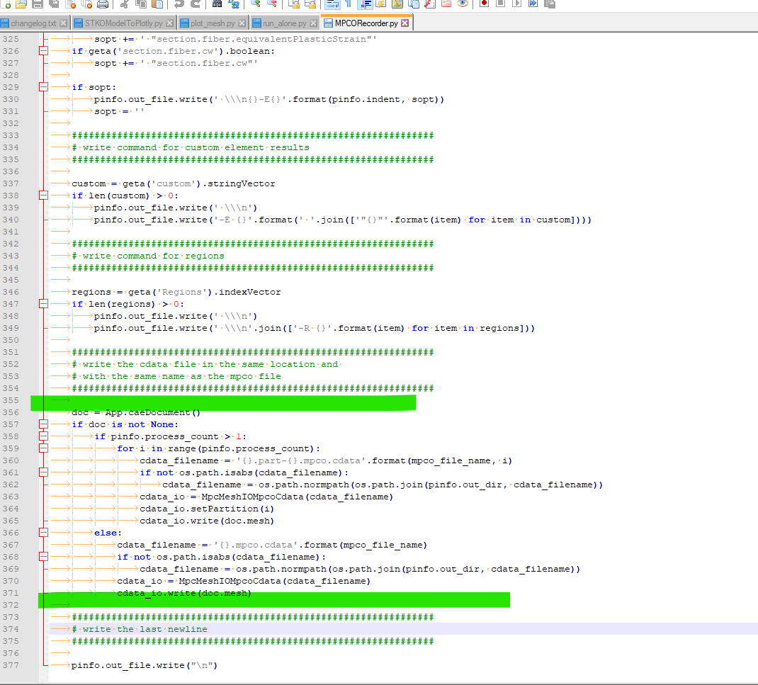

This is the python file that generates the mpco cdata.
It's located in C:\Program Files\STKO\external_solvers\opensees\analysis_steps\Recorders\MPCORecorder.py
Could you verify that at the end of the file you have this?
