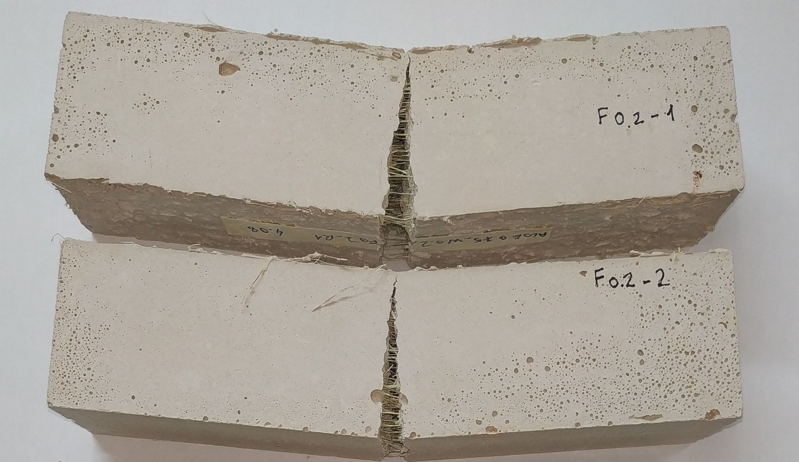

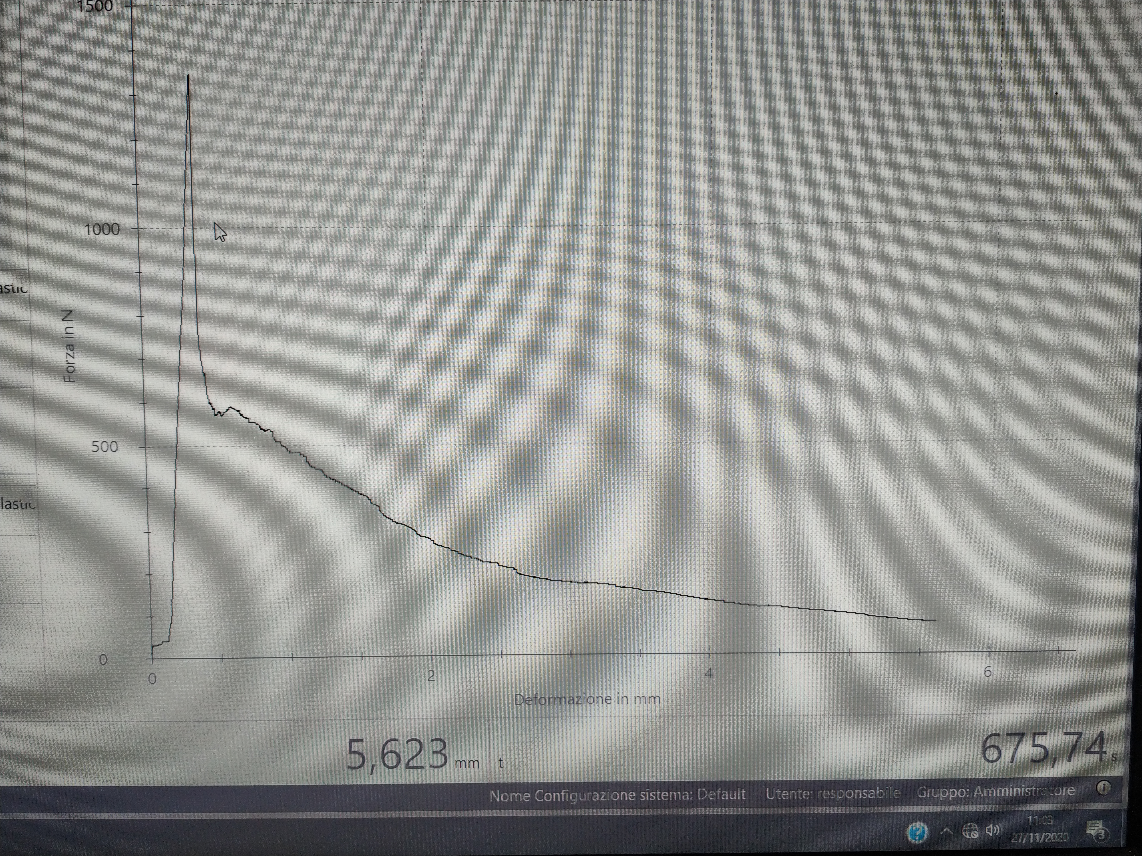

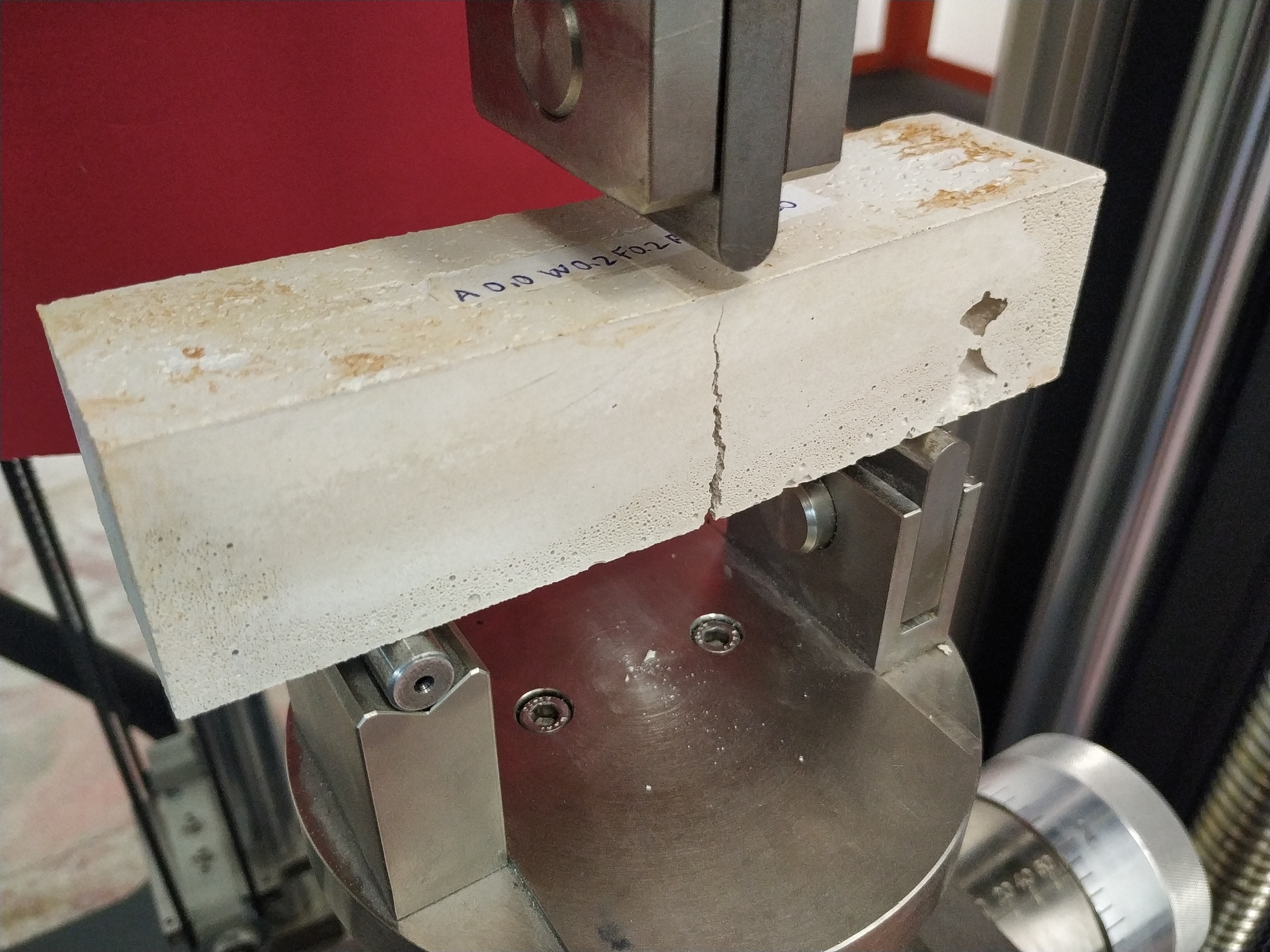

I would interest in simulating 3p bending test of prismatic specimens of 40x40x160 mm dimensions, made of lime-based mortar strengthened with short fibers of different nature: Sisal, PVA, Basalt, glass. The aim is to evaluate the contribution of different fibers on the mechanical properties of the strenghtened mortar using macromodelling approach as first attempt.
Any suggestions are welcome because it is the first time I deal with this kind of modelling.
Please see the attached pictures for further details.

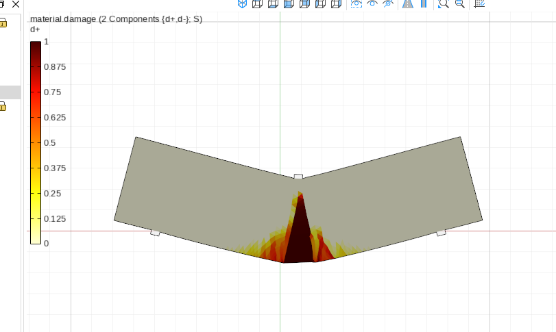

However, here's a simple 2D model of your specimen. I've used the DamageTC3D with material parameters of a random mortar. I set up a monitor with your results as a background.
You can play with the material parameters to understand how it works.
In your case I would play with ft (tensile peak stress) and Gt (tensile fracture energy)
Here's the file: And here's a typical output you will see:

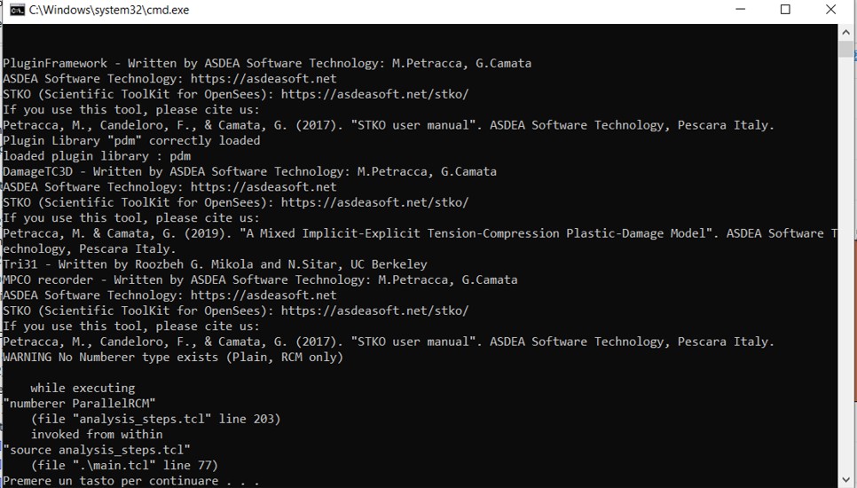

Kind STKO staff,
the analysis does not run. A screenshot of the warning message is attached.
KInd Regards
KInd Regards
- Warning message OS.jpg (126.59 KiB) Viewed 1577 times
Re: three points bending test
It's because it set up the analysis for parallel processing with OpenSeesMP.
You should select the openseesmp solver
