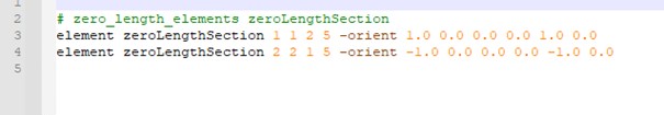

I do not know why the zeroLengthSection element is created twice in my model (we can see it in the output elements),

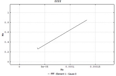

The program performs the calculation but if I do the M-KZ plot (with gauss plot) the moment I have only 1 kNm.
It's because you created 2 overlapping lines into a polyline. In the modified file I corrected it with a single line:

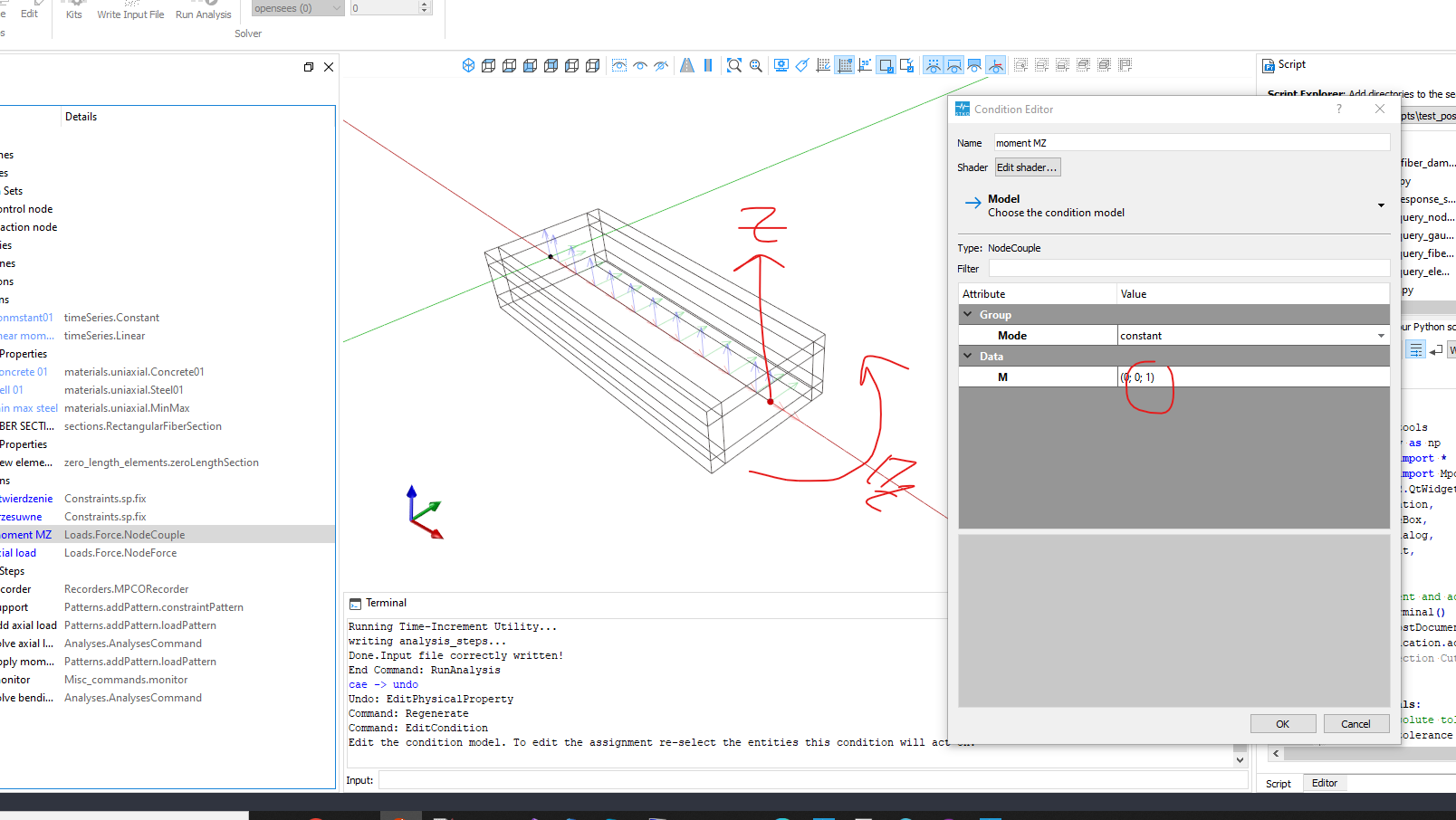

why do I get a higher bending moment (load capacity) for a section with a lower height. In the revised file, the section under consideration is of lower height (0.4x0.2 m), I changed the height with the width to get 0.2x0.4 m . Shouldn't it be in the opposite way?
I attach the results below
Re: Moment Curvature using zeroLengthSection
Post by STKO Team » Fri Sep 30, 2022 7:25 am
In the file I sent you (moment capacity of about 70) the bending moment is acting on the strong direction:
