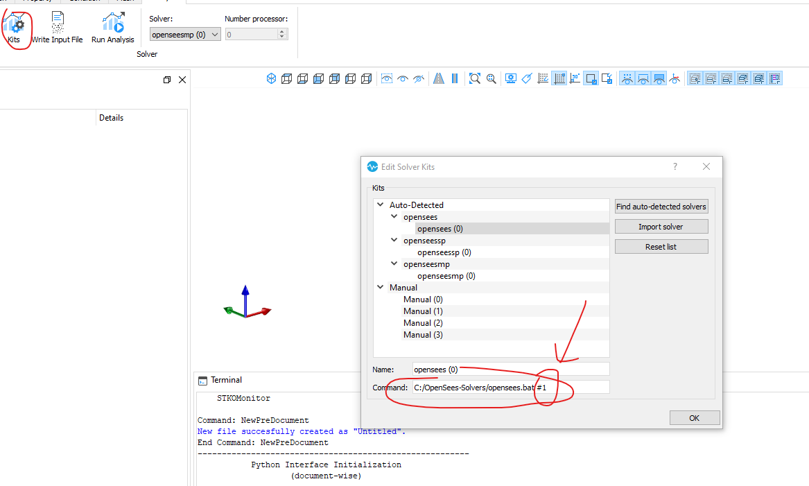

I'm not sure if my installation method is correct. First I put opensees (official version) to C:/OpenSees-solvers, then copy the hdf5 file to C:/OpenSees-solvers. Using STKO to run the model, the file cannot be read, what is the reason?
Re: Damage2p
Posted: Mon Feb 14, 2022 10:03 am
Could you show how you set up the opensees solver kits by clicking on the "Kits" command?
Probably you forgot to use the placeholder for the TCL file name (#1)

by cqf_2232
OK, here's a screenshot of the Kits setup and the file location in OpenSees-Solvers. What is the correct operation?
