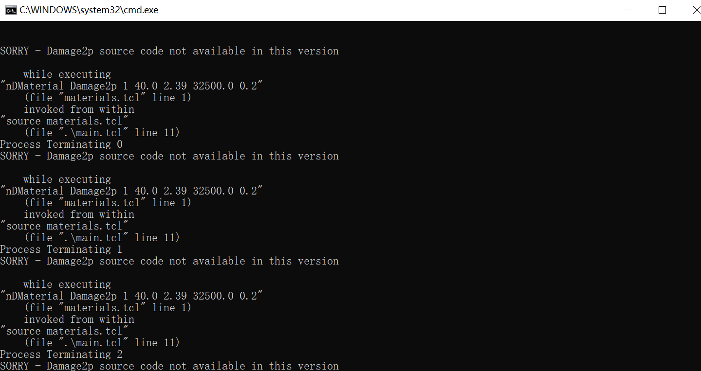

Dear STKO team
I am using the 'Material Test' and an error occurs, what is the reason?In addition, 'Damage2p source code not available in this version' appears when I run the model, is it not supported by the latest version of STKO?
Re: Damage2p
Post by STKO Team » Tue Jan 18, 2022 6:14 pm
It is available only in the latest version of OpenSees (not OpenSeesSP or OpenSeesMP).

Post by cqf_2232 » Fri Jan 28, 2022 4:01 am
Hello, I used the latest OpenSees version (sequential) to run the model, and still prompted that the damage2p material does not exist in this version, am I understanding it wrong?
Re: Damage2p
Post by STKO Team » Fri Jan 28, 2022 2:38 pm
I checked the source code and it looks like they completely removed it from the repository.
You can try others ND material for concrete such as the DamageTC3D

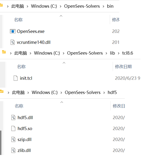

Sorry, for some reason I want to use some ND materials from the opensees official website. I run STKO with opensees (official version), and after I follow the prompts to install it, it always fails to run. Could you please give me a detailed installation procedure for opensees (official version)?
Re: Damage2p
Post by STKO Team » Tue Feb 08, 2022 8:38 am
STKO automatically detects any OpenSees executables in the default folder C:\OpenSees-Solvers.
If you have your own OpenSees.exe somewhere else, you need to tell STKO where to find it, using the Kits command.
The procedure is described in the User manual: https://asdeasoft.net/pdf/STKOUserManual.pdf, at 2.9.4. Solvers.
Let us know if you have issues in following that procedure

I'm not sure if my installation method is correct. First I put opensees (official version) to C:/OpenSees-solvers, then copy the hdf5 file to C:/OpenSees-solvers. Using STKO to run the model, the file cannot be read, what is the reason?
Re: Damage2p
Post by STKO Team » Mon Feb 14, 2022 10:03 am
Could you show how you set up the opensees solver kits by clicking on the "Kits" command?
Probably you forgot to use the placeholder for the TCL file name (#1)

Post by cqf_2232 » Wed Feb 16, 2022 11:47 am
OK, here's a screenshot of the Kits setup and the file location in OpenSees-Solvers. What is the correct operation?
