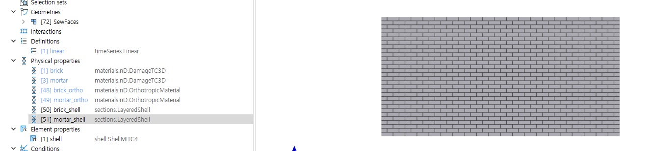

Currently, I am modeling the wall of the masonry and I studied while watching ASEA TEAM's E-learning related to the masonry wall.
Main question is "How to convert a nonlinear isotropic material into an orthotropic material?"
The DamageTC3D model has been applied to bricks and mortar, and I want to convert it into orthotropic material. So I tried applying "materials.nD.OrthotropicMaterial", but the following situation occurred .
How can i convert it into orthotropic material?
- model.jpg (100.84 KiB) Viewed 2537 times
- error.jpg (164.47 KiB) Viewed 2537 times

Re: How to convert a nonlinear isotropic material into an orthotropic material?
This is the model I'm using as a practice example for the analysis of the masonry wall.
- r_0.5_ortho.zip
- (1.4 MiB) Downloaded 178 times
In the model you sent there is no orthotropic material, can you send me the model that generates that error?
Dear C=MK,
sorry for the late response.
To input the orthotropic material in the LayeredShell you need to create a PlateFiber material referencing your orthotropic one, to then reference that in the LayeredShell. It's just an extra step, not a PlateFiber section, just a material.
Let me know if it works.
Francesca
