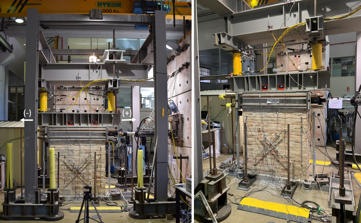

The papers are currently under review. The experimental test I want to model is the one I did on masonry walls retrofitted with TRM. Currently, I want to calibrate the URM masonry wall. I can tell you how the loads were applied. It was intended a double fixed BC but in the laboratory this is not always 100% achievable.
During construction, the samples were laid on a metallic C-profile filled with concrete. In addition, the base was constrained at both ends by two T-shape devices. Both the base and the end devices were fixed to the strong floor of the laboratory by means of post-tensioned steel bars. On top of the wall a reinforced concrete (RC) beam was placed. On top of the RC beam laid a stiff metallic H prole stiffened with ribs, where the vertical load was applied with two jacks of 1000 kN capacity each. The jacks reacted against a stiff frame anchored to the strong floor. Between the RC beam and metallic prole, a 3 mm thick Teflon sheet and a 3 mm thick PVC sheet was inserted to provide a smooth horizontal surface to reduce the friction transfer of the horizontal load to the RC beam. Between the RC beam and the PVC sheet a layer of cement-based mortar, with thickness of 5 to 10 mm, was inserted in order to level the end surface of the beam and guarantee the vertical load transfer avoiding stress concentration due to irregularities.
The shear compression tests were performed in two steps. Firstly, the vertical force was gradually applied under force control. The valves of the jacks were closed once the designed compression stress was reached (Sigma=0.3 MPa).
Secondly, the horizontal shear force was applied with a hydraulic actuator anchored to a reaction wall. With the valves of the vertical actuators closed, no displacement or rotation of the top of the wall was possible at this stage and applying horizontal load induced a double bending condition. As a consequence of the testing mode, the vertical load increased together with the horizontal load.
See attached a picture of the experimetnal set-up
Is there any way I can enhance the bc I'm currently using in my model to represent the behavior previously described?

- FSETUP.png (3.79 MiB) Viewed 4623 times
