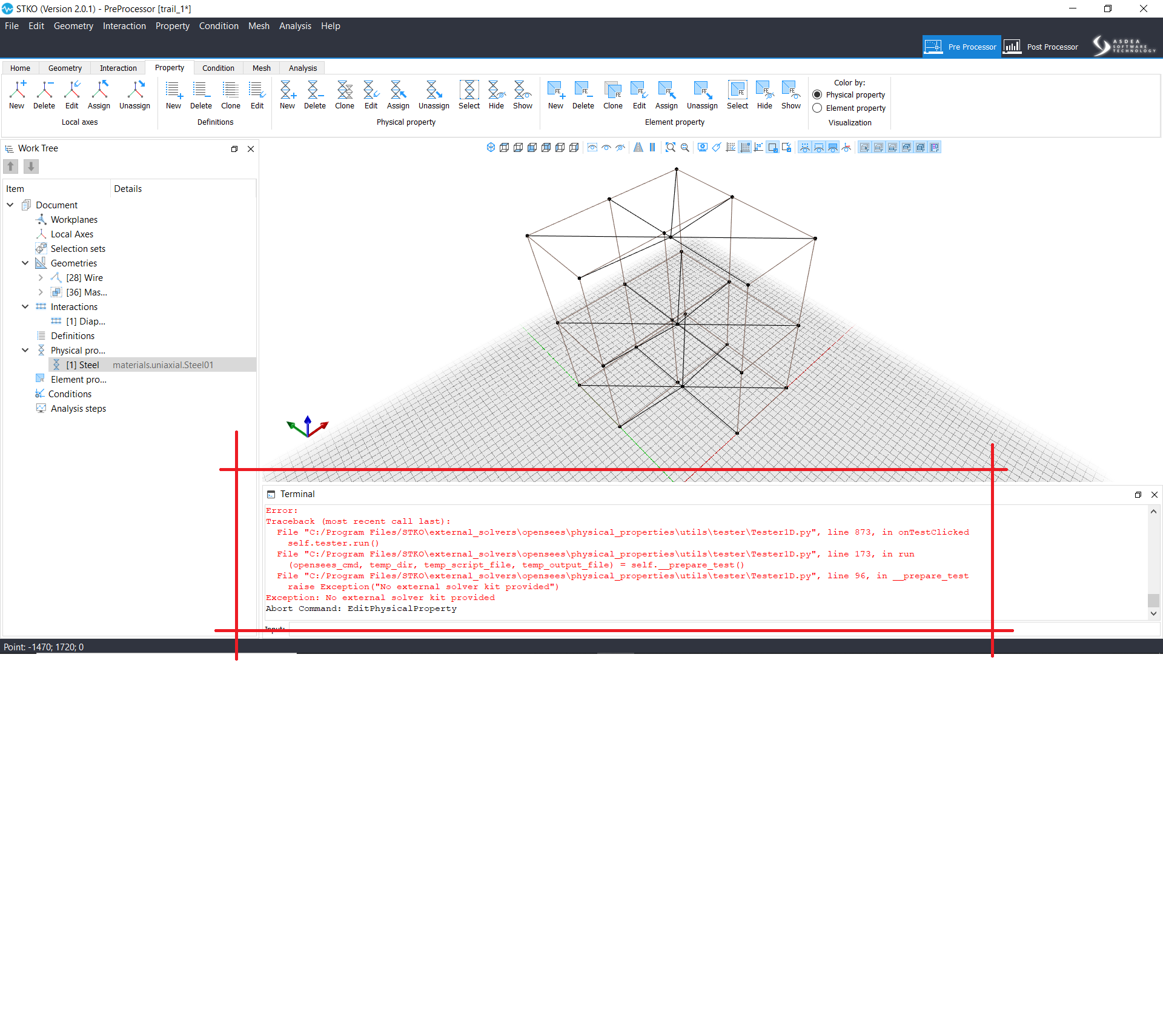

I downloaded the external solver OpenSees 3.2.2 then also I'm not able to fetch the Stress-Strain curve of the material Steel01.
Highlighted red Box in the attached image is the error I'm getting.
Please Help.
Thanks in advance!
Parag
Error of no external solver kit provided

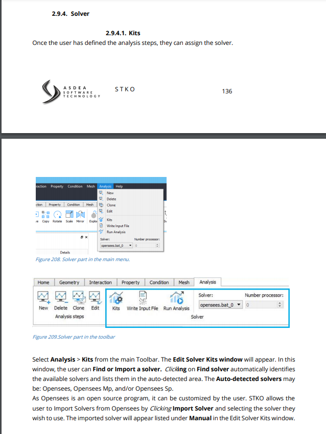

Dear Parag,
Did you Install OpenSees in the folder C:\OpenSees-Solvers (Default location)? If so, STKO should automatically detect them.
Otherwise, the STKO user manual briefly explains how to import your solvers as shown in the screenshot attached. Let me know if either of these solutions helps.
- gjnfhmidnoenjhil.png (144.01 KiB) Viewed 1556 times
