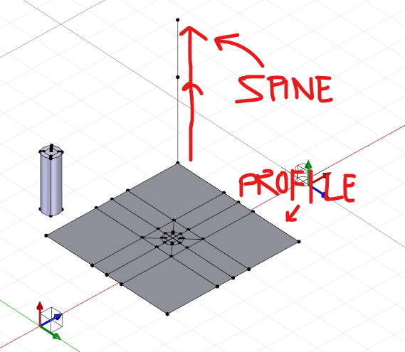

When you were drawing your line sketch at the base, you should have included an extra cross in the middle
When you have your sketch ready, you can use PlanarFace to get a shell out of it.

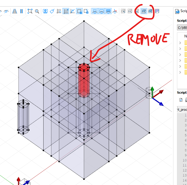

Then you can draw a polyline (wire) made of 2 edges, each with the required length such that the mid-face is at the Z-level of the soil volumes you want to remove. This is necessary to obtain inner faces (in your previous model the outer faces were extruded in 1 segment, but merged with the inner ones (2 segments in the Z direction) would create non-6-sided volumes.
With these, you can use the Sweep command, which is an extrusion along a spine:
Finally, you can go in solid-only subselection, select the volumes you want to remove, and press Delete.

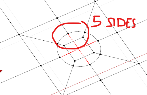

It happens because some of the base faces have 5 sides! faces mush have 4 sides, and volumes must have 6 sides for hexa meshing.I am trying to mesh my SSI model using a hexagonal mesh, however whenever I merge two solids, STKO refuses to mesh the model using structured hex mesh and it switches to tet mesh.
