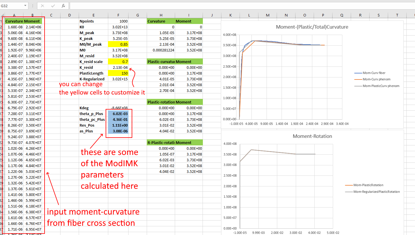

Here is a sample file where you have a beam-with-hinges using a finite length plastic hinge that uses a fiber cross section. It is compared with a lumped-plasticity beam with zero-length hinges using ModIKM uniaxial materials for moment rotations.
plastic_hinge_from_MK.zip
(165.46 KiB) Downloaded 397 times
I used this Excel file to calibrate the moment-rotation response and the main material parameters of the ModIKM law starting from the moment-curvature response obtained from the bottom-section of the first beam
calculation.zip
(52.96 KiB) Downloaded 424 times
Immagine 2020-12-03 154137.png (129.11 KiB) Viewed 6059 times

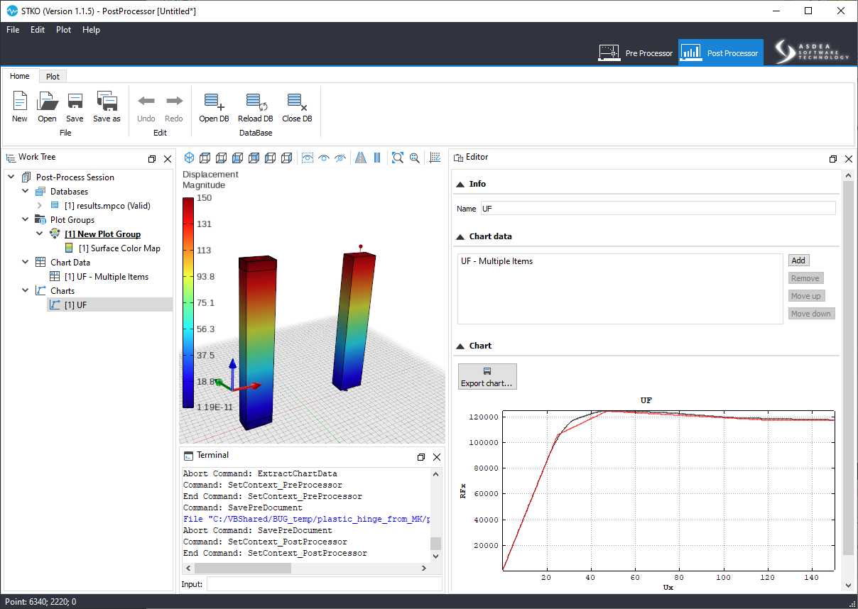

And this is the Ux-Fx curve of the 2 columns compared, as you can see they match really well:
Immagine 2020-12-03 154138.png (158.22 KiB) Viewed 6059 times
