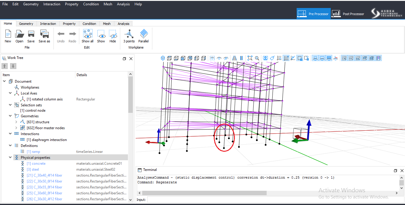

ok i got how to do the Moment-curvature analysis. But at least can you tell me that in the picture below for that column what axial force and moment shall I use to get Moment-curvature for this column so that I use it to determine other parameters of ModiMKPinching.
- project1.png (151.52 KiB) Viewed 5348 times
Re: Moment-Rotation Relationship
Dear ankurjain1992,
I suggest to use the axial load of the columns at the end of the gravity load, just before applying the horizontal load.
Regards
Regards
Thank you for the reply .
What about the Moment ?
Shall I apply unit moment or moment also we take from the end of gravity load?
And that moment should be Mx, My or Mz ?
As we change the moment value, moment-curvature curve values change drastically.
Moment is calculated with the axial load using the interaction diagram. The axes are those of the element as defined in the manual
