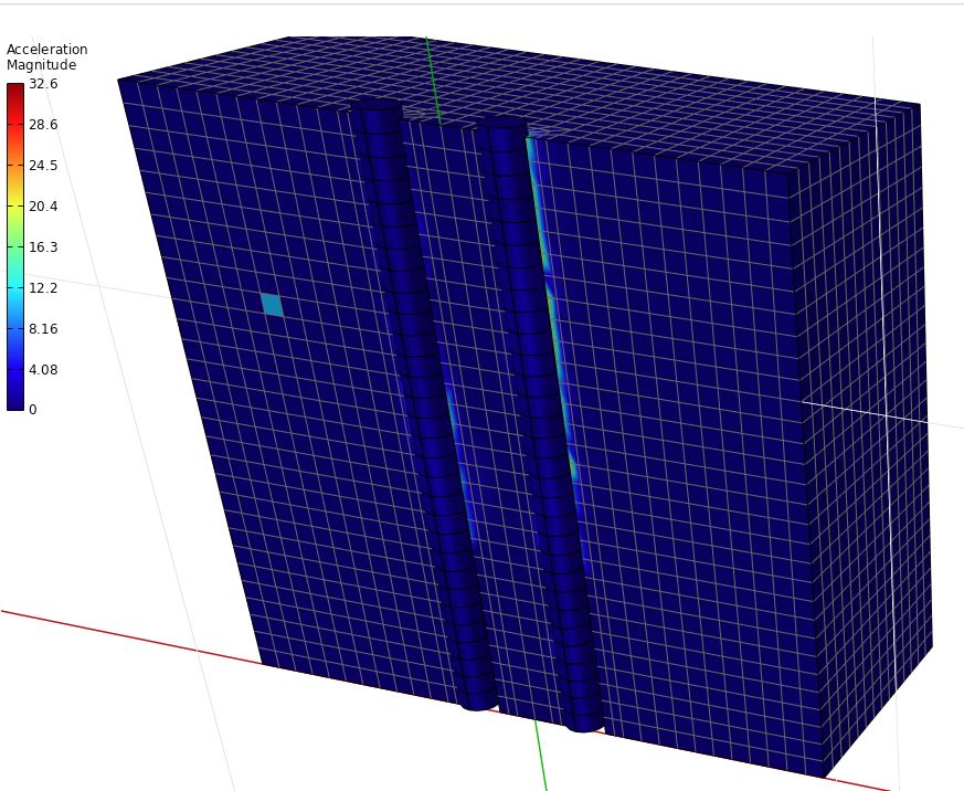

1) Issues with small (!) time step in implicit integration scheme.
I have a pile-soil model (based on your example, but with absorbing boundaries), where the interaction is modeled with the ContactBeam3D elements. Load is applied at the pile top.
Static analysis works well.
When I run my model using a implicit time scheme with a time step of 0.005 s (Modified newton, TRBDF2), it seems to produce fairly good results. When I decease the time step to 0.0005 s, the nodes corresponding to solid elements that are in contact get very large and very noisy deformations, but the deformations in all other nodes in model, including the beams (piles), remain seemingly reasonable.
I have tried both time steps for a variety of soil and beam stiffness's (elastic), and the same thing happens, i.e. good results for dt 0.005 s and large and noisy results for dt 0.0005 s.
As far as I can see, the literature is pretty consistent with the fact that contact problems should benefit from small time steps due to the high non-linearity of the contact formulation (implicit schemes included). This is also very logical to me, and thus my problem is seems somewhat strange.
Am I missing something obvious here, and is there a logical explanation to why this occurs?
NB! In order to decrease the non-linearity that occurs from contact, I decreased the stiffness parameter G by a factor of 10 in ConctacMaterial3D. The idea was to prolonged the elastic stick and thus smooth out some of the non-linearity. It did not help. I also tried increase G just to see what happened, and the results got even worse, which I guess was to expect.

I have also noticed noise at the end of the analysis (regardless of the time step). Some time after the dynamic loading stops and everything is damped out, some substantial acceleration and velocity values can be seen at some of the solid elements connected to the slave nodes. See screenshot below.
I am sorry to bother you with these issues since this is not an STKO-problem. I am not expecting this to solved here, but any comment or tip is very much appropriated.
