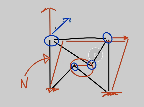

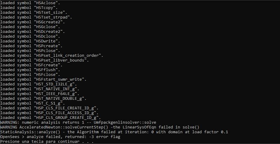

hi, I have some issues for the interaction in two nodes and the behavior send error, and i put Saw materials, and also Twonodeslink for the section in the central nodes; but opensees continue give me error. the analysis don't run
Does somebody know how I can work with these nodes? I try in 3D but I have more error because I need more restrictions for the Z coordinates; and finally I try in 2D but... I have the last errors...
Re: interaction between two nodes
Post by STKO Team » Fri May 22, 2020 11:09 am
Dear user,

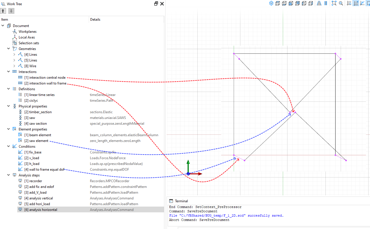

We just sent you an e-mail with a corrected SCD file for your 2D model. Here is just a sketch of how it should be done:
