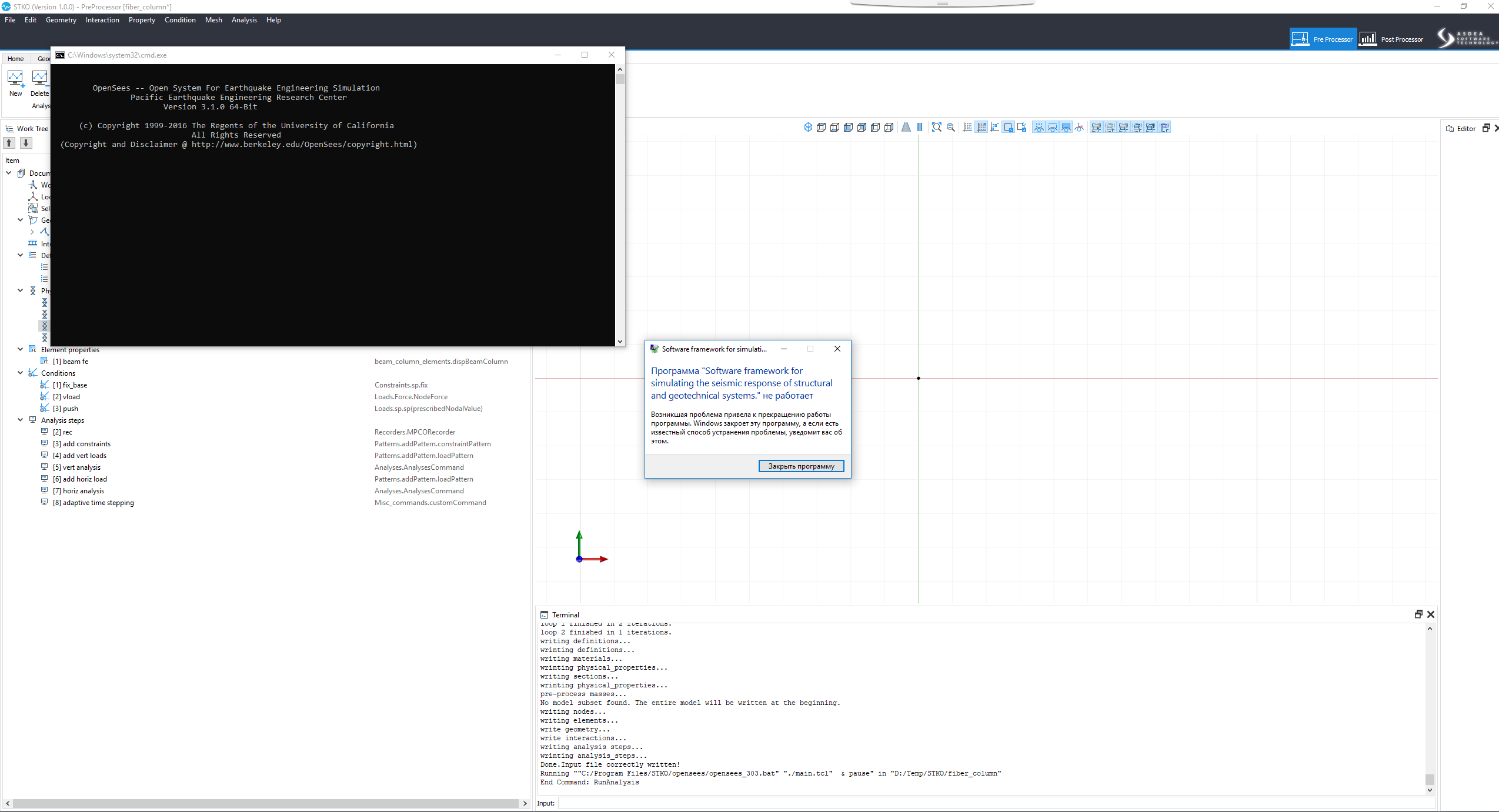

Hello!
I have a problem with analysis of fiber beam elements. When I perform a simple beam bending test and add a fiber section in the section tree I get an error error when I run the solver (figure below). This takes place even without the fiber section assignment (This means that the fiber section is only in the section tree and it is not assigned to any element. In that case a simple section is assigned to the beam elements and worked well before fiber section was added). What can be the reason of that? How can I fix it?

It is a crash in OpenSEES. Unfortunately there is no error message. Can you please post your *.SCD here so that we can have a look?

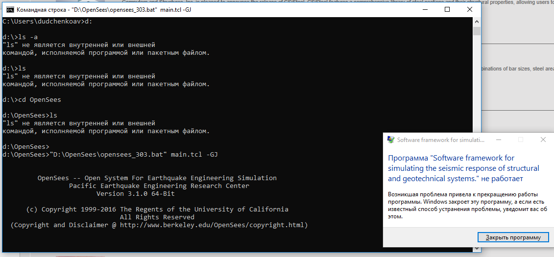

unfortunately, using additional option in command line has not resolved the problem. So, I will wait till the compilation on the new version of OpenSees solver.

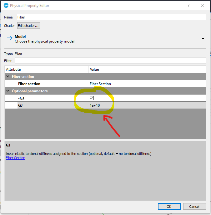

Dear User, the -GJ Option is not something that you should pass to the command line.
It is the optional linear torsional behavior of the cross section(G (shear modulus) * J (torsional constant)).
Please, edit the fiber cross section and do this:

thanks a lot. Now it works. Actually, I used command line only to test. Usually, I run solver from STKO GUI.
