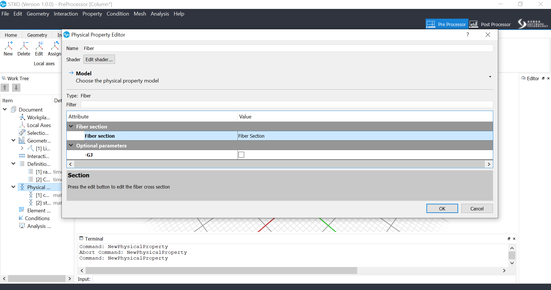

1. An issue in the Fiber section. No new window gets opened after clicking on the fiber for drawing the custom fiber section rather using the option of “Rectangular Fiber section”.
2. Option “RectangularFiber Section” is not available here as was available in the webinar session.
Screenshots from webinar along with screenshots of my STKO window are attached.

As for the material test window, also this feature is available in the first official release. In the Beta version you only have the custom fiber section.
There you should first click with the left-mouse-button in the first cell on the right ("Value" column of "Fiber section" attribute), then on the right-most part of the cell, a button with "..." (3 dots) will appear. Click it to open the fiber section builder window.
