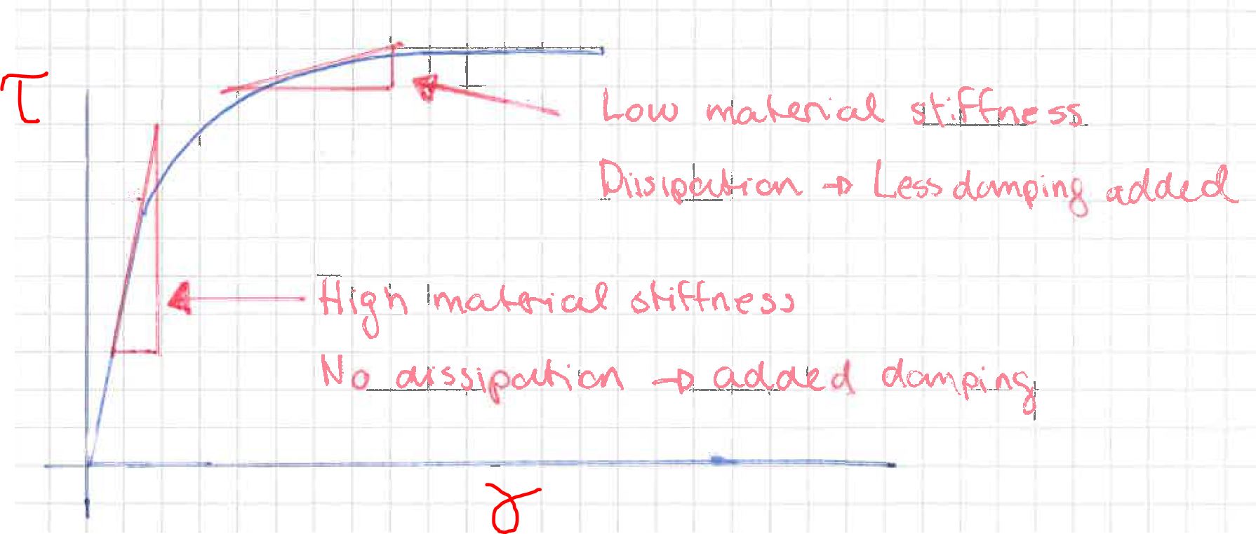

Assuming that you are using some kind of non-linear model for the soil, are you adding any additional material damping?
I have a model that seemingly works fine, but I am not sure if I am adding sufficient or to much damping. This is somewhat important in my case since I am comparing linear and non-linear solutions. I am using the PIMY-model (clay) and I have layered the domain such that I can incorporate the effect from compaction on shear strength and stiffness (i.e. the stiffness increases linearly with depth).
The best solution that I can think of for now is to add purely stiffness-proportional damping using the Rayleigh command. That way I can add more damping when the response is linear, and less damping when the response in non-linear and we have dissipation. Note that I am applying harmonic loading such that I have one particular value for each frequency.
Any tips, advice or references on how to add/estimate proportional damping would be much apricated!

Initially, I was thinking exactly what you write. Since I am using the PIMY-model in a 3D-domain, the main damping effects, i.e. hysteric damping and radiation damping are accounted for.
At initial high stiffness (small loads) the damping is very low and it increases as the shear strain grows according to the G/Gmax curve which is equivalent to the backbone curve.
The reason why I am considering added material damping is actually what you mention above. Talking to some fellow collogues in geotechnics (I am a structural engineer) and a previous course in geodynamics, I got the impression that field test usually show non-negligible damping even for small strains. This is also briefly discussed in the overview that you posted (section 2.4.1 and 2.4.2).
I am applying a harmonic base displacement to a pile-soil model and evaluating the results in the frequency domain. Results show that the soil response in the upper part of the domain becomes more and more linear as the frequency increases (as expected). Therefore, I was concerned that the system might be somewhat underdamped for high frequency loading. Therefore, by adding purely stiffness proportional damping, I am able to add more damping in the linear domain and less damping in the non-linear domain. I found a recent article (https://www.sciencedirect.com/science/a ... 4AU5l9FHJA) where stiffness-proportional damping was added using the PDMY02 model, but this is not discussed in detail.
I am by no means an expert on the subject, so please correct me if I have misunderstood something. Regardless, I will run a few analysis with and without to see if there are any substantial differences.
Yes, I also mentioned that low strain (i.e. high freq. motion) is underdamped and high strain (i.e. low frequency motion) is overdamped. However, this is only an issue when the contributions from the high frequency components are characteristic to your problem. In most cases the consequence of underdamped high frequency waves is small in the overall damage of the soil or soil-pile system. This may be different for machine foundations, for example, and other fatigue prone self-exciting structures such as wind turbines.
All in all, if your goal is to have an extremely high-fidelity soil model or the contribution of high frequency motions is significant to your problem you may add extra stiffness proportional damping.
If this is done correctly it can counteract underdamping of high frequency motions for sure. But you need exact experimental results and perform FEM model updating in order to optimize this additional damping in a way that it is realistic and physically robust. Handling the overdamping of low frequencey motion is not that easy to solve though, as that would need "negative damping". I do not have any good ideas for that myself.
