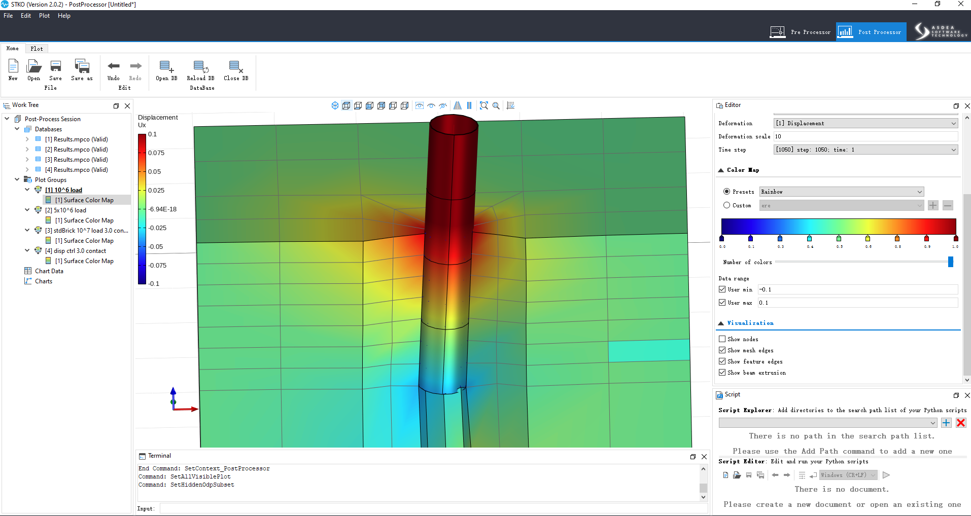

Re: Pile-soil Interaction Convergence
Thank you kindly for the suggestions and the example file. I have a few questions and follow up issues.
1) I see you suggested me to use Krylov-Newton method, while on another occasion I have been suggested to always use Newton with line search for contact problems. Is there a way to predict which would be better algorithm or it's just a conclusion based on trial and error?
2) Can you explain why the increase of pile diameter is necessary in the BeamEndContact3dp element? I understand that due to the meshing of the circular diameter the nominal size might not be enough to create a contact on the side for the BeamContact3dp element, however I do not understand why this would be the case for the BeamEndContact3dp element where the end of the pile is flush with the soil.
3) Just to confirm, the use of plain constrain handles is okay for the analysis even though we have contact constrains because the contact is a zero length element/material which is connected using a homogeneous and identity constraint (in this case EDOF)?
4) If I try to scale the mesh (densify) or change it in any way my model will not run. It stops without warning after the initial stage analysis is turned off with the prompt: "press any key to continue". This has happened to me on several occasions before with other models as well. Sometimes redrawing the geometry from scratch resolved the issue but not in this case. I have attached a refined mesh model for reference.
5) Based on the model you attached I updated mine and it converged. The only thing I had to modify is to use standard brick element because when I remove the elements from the pile's volume the SSP element will retain considerable residual displacements however, stdBrick does not (just an FYI as it might be useful tip for other forum users).
However, from the results I see that the pile does not exhibit gapping even though 0 cohesion and 0 tension strength was specified for the contact material and the pile displaces sufficiently to exhibit gapping. (attached picture you can see the displacements in the loading direction. What may cause this error?
Thank you very much for your time in advance!
Yes, the TCL custom script that I gave you works for sequential analyses, and it should be changed for parallel analyses. However, the required changes are quite difficult to be explained here (it requires a lot of additional code to make the processes communicate information about removal).It works well for gravity analysis, however, when I try to remove the solid elements (within the pile volume) the solver crashes with the attached error message. I assume the message passing between sub-domains is not set up for analyses such as element removal. I also can not control the partitioning in STKO (to put all to be removed elements and their neighbors in one partition to avoid this issue). How can this issue be bridged to enable parallel computing of my model?
But don't worry, we will implement a built-in tool in STKO version 2.0.3 (will be released soon before the next webinar, 20th of May). It will be the counter-part of the addModelSubset (a removeModelSubset) and it will automatically take care of the parallel case.
In the meantime, if you cannot wait until the 20th of May, you can "somehow" control the way STKO does the partitioning. For example, if you want to make sure the entire solid part that should be removed (call it SOLID_A), be on 1 process, you can add a dummy interaction (do not assign any condition to it) that connects 1 vertex of SOLID_A to the whole SOLID_A, using the interaction type "General Link".
It should be enough to ensure that the whole SOLID_A be on a single process. Then, when you do your partition, you can visualize the partition SOLID_A belongs to, and you can add an if-statement to make sure the removal happens only on that process.
