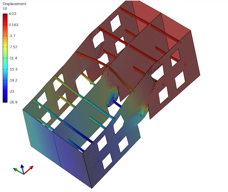

Always try to look at the post-processor. Look what is happening to your model when you have a convergence problem. You can also increase the scale in some cases to see it better. Now I can see that by applying settlements you have a failure of walls and the beams under the doors. Is it what you expected?

Thank you, will watch the webinar, I am aiming to do change soil properties during settlement to investigate the effect. I have alterted my model, as I do not want to see failure that early at an opening, in my new model however I still see convergence issues very quickly, when looking at the post processor it appears that the largest damage is seen above the window openings, but it does not look enough to fail and cause convergence issues.
I also am confused, as when imposing the displacement on the wall even though only 7 percent of the duration can run, the displacments are much greater than I would expect (80mm vs 7 percent of 100 mm), am I misunderstanding how the displacment is imposed or is there an error with the model.

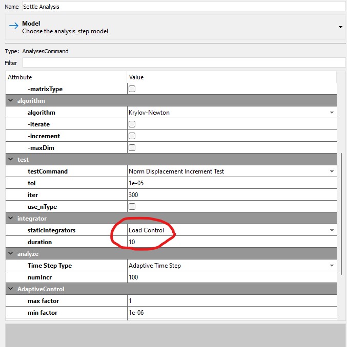

You are using a load control integrator with a duration of 10 and a linear time series from 0 to 1. In this case, your U=Uref*lamda(t) is ten times your prescribed displacement. This is the reason you obtained so high displacements. Or use 1 for the duration or scale your time series to 0.1.

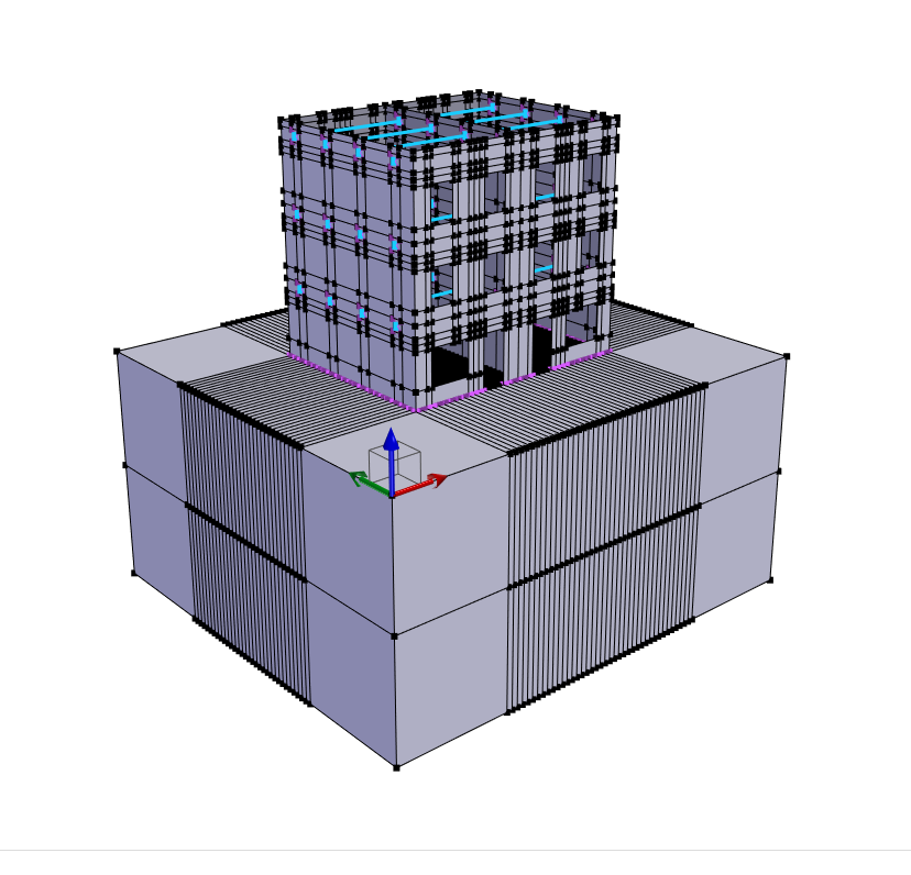

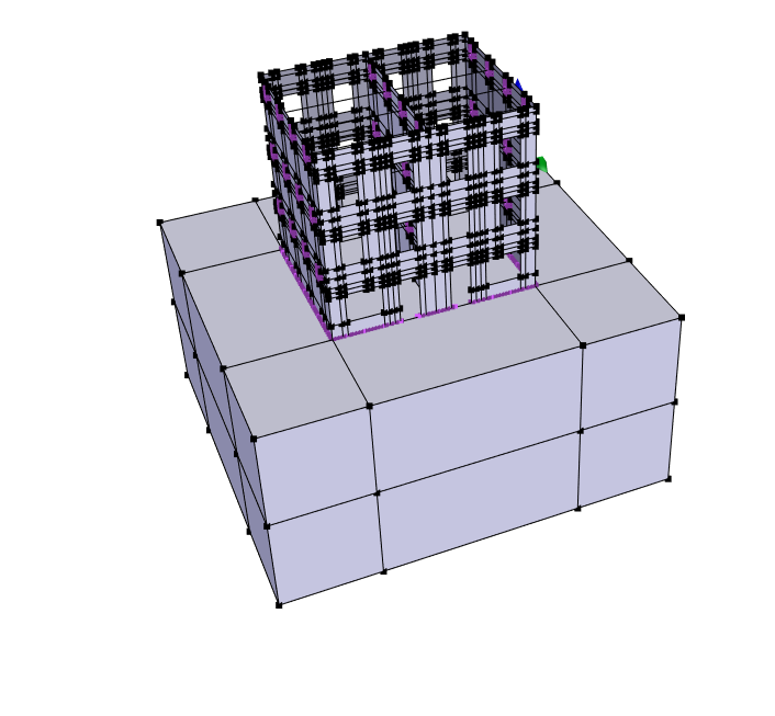

I have a further question, when making an interaction between two objects, for example this building and a soil domain, must the geometry nodes line up so that the elements have the correct number of nodes, or can they be considered as two distinct objects.
I am also trying to vary the values for soil properties along the x axis, I am currently discretising a linearly increasing youngs modulas along the x axis by cutting up my soil model into smaller soil blocks, this has the unforunate effect of drastically increasing the compelxity of the model so it takes much longer to run which is a problem for my computer. Is there a better method for approachingt this that you might know about, or is simply reducing the number of discretized steps the only approach to reduce computational cost.
It depends on the interaction that you use. In this case, you are using a contact element, so you need to have an aligned mesh, I mean you need to discretize your soli. Also if you have a very coarse mesh of the soil in the zone of interest it is probably not good for your analysis.
To reduce the computational cost you can try to discretize a small volume of your soli and connect it with embed element to the rest of the soil. Give a look at this part of the webinar.
