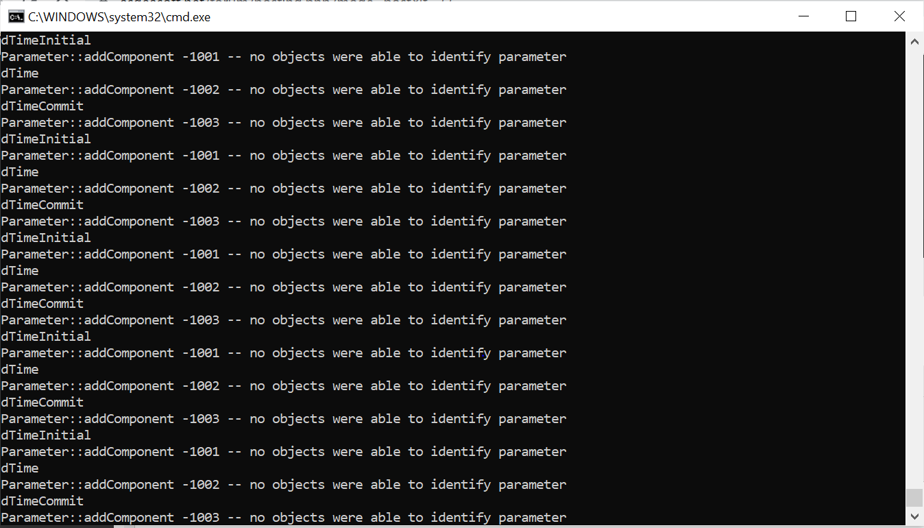

I am relativly new to STKO and am trying to model the response of a masonry building to settlement. I am having several problems with the analysis. When running the analysis, the prompt displays "Parameter: add component - 1001 - - no objects were able to identify parameter dTime", a screenshot of the prompt is attatched. Additionally when the data file is saved as a CDATA file rather than MPCO file, and so I can't open it, however I expect that this issue relates to the first.

That error means that you are using a newer version of STKO with an old version of OpenSees.
Please update both STKO to version 3.2.1 and the OpenSees-Solvers.

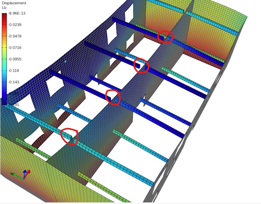

I have added beams to the model, using a rigid link interaction between the walls and the beams, however It will not converge and i am not quite sure how to amend the issue in the design.

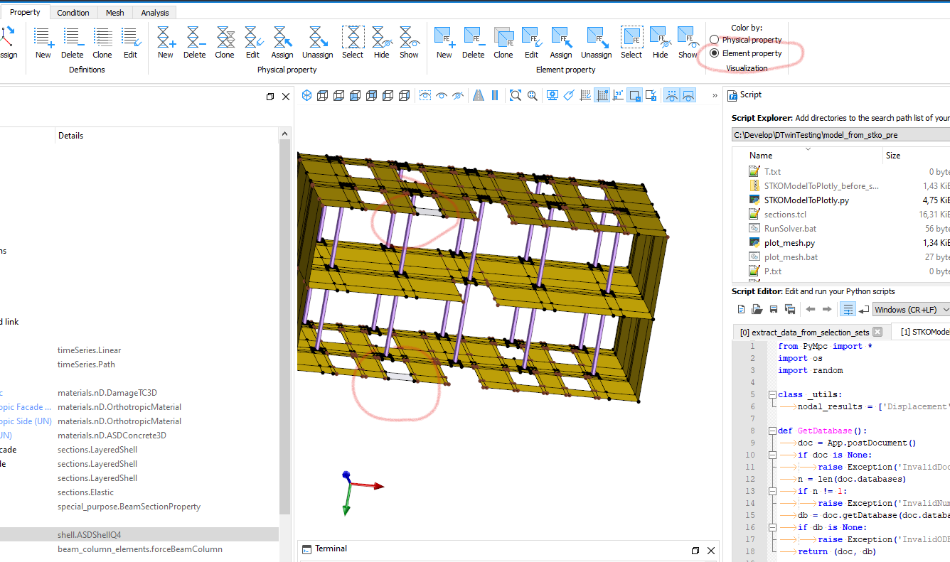

It's singular, some faces don't have an element property:

I appear to have attatched a slightly older save as in the version where the model does not converge all of the model has an element assigned to it, the issue arises in the second analysis step.

Hi LJC,
I can see the problem with the beams in the middle, the rigid link doesn't work there.
You have two nodes from both sides that govern your shell element. So I have merged your beams, so there will be one node only. Now your second analysis can converge.
Another thing is to check your parameters for timber sections, they do not seem reasonable to me (E, G)
