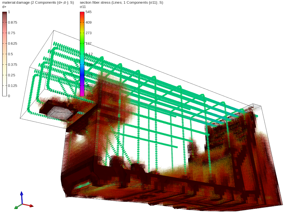

Dear Mari,
Horace and I modified your model. Attached the version with the structured mesh and modified bc. We hope this is useful.
HH and C
Re: Load-displacement curve
Posted: Fri May 21, 2021 1:11 pm
by Clarabella
These are the results. We think that there is a problem with the support.
Posted: Fri May 21, 2021 3:12 pm
You can also make a finer mesh to visualize better the crack pattern:
Posted: Fri May 21, 2021 3:22 pm
by Horace Horsecollar
Cool picture! It is quite evident that the problem is how the support is modeled.
