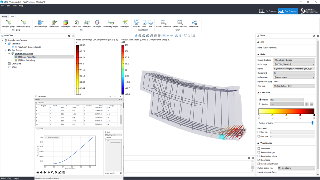

Hello to everyone, I have a question. I made a static analysis of a beam and I want to extrapolate the load-displacement curve. I set the monitor after the analysis steps but I can't see the window of the monitor when I run the analysis. Then, I tried to make the curve in postprocessing evaluating displacement in z in the node of the maximum deflection and reaction force in z at the support (summing the reaction of every node of the bearing's surface), but how can I see the results using the function monitor?

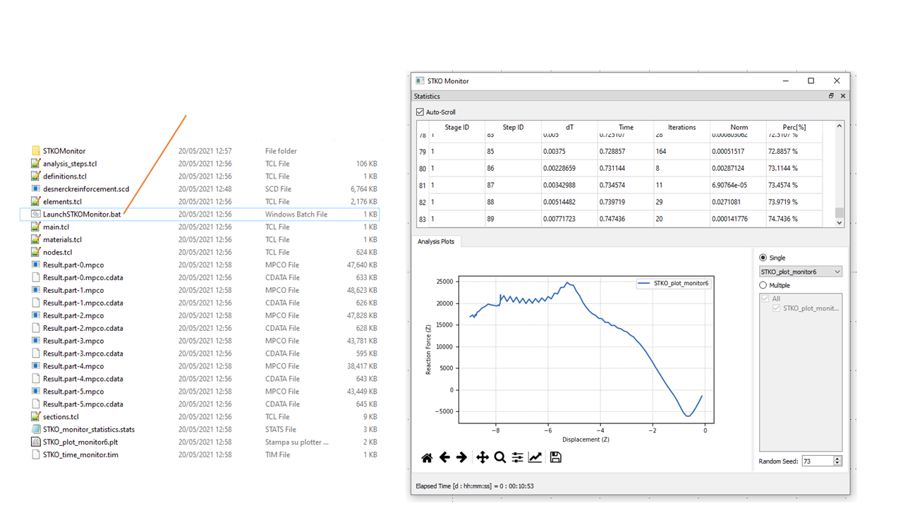

move up the monitor before the analysis. Remember that the analysis that you like to monitor must be after the monitor.
If it still does not work, you can launch the monitor manually. Click on the bat file indicated in the picture attached.

Thanks for the suggestions, I'll try to move up the monitor. About the improvement of the model, I don't know the reason why I can't create a structured mesh. In detail, I tried to cut the volume so I used the merge command at the end but when I choose the structured mesh I can't see any difference, and using a bbarbrick I had incompatibility because I had 8 nodes for the element definition but the mesh still had 4 nodes. Have I made mistakes creating the mesh? Thanks for your help.

I made other changes. I can realize the structured mesh but I have other problems when I try to run the analysis.

I run the attached model. It does not converge, you might have to check it again. The curve seems fine.
