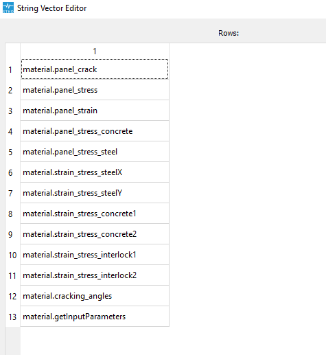

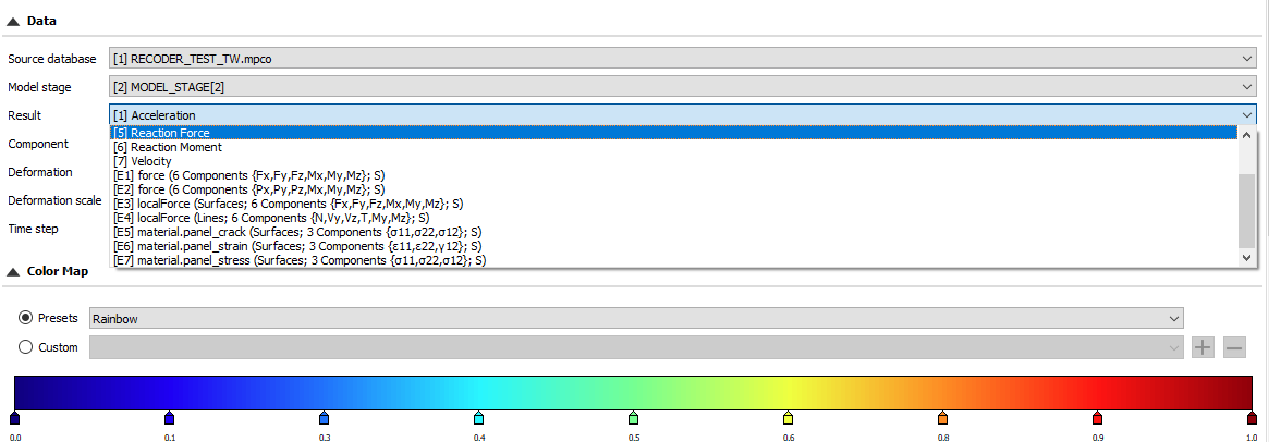

I am trying to extract local stress and strain response for SFI-MVLEM element in the model. Firstly, I recorded in the pre processor as below(1st snip) and I ended up having the second snip in the post processing.
1. Can you please clarify which input relates to which out puts ? I assume the crack relates angle of concrete (E5). Vertical element will not have sigma 12 or epsilon 12. I am also guessing the strain is only one for both steel and concrete as it assumes perfect bonding(E6)? What happened to aggregate interlocking ?
See the names, are the same in STKO and OpenSees

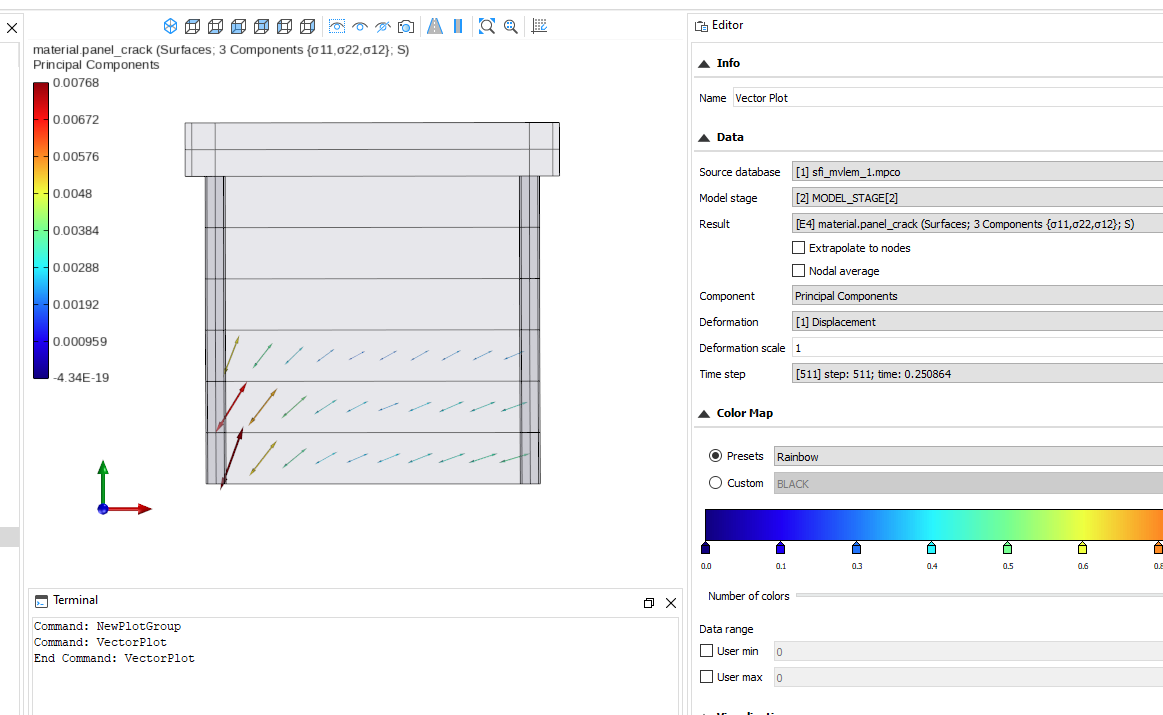

Since this elements uses the FSAM material, that supports up to 2 orthogonal cracks, the panel_crack output is a 2x2 tensor (3 components in voigt notation), whose eigenvalues are the crack-strain orthogonal to the cracks, and its eigenvectors are the crack directions.
panel_crack = c1*outer(v1, v1) + c2*outer(v2,v2).
In this way you can plot it using the vector plot, as you would plot any tensor quantity:

OK Thanks. I found white spaces behind some of the names and it appears to record now(I can see interlock 1 & 2 now).
