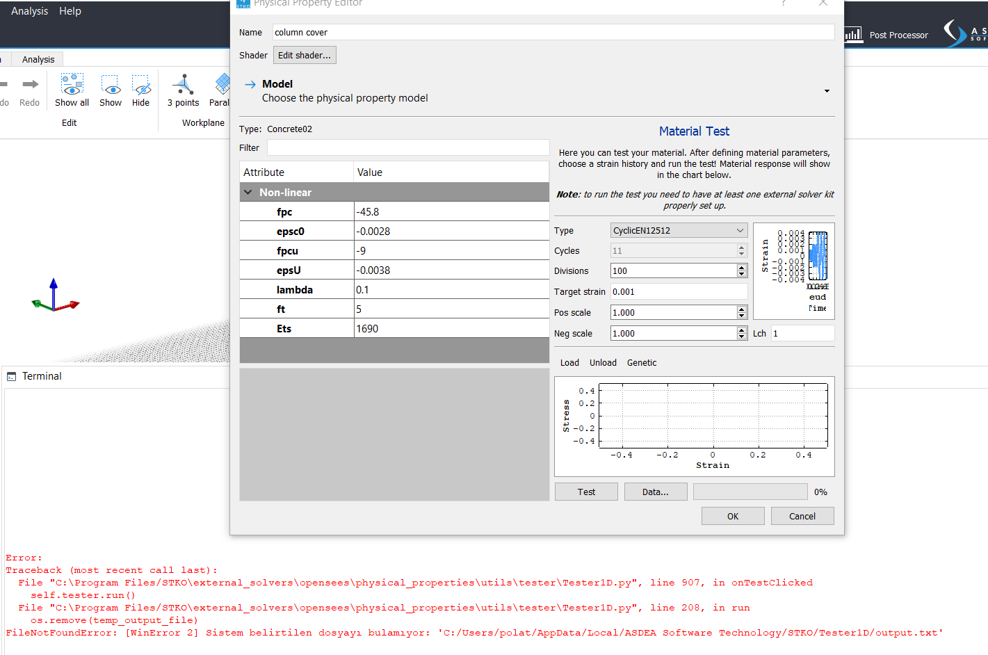

Post by polatd » Thu Oct 10, 2024 10:01 am
Hi sir,
Here is the problem I think:
The system cannot find the specified file: 'C:/Users ......
Materail Test.PNG (80.2 KiB) Viewed 591 times

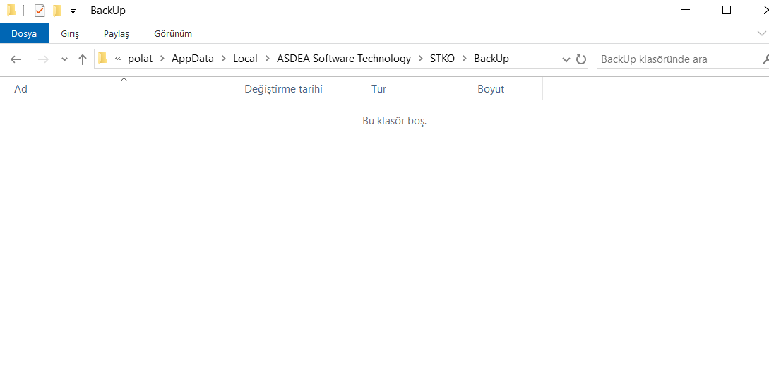

When I go to the >>> AppData/Local/ASDEA Software Technology/STKO
STko folder.PNG (14.56 KiB) Viewed 591 times
I see that all files are empty,

Re: Materials Ver. 4.0.0
Post by STKO Team » Fri Oct 18, 2024 7:49 am
I'm able to do the test with your parameters, so the problem is somewhere else.
Those last red lines of error are not useful (it's simply saying that STKO cannot find the files used for testing, because there was an error before, probably in opensees, and those files could not be generated).
Please scroll up the terminal until you see the OpenSees output, I need the whole Terminal output to understand the issue.
You can simply go into the terminal (after the test) and 1) select all + 2) copy + 3) paste the whole message here
