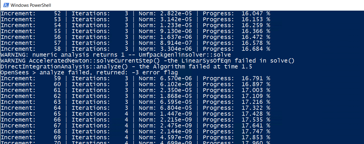

I have been working on a four-story model that was performing well until I added some springs at the base to incorporate soil-structure interaction. I defined zero-length elements with six components of stiffness and damping, using the following properties:
Stiffness:
Kx = 2.38E+08
Ky = 2.46E+08
Kz = 2.80E+08
Kxx = 2.18E+10
Kyy = 5.49E+10
Kzz = 5.52E+10
Damping:
Cx = 9.53E+06
Cy = 9.53E+06
Cz = 2.83E+07
Cxx = 8.44E+08
Cyy = 2.50E+09
Czz = 1.43E+09
To ensure the soil remains elastic, I used a zero-length element and applied Steel01 material with a high yield strength (Fy). However, after making these changes, I encountered convergence issues when running the model, as shown in the attached image:
I tried even to fix the Z direction thing that will solve the issue but even with that the issue persists. Here is my current model. I would appreciate it if you could take a look and provide any insights or suggestions.
Analyze failed , returned:-3 when adding springs.

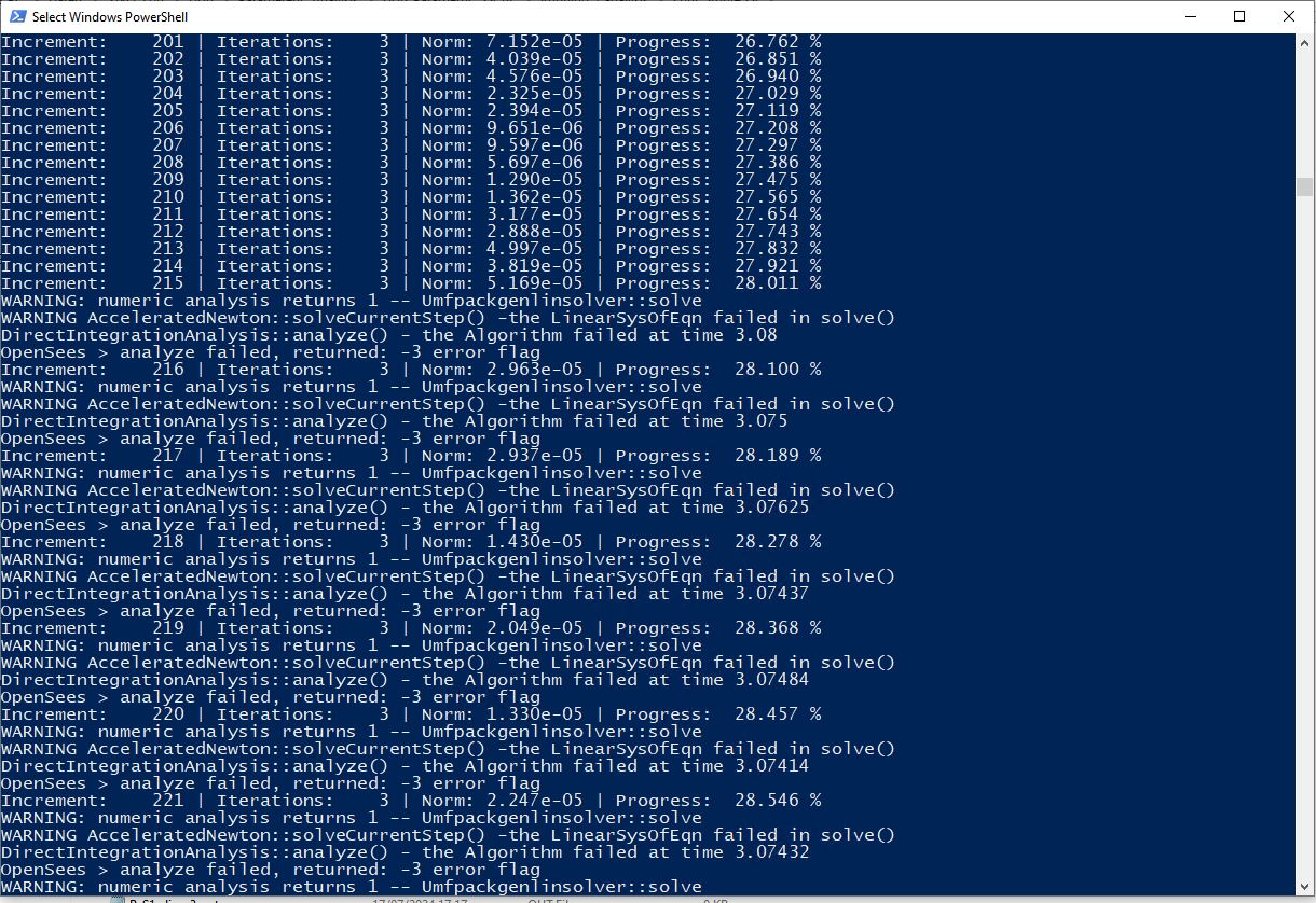

Dear STKO,
Thank you for your supports in my previous posts,
I have updated the opensees solver in my PC and the problem with my gravity analysis is solved , but i still have the issue with THA , i enconter an issue around 28% like the following :
for the sake of clarificaiton i wanted to also show which GMs is running on which processor : here is the model that i am running i just added another GMs ( 8 in total) .
However, what i find weird is that i run the model speratly (by hand) ,so i took the first 3 GMs (Acc_X0,Acc_Y0,Acc_Z0)and then run them speratly (no parallel processing) , and do the same for all (Acc_X1,Acc_Y1Acc_Z1) .......(Acc_X7,Acc_Y7,Acc_Z7) , i have not obeserved any convergence issue . the model i used for this case is the following ,
thank you again for your support , and waiting for your kind response !
