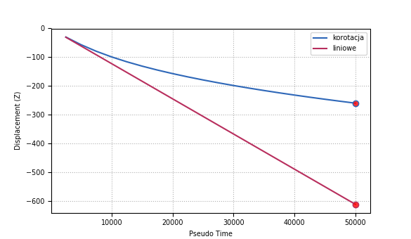

In the middle of the slab I created a control node in which I want to study the deflections depending on the increase of the concentrated force
1. In the first model i created a load control analysis at set the duration as my load factor. In the monitor i choosed pseudo time (it should simulate the increasing force) (the force at the control node is 1kN=1000N (my units are N/mm)
model 1.png (29.22 KiB) Viewed 844 times
2. In model 2, I wanted to apply pushdown analysis using the displacement method. In the monitor i used the same settings. My problem is that I do not know how to interpret the results of what is happening to my model. Displacements are increasing as in elastic analysis.

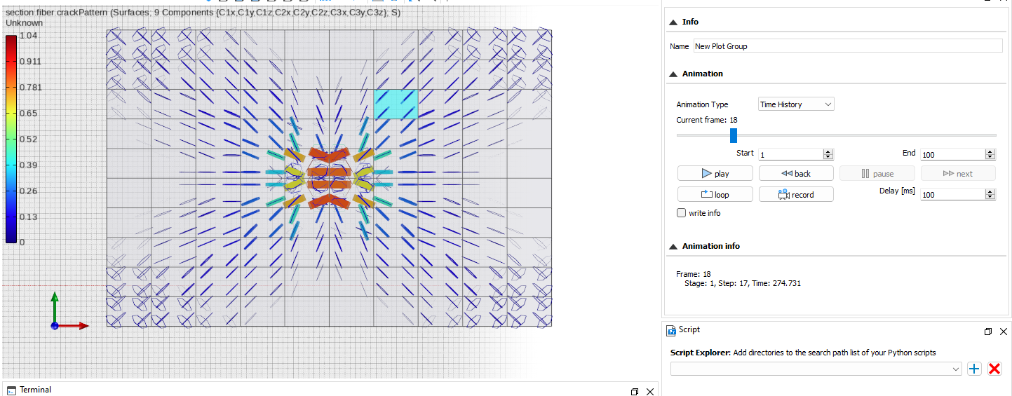

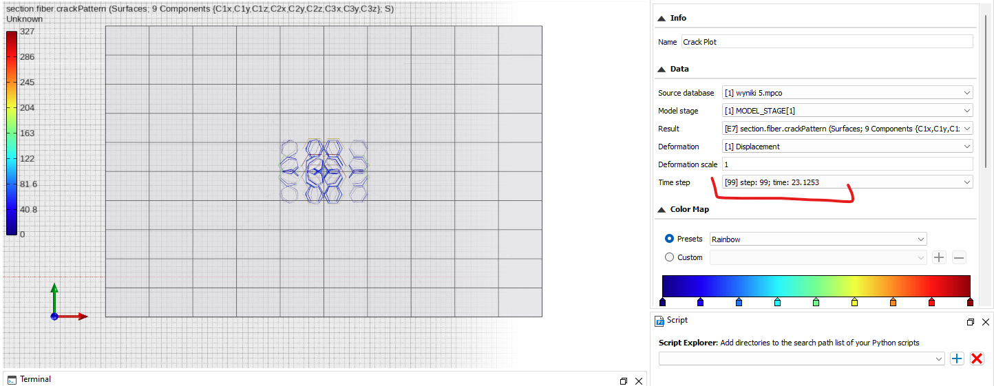

The crack plot shows ad the end cracks only in the middle
, but in the step 17 its looks good. (why ??)

Next i have general questions for Asd 3D concrete model. I am mainly analyzing vertically loaded slabs, is this constitutive model suitable for this or do you recommend another approach? On webinars this model used in loads in the plane of shell elements. I want to make multi-story slab-and-column structures after previous attempts on small models. Won't using the ASD 3D concrete model result in too much computational requirements (costs)?
Probably you cannot interpret it because you have displacement in the Y axis and loadFactor in the X axis. But it seems fine to me. From a displacement of 0 to a displacement of about 15, you have concrete cracking leading to the hardening in the pushdown curve. after that you reach the peak load probably due to onset of concrete crushing, and then you have softening due to progressive concrete crushing
I put the point force in the -Z global direction and in the displacement control setings I put dof=3 and target displacement -80 In the monitor settings Result Y axis are displacement (component Z), X axis PSeudo Time
Ok so it makes sense.
In the Y axis you have the displacement of the control point. It's negative as you imposed.
In the X axis you have the load multiplier. It's positive because your reference load is already negative.
