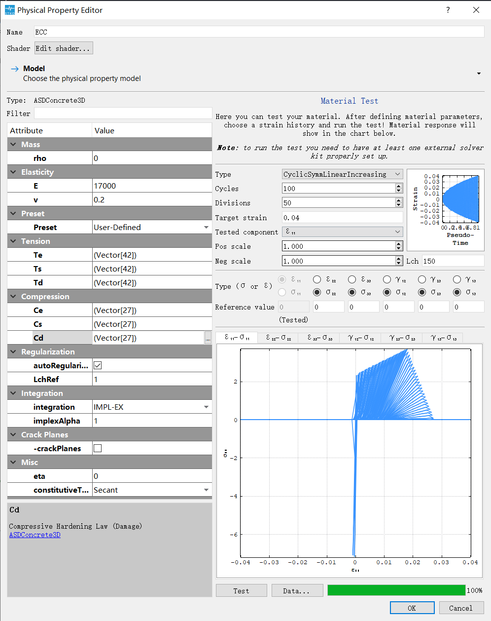

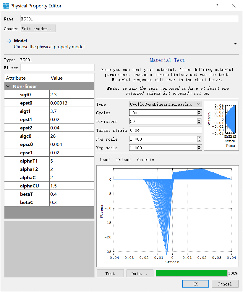

There is an uniaxial material named ECC01 in STKO, and I got the cyclic performance of ECC in the materials test interface as shown in picture by entering the relevant parameters. I verified the correctness of this constitution with a simple uniaxial model.

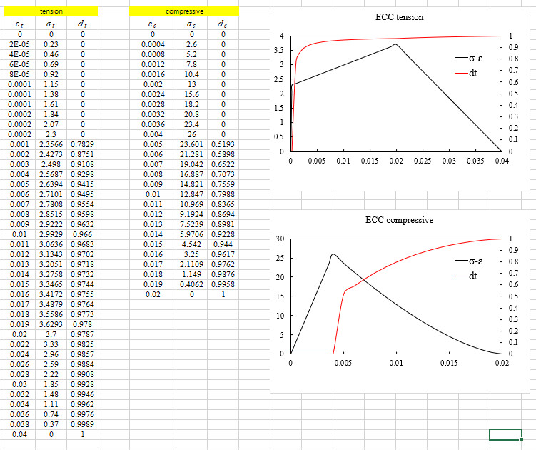

But I ran into some issues when I tried to use the ASDConcrete3D solid element constitutive to simulate ECC. When I enter the following stress, strain, and damage parameters, the materials test interface shows an incomprehensible cyclic curve.
I've tried reducing the damage value or even ignoring the damage at all, but it doesn't seem to work, and the hysteresis curve is still weird.
could you please Point out my mistakes and if possible help me debug a hysteresis effect like ECC01. Thanks a lot!

You are on the right path, but there are some mistakes that the ASDConcrete3D tries to fix during runtime, that's why you don't see the expected results.
Make sure that at least the second_point - first_point (sigma-epsilon) of your curve gives the Young's modulus.
(sigma(1) - sigma(0)) / (eps(1) - eps(0)) = E
Try with few points and see what happens. In this stage don't care about plastic deformations. Set all damage variables to 1. Once you fix the backbone curves we will tell you how to properly compute the damage variables

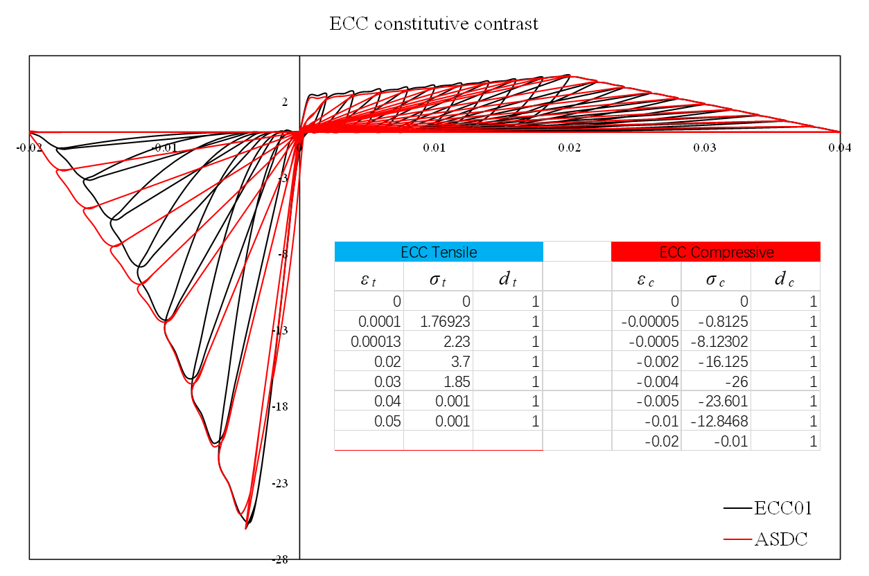

Thank you for the reply,I've adjusted the hysteresis curve to look like the one shown below as you requested.
As you can see,the backbone curves have been fitted,but the unloading path of the hysteresis curve is a straight line through the origin with no residual deformation.
How do I think about the plastic deformation of ECC materials next?
Looking forward to your reply.

Post by STKO Team » Mon Aug 26, 2024 2:53 pm
Actually, as a starting point, this is good enough. Even if you cannot capture the plastic deformation, it's not a big issue (from a global point of view) because in this kind of material, permanent deformation are temporary: they are recovered upon load reversal:

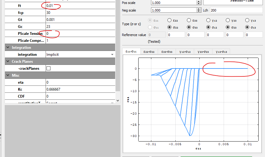

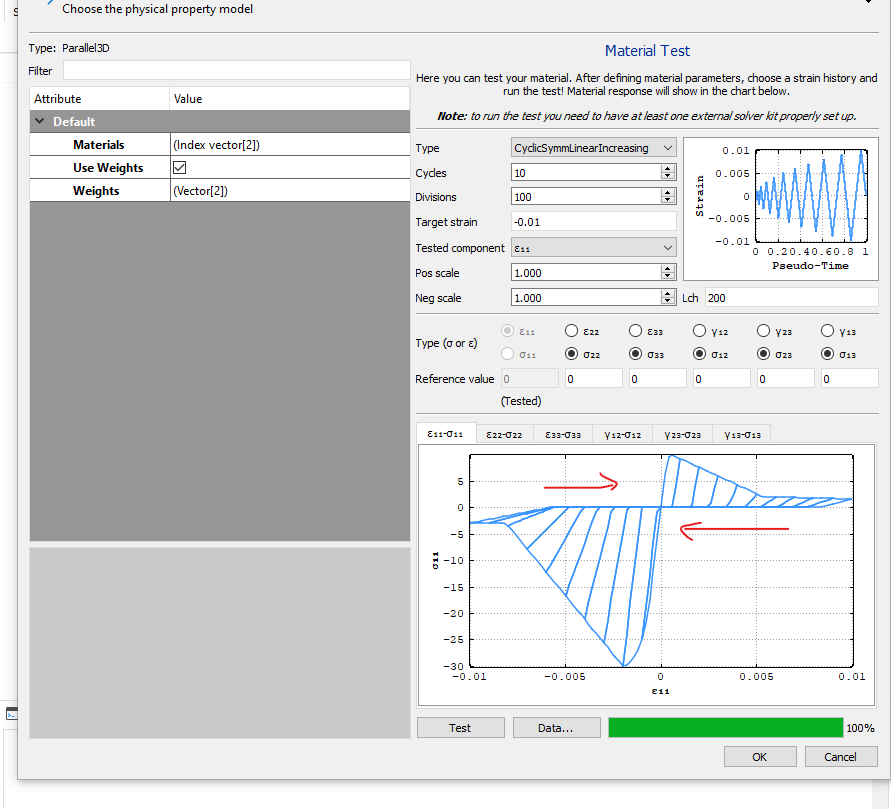

Currently, you cannot model this recovery of plastic deformation using a single 3D material. But you can do it by combining more materials:

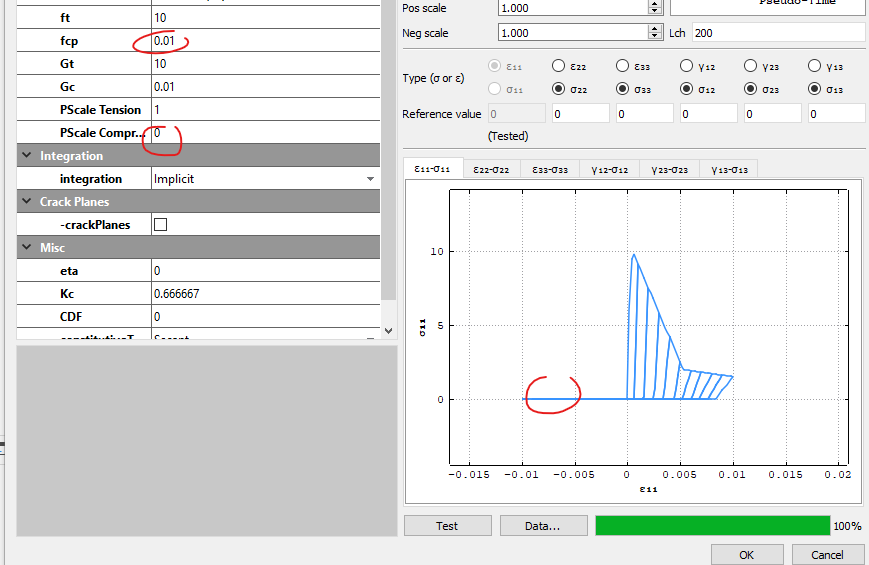

  • You can define a material for the compressive response with plastic deformation and strength only for the compressive part (and no strength and pure damage in tension):
  • Similarly for the tensile part only:
  • Then you can combine them using the Parallel3D wrapper:
    parallel 3d.png (62.2 KiB) Viewed 770 times
Note: We recently added this new material wrapper (Parallel3D) to OpenSees repo. It will be available with the next version of STKO and OpenSees. Stay tuned, it will be released soon
